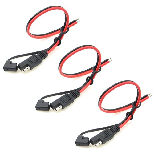

I've migrated to adding 2-Prong pigtails to each of my batteries, the Harley's being the first. Motorcycle engineers seem to totally overlook battery accessibility.
I connect them with the pigtail sticking out in a discrete, but accessible, place so I can easily plug my battery maintainers or charges in quickly, with much effort at all. I do have a couple of battery chargers on hand, but rely on battery maintainers to keep everything all nice and cozy - and ready for use at anytime.

Good responses everybody, thanks. I decided what to do. I bought a battery tender made by Mroinge that does a 4 step maintenance program that does not overcharge the battery. I also bought two 2-foot extensions that will connect to batteries by ring terminals, and the remote quick connect end will terminate in some discreet location. I will switch between ZTR and Polaris Ranger. That should keep them active. I prefer this method rather than pickle them and just let them sit all winter—I prefer to exercise them.
