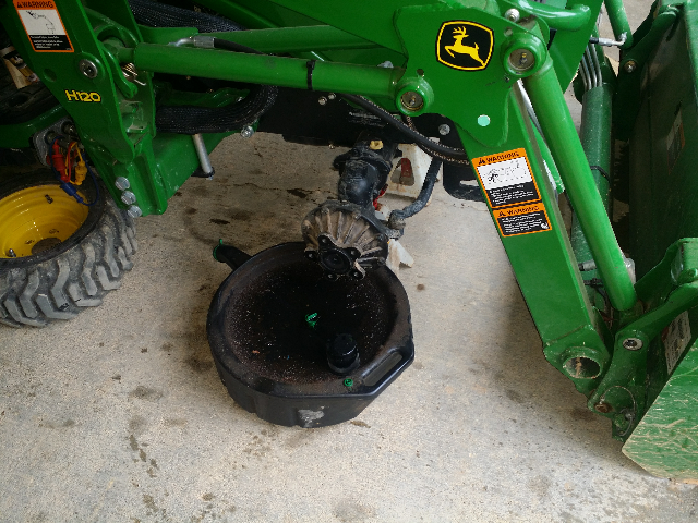

I put 50 hours on in 4 weeks, and now it is time for a service. The book only calls for changing the rear hydraulic fluid and filter at 50 hour, but I am changing everything. I want all of the metal shavings out, plus this machine is small, so it did not cost me a fortune to replace the fluids. I changed the engine oil with Rotella T 15W40 and used a Mobile 1 filter. I changed the front axle oil with Valvoline 80W90. A lot of metal came out of the front axle.
I changed the hydraulic fluid out with TSC Universal Tractor Trans/Hydraulic fluid using the JD hydraulic filter. Greased all of the grease points. Even those little pain in the but ones on the mid mount mower quick attachment drive shaft.

A couple of questions for you. Why did you use 80/90 gear oil in front axle? The book calls for HyGard in front axle. Second, I would be a little concerned about the use of TSC hydraulic oil. I know it states that it meets specs for "some" John Deere models, but doesn't say which models. I am betting if you could get actual specs for the oil, it would say it meets JD 303 specs. That is a 30 year old classification for JD oil. The new species J20C or J20D. John Deere compacts all come shipped from factory with Low viscosity HyGard, it meets J20D specs. You may never have an issue with the TSC oil, but while in warranty, it is important to use the proper oil. It doesn't need to be JD oil, but I am skeptical that the TSC oil actually meets the proper spec.

You are right about the front axle. I wrote this while letting the oil drain out of the front axle. It was the last thing I did. I just assumed it was like my other 4x4 tractor and bought 80W90 oil. After reading the clear as mud manual, I noticed it said use HYGARD for the front axle. TSC Premium Universal Tractor Trans/Hydraulic fluid meets JD20C specs stated on the side. It is different than their 303 stuff. It is a multi viscosity 10W30 oil. My John Deere dealer says it meets their specs. I don't need JD20D here. We don't get that cold. I have used TSC oil in all of my tractors and it has never gave me any problems. I even use it in my log splitter.
