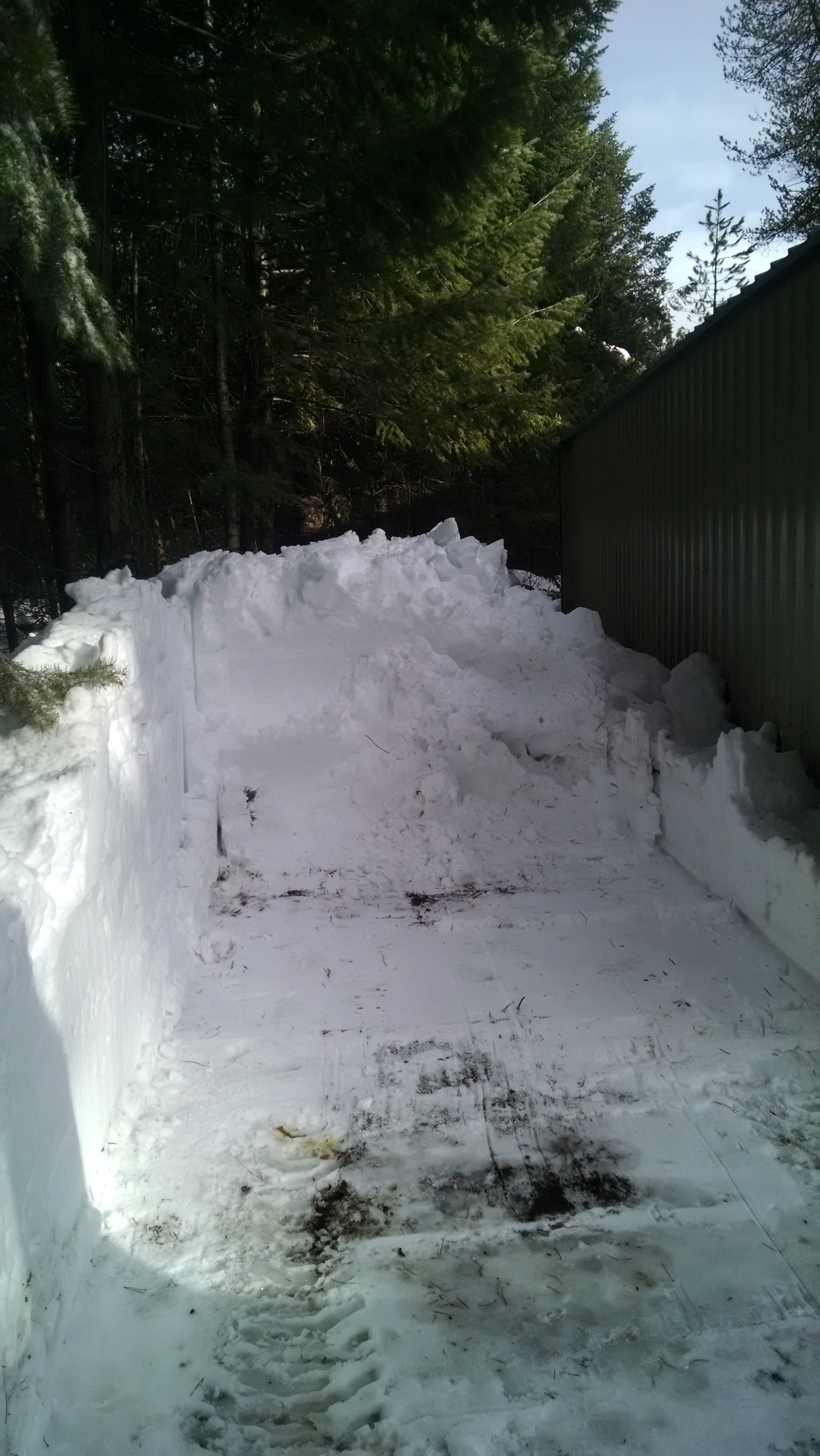

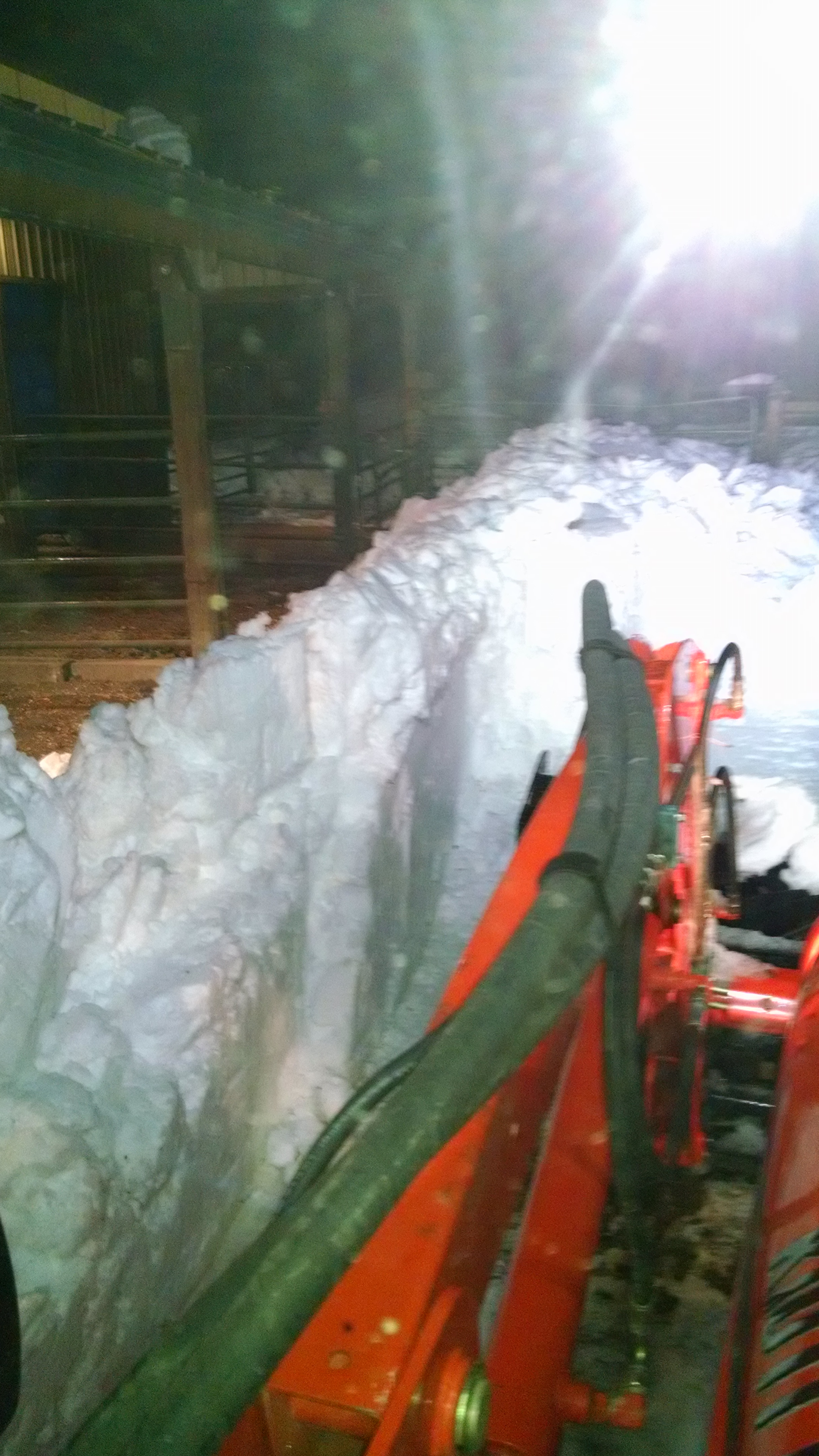

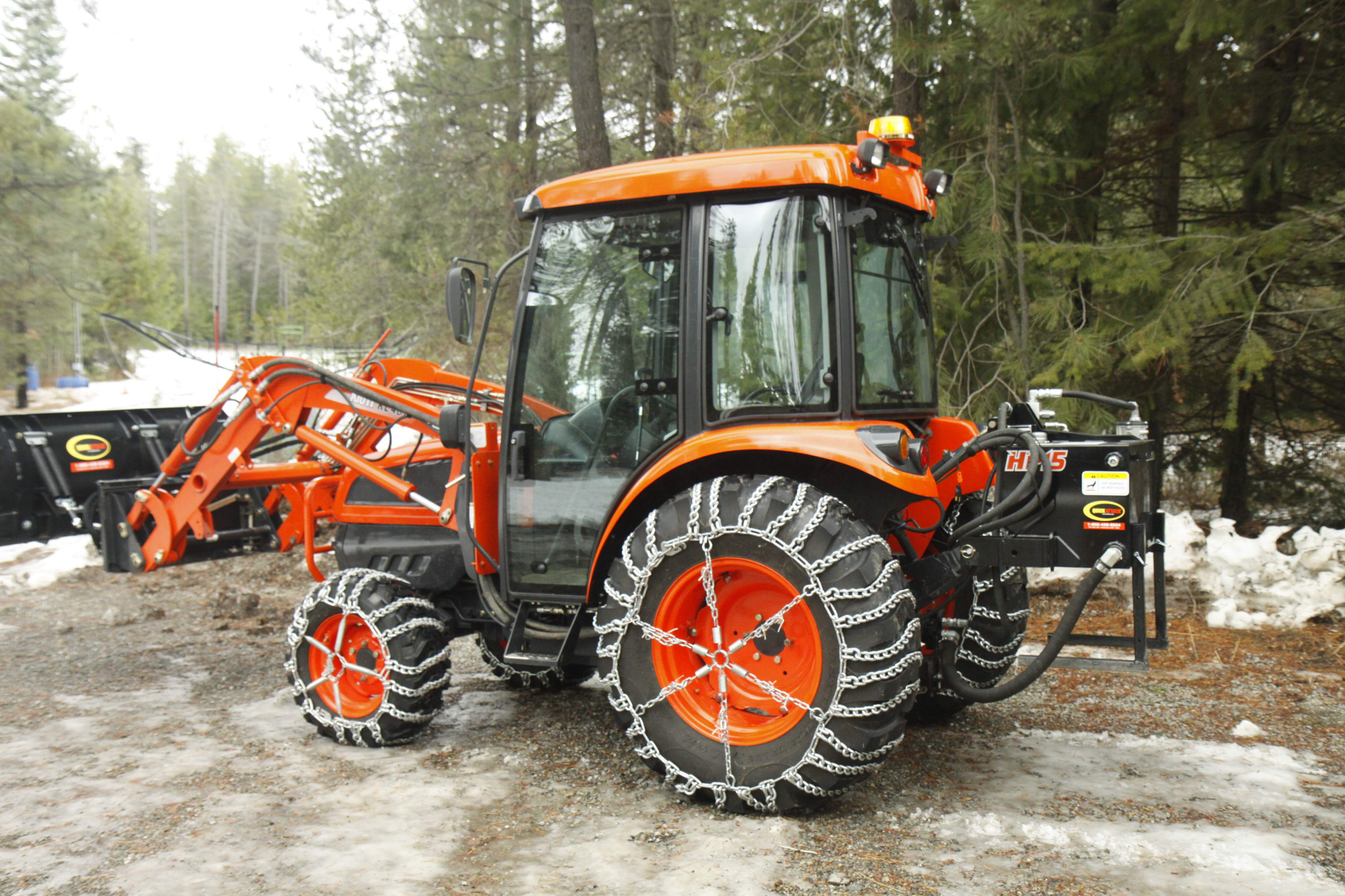

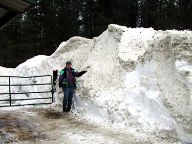

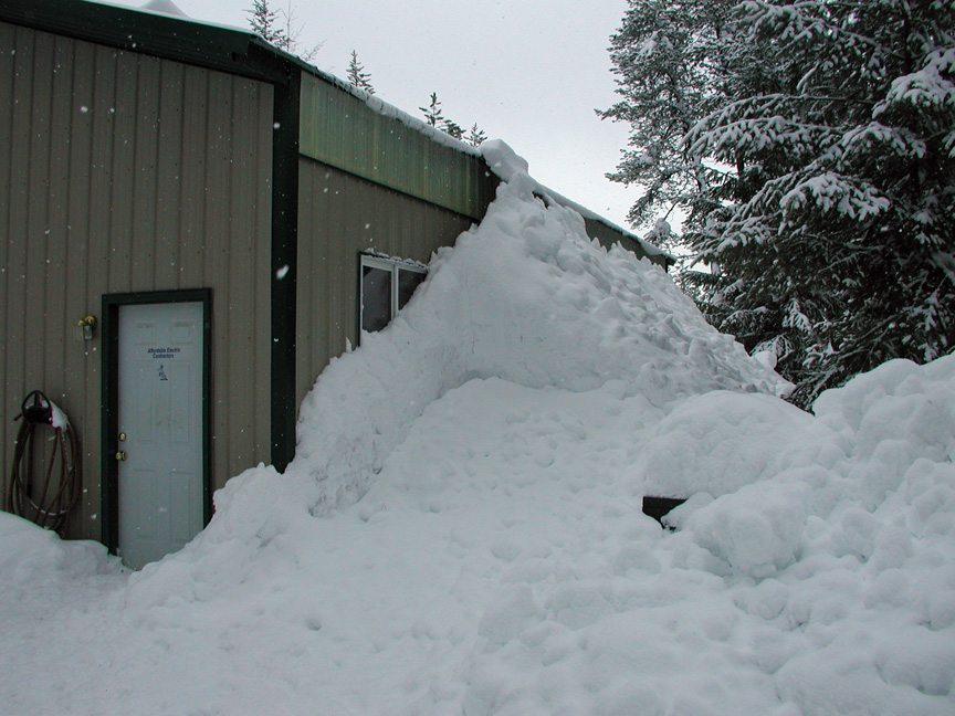

I used to have a jd870 geared tractor and spent 10+ years turned backwards while operating snowblower. Mine was a rear facing blower. I know nowdays that have forward facing blowers so you can drive over the snow forward while blowing snow. That wont work on my typical snowfalls though, much less when shedded snow from barn blocks horses.
I used to do my high drifts the same way. But i always stayed seated while operating while cranking my body to look backwards. I seemed to never have the gearing i needed to blow snow.
I now have an hst tractor, way superior for snow blowing. You still need to keep feet on hst petal though, so you'd still be looking backwards.
Me, i purchased a loader mount hydraulic blower as my neck and back were taking a toll from the snow blowing.
The benefit of my blower…i can lift it up 10’ to clear snow berms.
