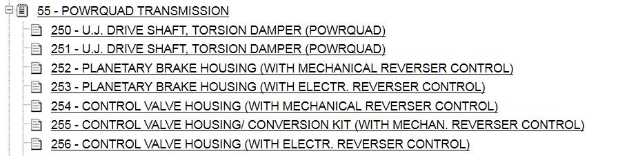

JD parts shows both mechanical & electrical controlled reverser for a 6200
