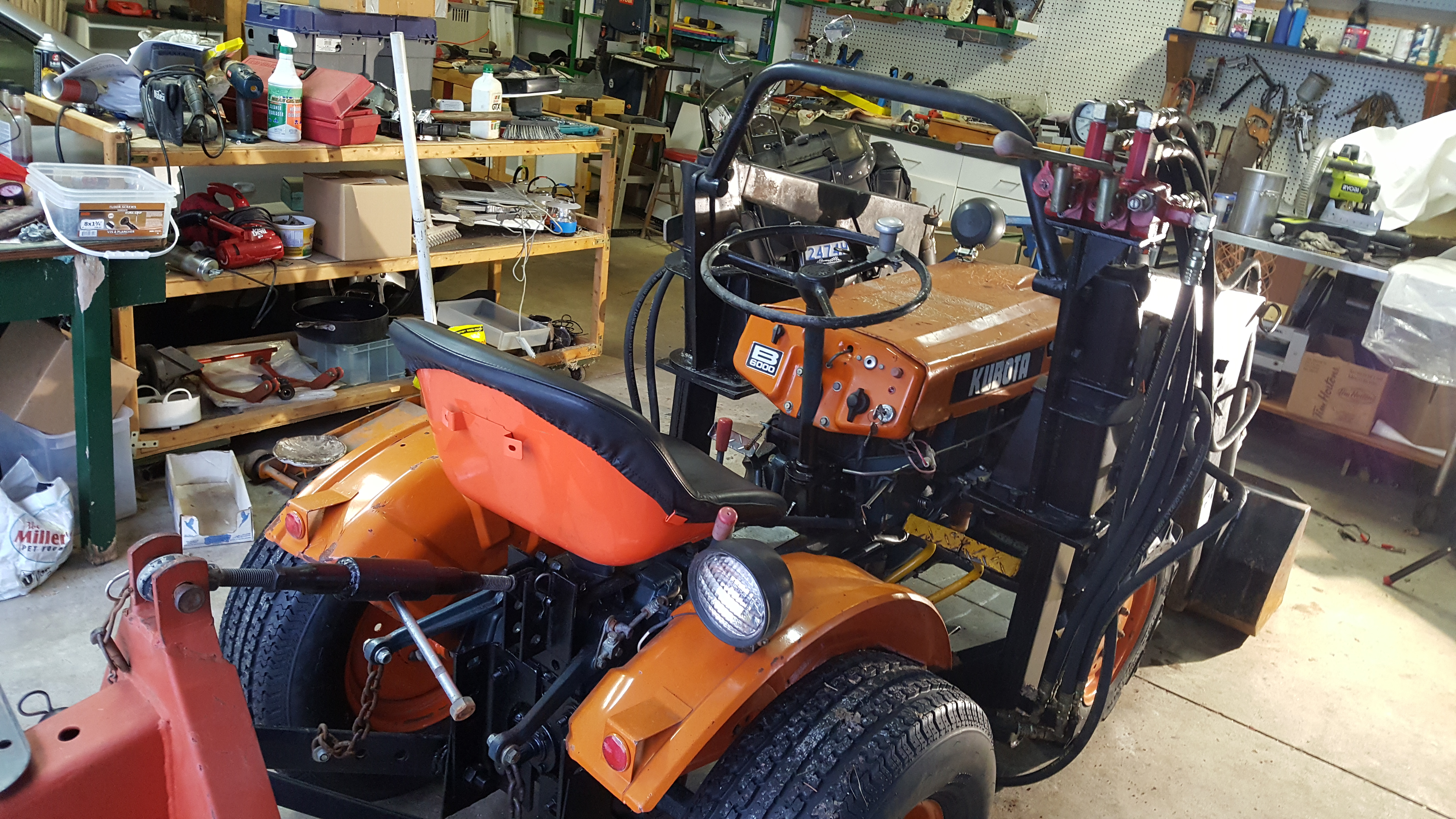

hi there!
im fairly new to the forum! i have a new kabota gr2110 with a blower and mowerfor it.
i also have a B6000 with a rear scraper blade and a bucket up front.

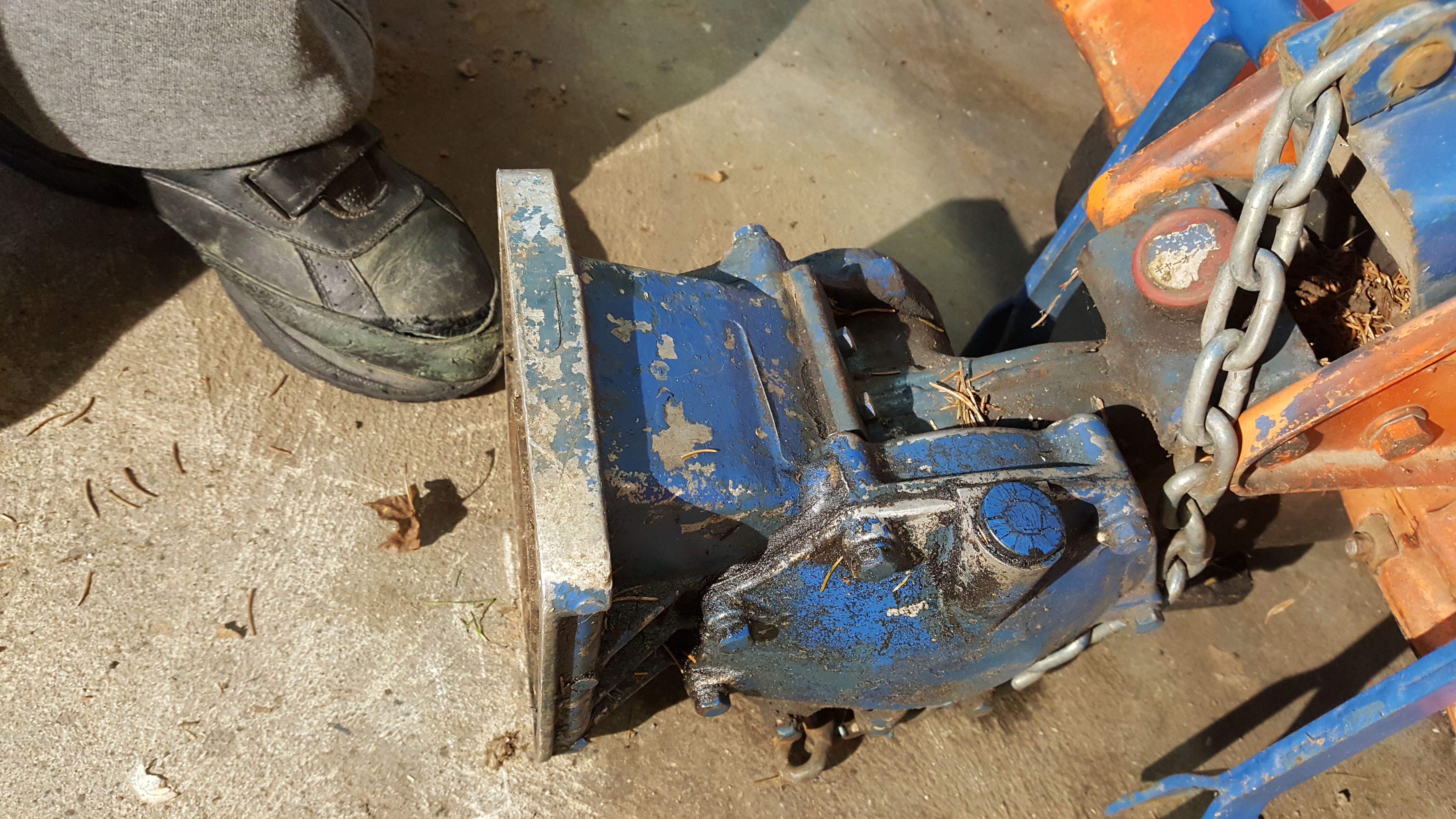

it came with a tiller as well but i havent done any thing with it yet, is that a reverser on it or not?

A couple of thoughts as I don't recognize what you have photographed.
On the B6000 check the direction of rotation of the pto. Compare it to the pto rotation of your newer tractor.
I think you will find the B6000 pto turns in the opposite direction to the newer machine.
If it does then the tiller is designed to only work on early and grey market machines and will not work on your newer machine.
I imagine a reverser would be apart from the tiller itself so you could move it between machines. At least that is how they are packaged with heavy duty snow blowers.

the pic.is a blow up of the box at the end of the tiller that is showen in the other pic. the tiller came with the b6000 tractor and from the same owner!
thanks jim
