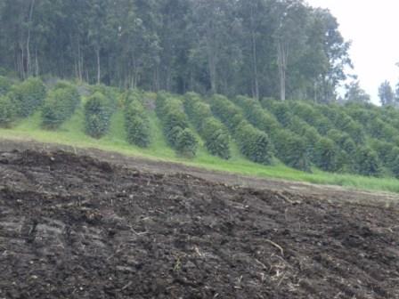

Kona is indeed a beautiful place. Once we get all the new coffee planted and the company on auto pilot, I'd love to spend many relaxing, sunny days mowing up the rows overlooking the blue Pacific. That is if the surfs not up!
