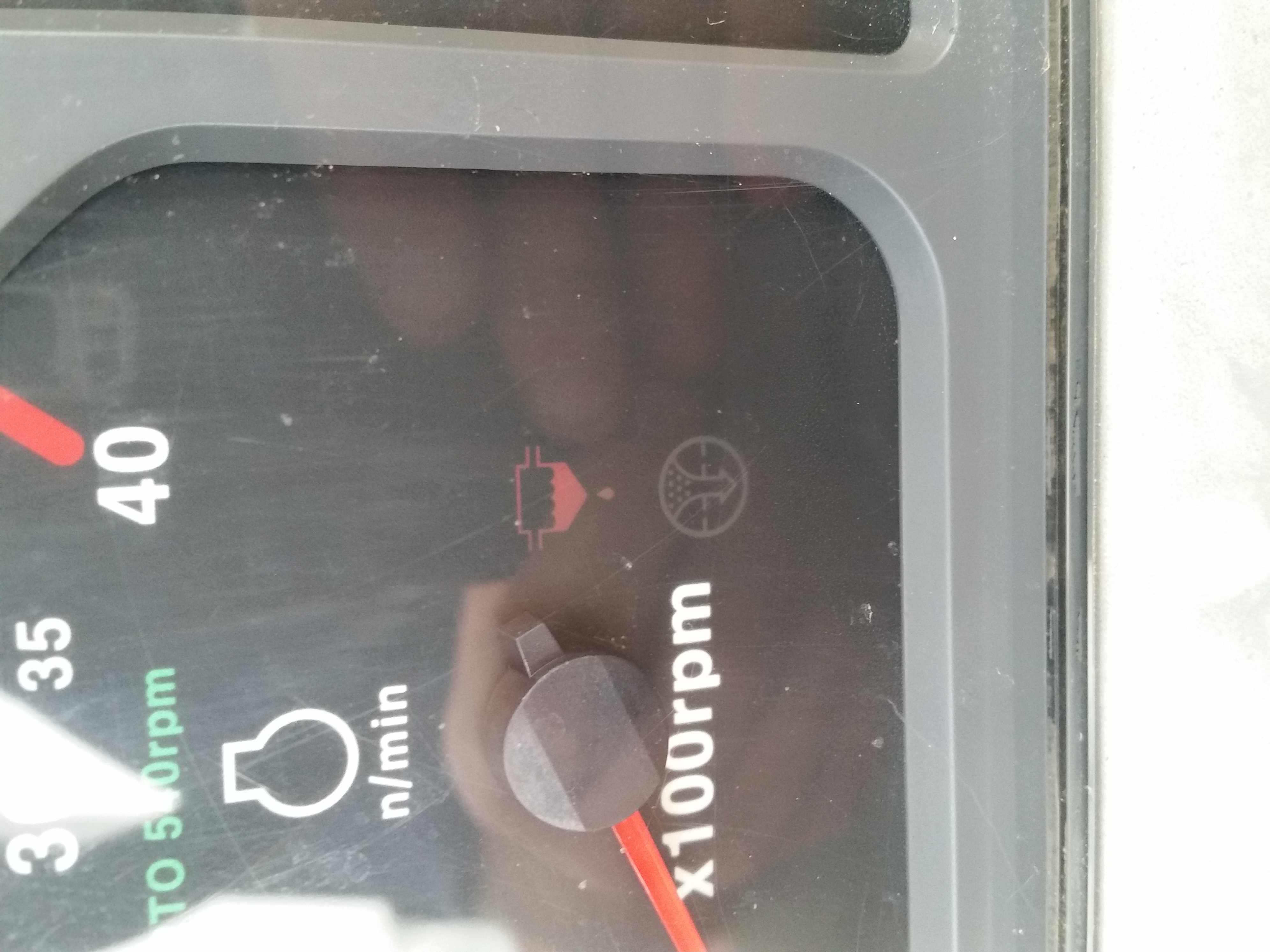

I took off that cover which appears to be protecting the drive shaft to the front 4wd axle. That little hole which is coming from (I think) the transmission seems to be the source of the leak. There are no threads. Is there suppose to be a cap or pressure blow something or other???
Also, after checking the fuses I found a number 5 (water in fuel) fuse blown. I replaced it, and it still won't start.
I then noticed this light on on dash. Anyone know what it means? I have no manual with me and Google is no help.

That light you have lit up is the water in fuel warning light [ a picture of a filter with a drop of water underneath it ] [ the one below that which is not lit is your service the air cleaner warning ]... Does your dash light up a R when you press on the reverse HST pedal....?? You could have pulled a wire off the pedal underneath the floor board. If you 2555 HST is like mine, you have a computer controller located under the drivers side dash that runs the transmission, with the pedals only telling the computer to move...

JerryK, When I turn the key to on, the F is constant lit when not pushing pedal. When I push reverse pedal, F goes off, but no R. I think you are on to something with wires under steering wheel. I've always had "a" wire hanging under there since day one, but now I see 3, but they don't connect to each other. I can't seem to see under there good enough to see where each, if any plug. I'll attach pics if u can distinguish which wire should be there and which should be plugged in.
