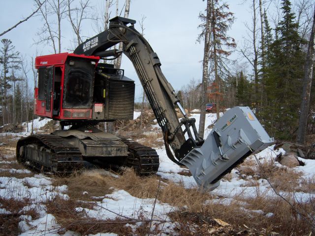

Hello IronHorse,
Attached are pictures of a standard-rotation DAH-150E on a Valmet 425 EXL (boom on the left). That's a mirror of what you'd be looking at.
As far as videos, our DAH-150 video is a bit old, so I haven't put it on YouTube. But someone else did. See here.
FD
