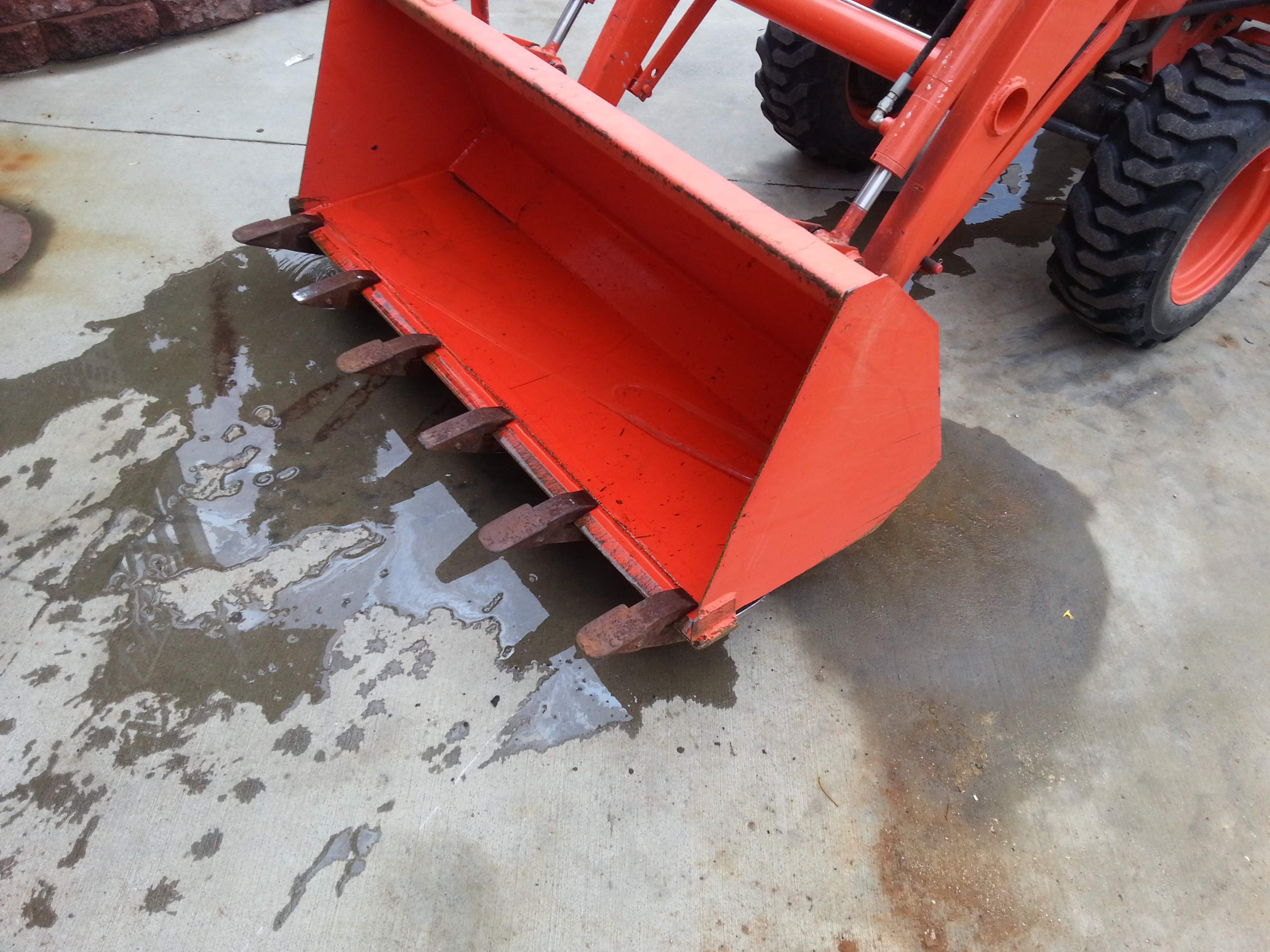

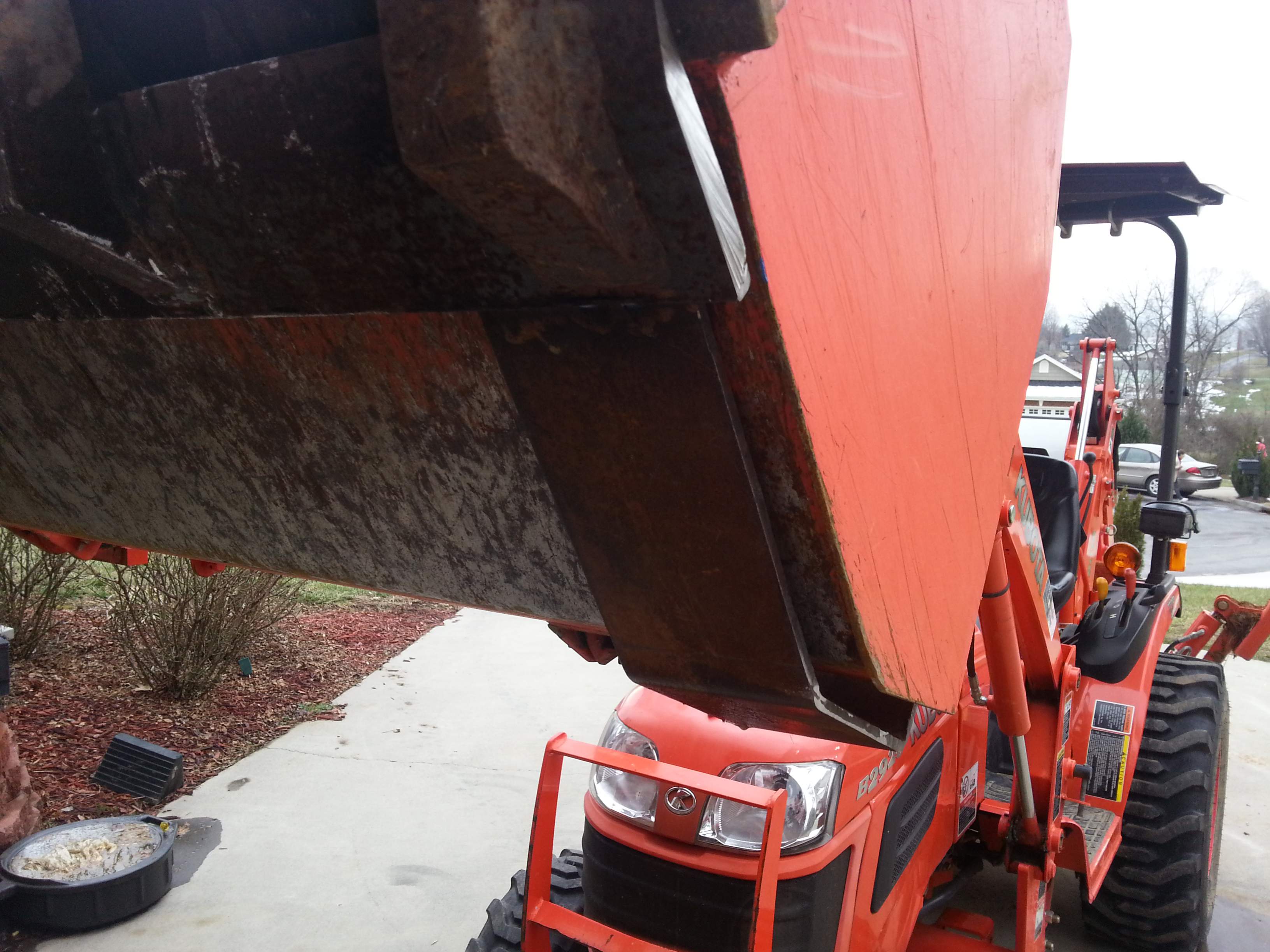

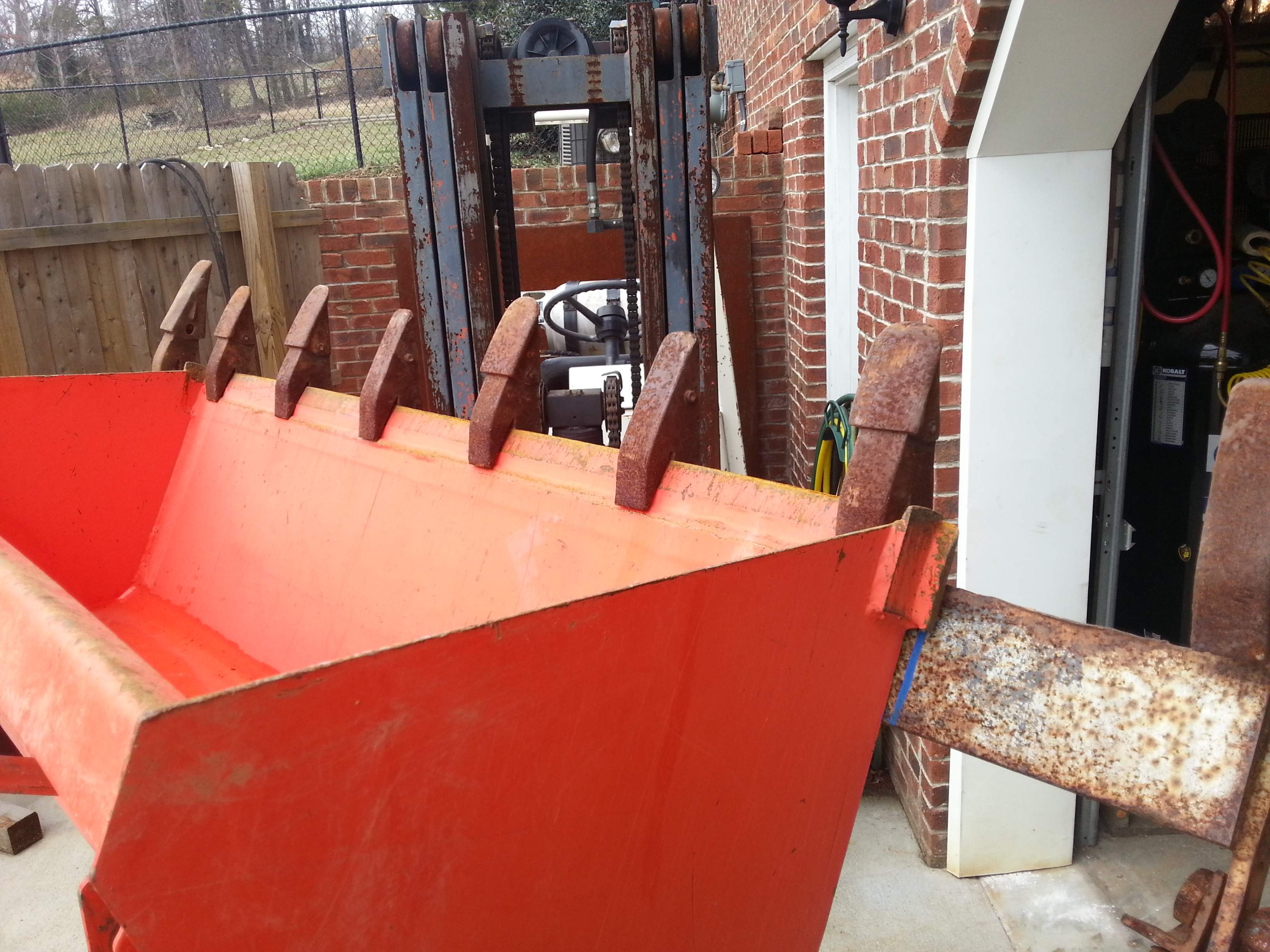

2+ Years ago I picked up a toothbar at an auction for $100. It was made for a 60"+ wide bucket. I decided to make it fit the Kubota.
First step was cutting it down and then develop a method to attach it.
Marking It
![20130127_151501[1].jpg 20130127_151501[1].jpg](https://www.tractorbynet.com/forums/data/attachments/286/286039-d765a4ff86d53e29c736c1264632dd40.jpg)

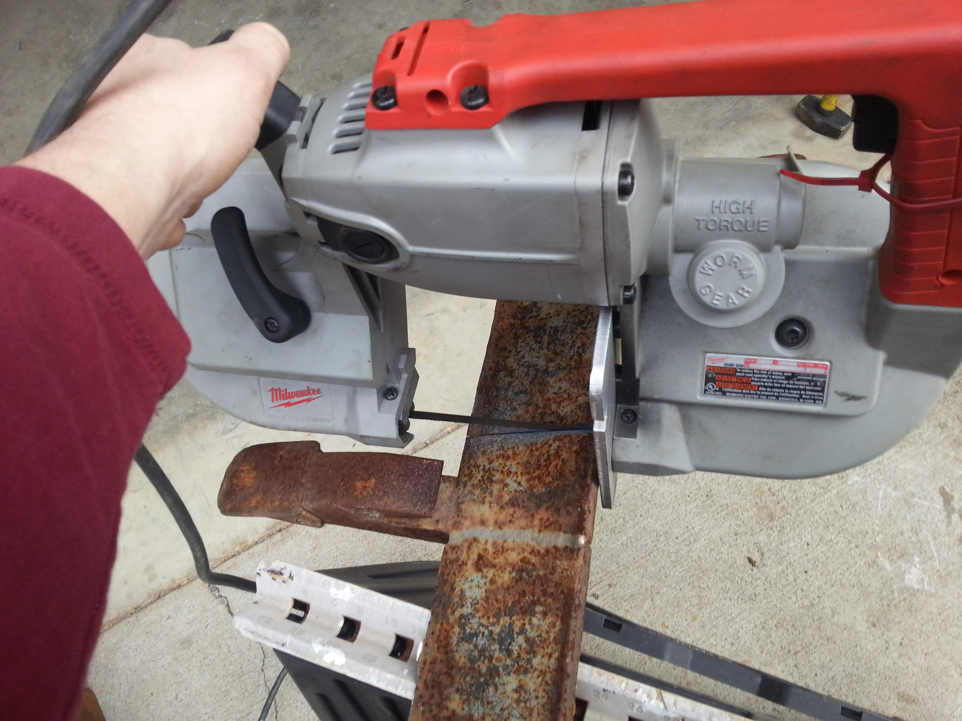

Cutting with Portaband
![20130127_153119[1].jpg 20130127_153119[1].jpg](https://www.tractorbynet.com/forums/data/attachments/286/286031-58f54fd455e272777a303427ab9f2fa9.jpg)
Then I needed to develop a way to secure the bar to the bucket. Some 4" plate I had laying around so I figured contour to the bucket and then use some binders on the back side to cinch the bar down. (Binders aren't installed yet, had to stop for the night).
4" Plate before and after.
![20130127_151535[1].jpg 20130127_151535[1].jpg](https://www.tractorbynet.com/forums/data/attachments/286/286018-077833b244f345d4dcbcd73b30af4635.jpg)
Bending it in my Swag/HF brake.
![20130127_152242[1].jpg 20130127_152242[1].jpg](https://www.tractorbynet.com/forums/data/attachments/286/286009-4236f60fb15d190a68da75f4d2d1783d.jpg)
Welded up.
![20130127_161312[1].jpg 20130127_161312[1].jpg](https://www.tractorbynet.com/forums/data/attachments/286/286042-c8cc1870e5482820caf6db89c3d46bcb.jpg)
Test fit. Comes on and off easy.
![20130127_161350[1].jpg 20130127_161350[1].jpg](https://www.tractorbynet.com/forums/data/attachments/286/286049-870f417e41d857dfb8c24f54cef0779b.jpg)
Strap contoured to bucket.
![20130127_161416[1].jpg 20130127_161416[1].jpg](https://www.tractorbynet.com/forums/data/attachments/286/286058-9e9b1d8129cb278a3ee019f3a341e8ae.jpg)
Backside where I will attach a binder to strap and then weld an attachment point on the bucket.
![20130127_161354[1].jpg 20130127_161354[1].jpg](https://www.tractorbynet.com/forums/data/attachments/286/286063-5733b1409840a37ac629388aac4db03e.jpg)
About 2 hours of work start to finish including setup/cleanup. I'm looking forward to digging some holes this spring.
I'll update this as I add the binders this week.

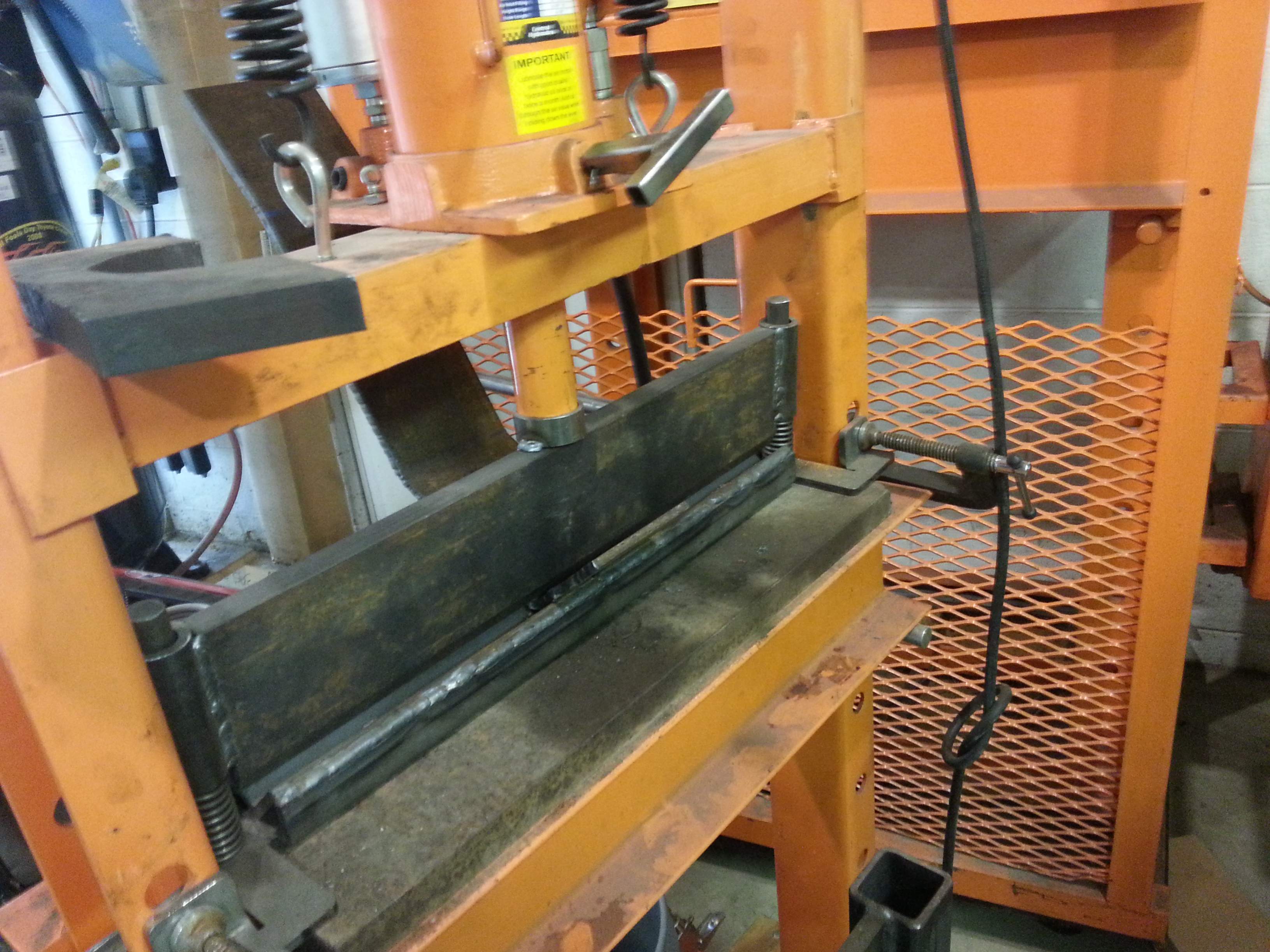

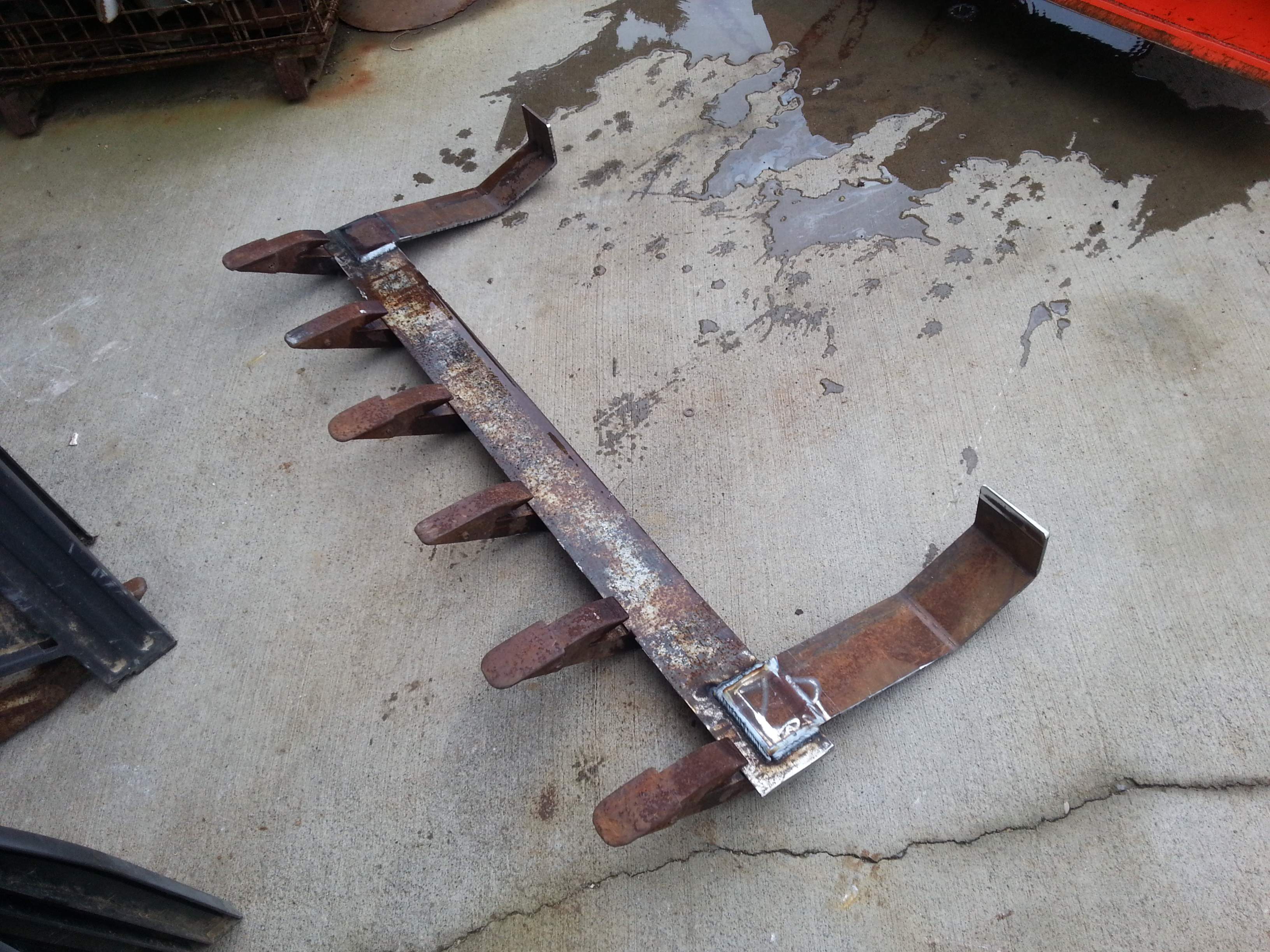

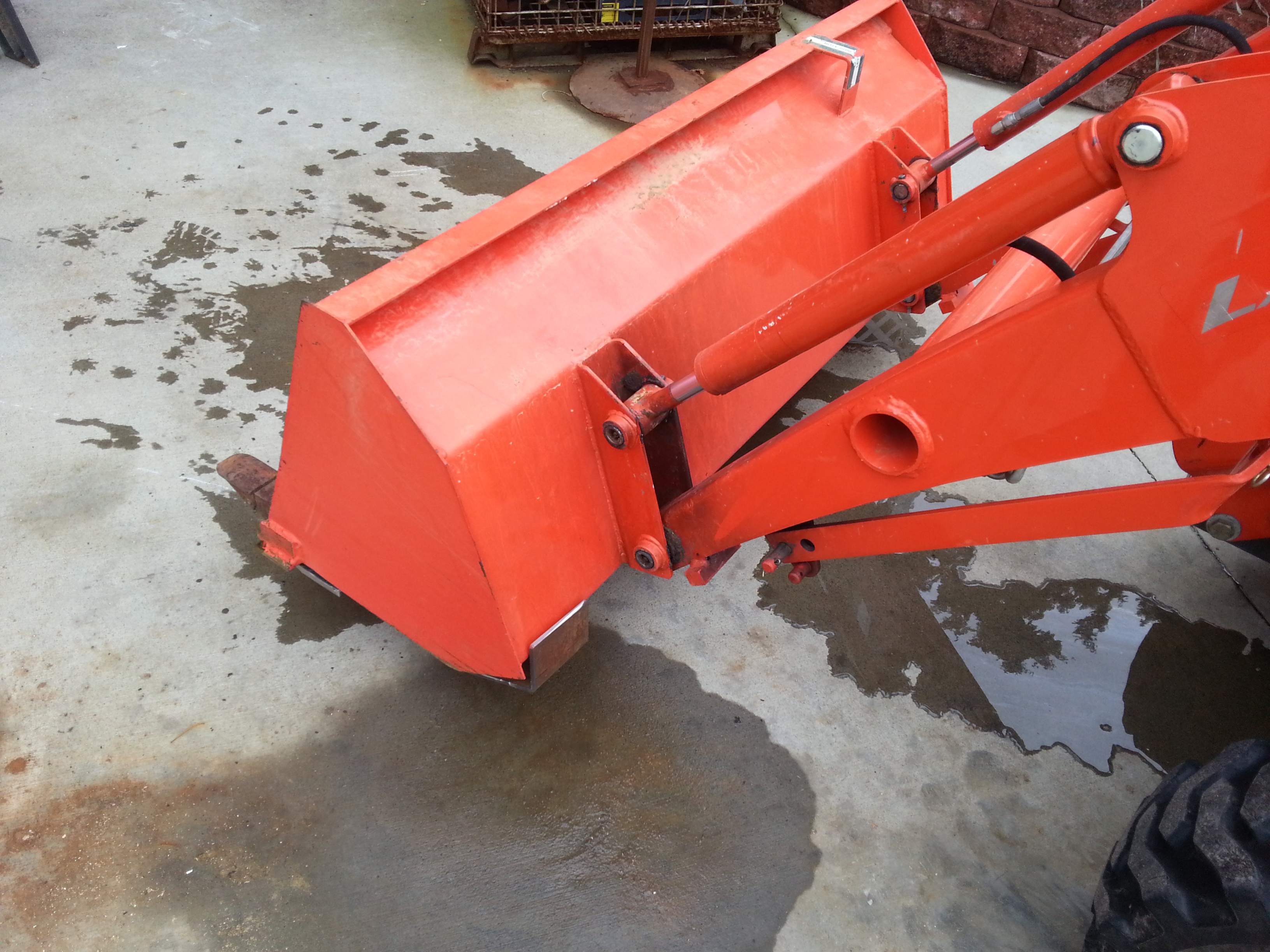

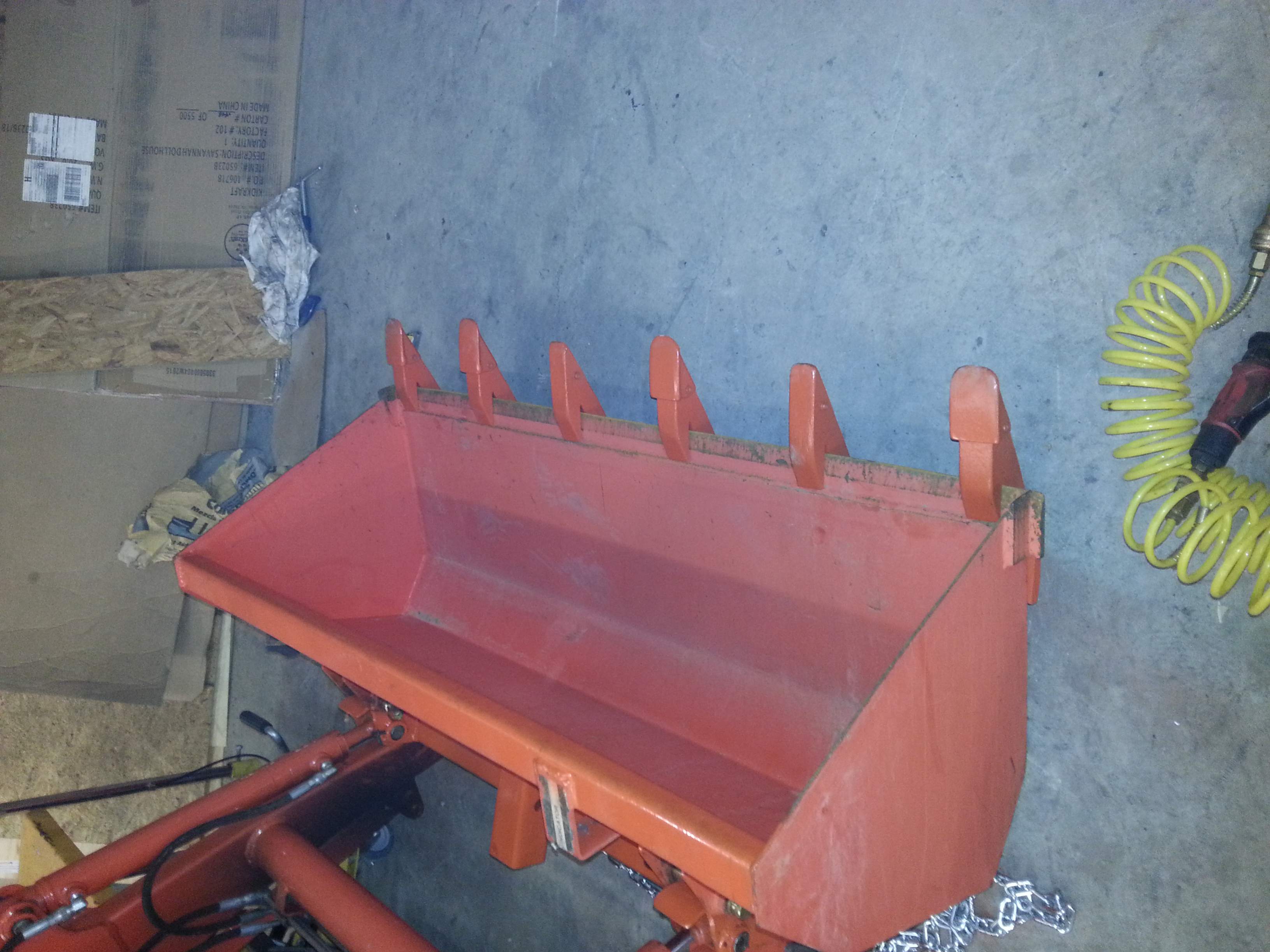

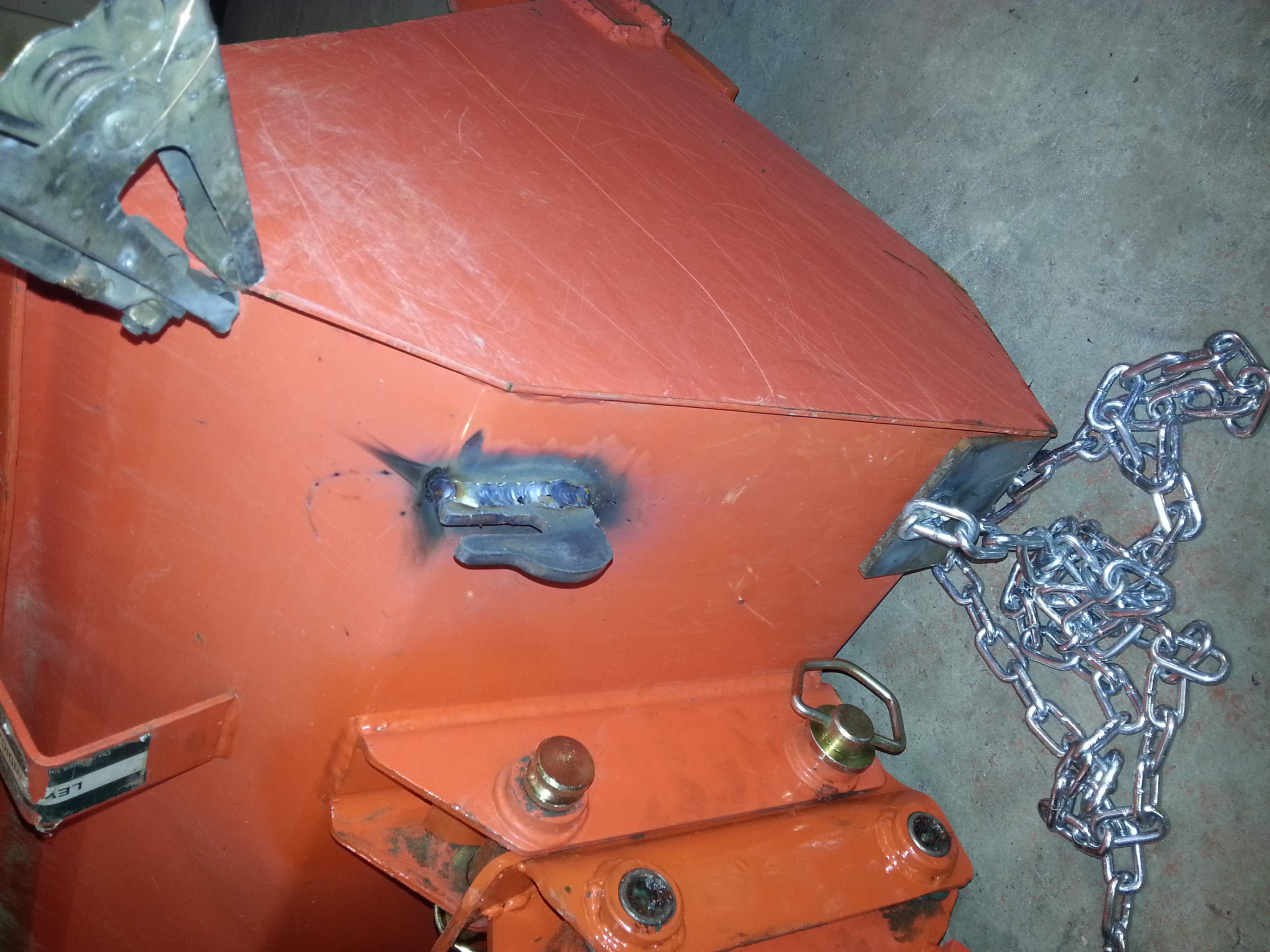

Welded up.
