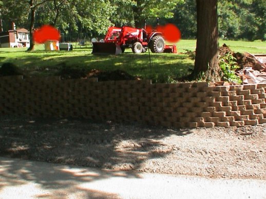

Well, got my retaining wall up and starting to level yard.
I used my new Mahindra 3510 to dig back the edge of the yard, then to both fill the back with 2B gravel and the base and front with 2A modified.
It is much smaller than the big backhoe, so it takes longer, but man- you can get within about an inch or so of exactly where you want to put the material or dig. /forums/images/graemlins/cool.gif
Just thought I'd share. This took a full day, then about an hour the next, after getting more blocks.
-JC

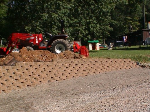

Here is another picture.
-JC

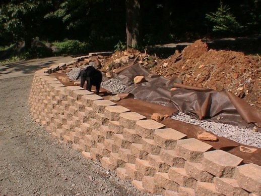

And one more...
-JC
