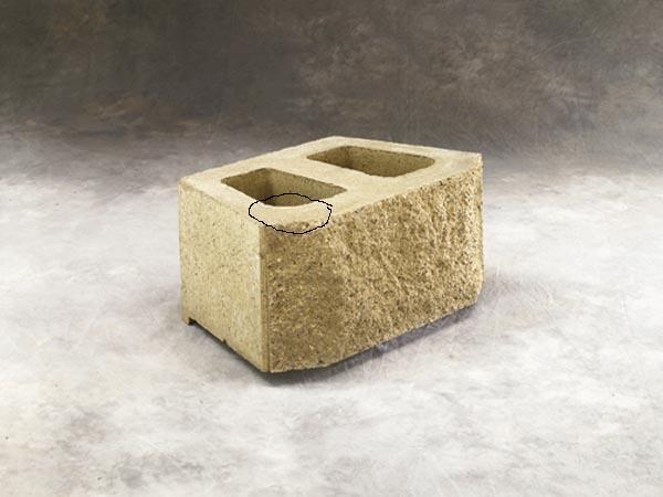

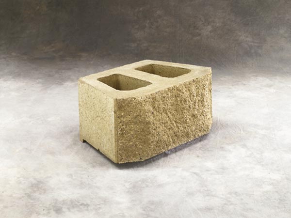

I am building a retaining wall and am wondering if what I'm seeing is normal. Guess I never really paid attention or looked very close at other retaining walls.
The wall is coming off the corner of the house and turing 90 deg. making and inside corner. The block used is the Achor block pro diamond. Attached is a pic of the block. The minimum inside radius is 4 feet, which is what my inside corner is.
As you build up the corses the batter gets off a little bit. I understand that this will happen and why. However the holes in the block are showing a little bit on the curve on the third corse up.
So is it normal to have a little bit of the hole showing?
Everything is really close as it is and the batter only has to get off and inch+ and you just start to see the edge of the hole.
I was also wondering of there was a minimum size for the partial block to offset/correct the batter.

Here is the block.

Circled is the area that shows a little bit.

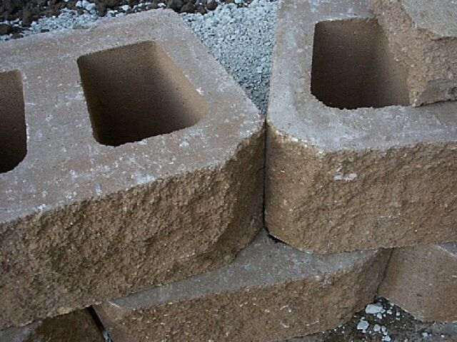

Here is a pic of the wall where the batter is just starting to get of far enough that the hole starts to show. Every block laid after this one reveals the hole more and more.

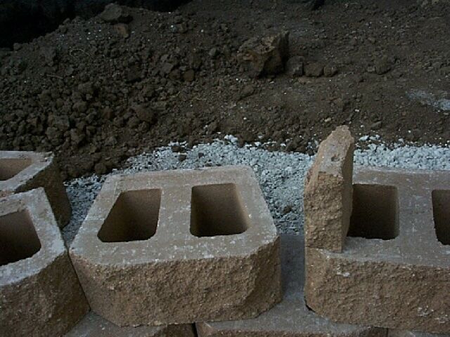

This pic shows how much the block needs to be moved/spaced over to correct the batter again. I have a scrap piece sitting there thats about the right size.
I had it my mind, right or wrong, that there was a minimum size that should be used to offset the batter. I'm starting to convince myself that you just offset whatever you need to and glue it in place. Then stagger the partial block on the next corse.

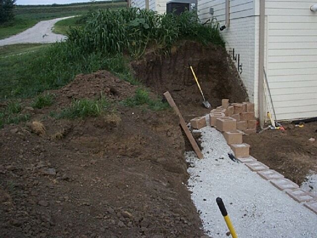

Part of the reason I'm concerned is because I am no expert on retaining walls. This part of the wall will be 7 1/2' tall for the inside curve and taper down from there.
I've dug the base so the first corse will be completely buried. Actually the first 2" of the next corse will be buried as well. The base is 3/4 crusher run 10" deep and packed by hand in several layers then all 10" packed with a vibrating plate.
The geo grid fabric has been laid between the first and second corse of block going back 5', per Mfg recomendation. I've already laid the drain tile and filled with screened 3/4 rock ~17-18" deep, the min per mfg was 12". Everything is being hang tamped in 3-4" layers....uggg.
I just want to be SURE I'm doing the block correctly.

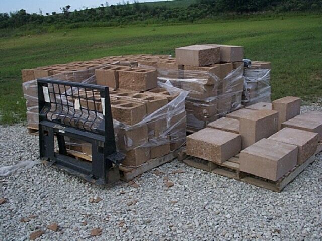

Here is a pic of the rest of the block and my new set of pallet forks. /forums/images/graemlins/grin.gif /forums/images/graemlins/grin.gif /forums/images/graemlins/grin.gif Unfortunatly that is all I could afford.
Beleive you me...paying someone the Big $$$ they charge to build this would be worth EVERY cent!
The large blocks are for the steps that will be incorperated into the wall. The area in the last pic that had lots of rock is where the large/wide steps will go.

First off, I'm no retaining wall expert. But you are seeing the offset because you are off-setting each course--it looks like about an inch. The two courses are different [radius] sizes of circles. The bigger the circle the more blocks it takes to make a complete circle. Since your radius difference is slight (the inch or two shown) the offset just seems to creep in and makes you think something is wrong. Well, it isn't. You just need to make accomodations like you have with wedge pieces, or just allow the joints to move. But if the curve is long enough, you'll eventually have to make some accomodation as you don't want the block joints to line up.
I just re-read this, I hope this makes some sense. I tried to reword it but I'm not sure it helped.
Anyway, I have some of the same alignment movement on my block retaining walls. It isn't really that noticeable in the finished product. To my eye the odd size wedges stand out more than the joint alignment between concourses. Your eye may find it differently.

It looks like you're getting a little too far off center. The holes make it trickier. On mine, I occassionally broke off part of the lip in the back on one side to make my tighter radius turns, especially on inside curves.

Keep in mid that with each layer, an inside radius gets larger, requiring small gaps between the blocks if you want to keep your stagger even, else they will get off center as in your pictures.
This is because as each layer is set back an inch or so for the retaining lip, the "circle" (or portion thereof) gets a bit larger. Sort of like a racetrack. Cars in the outside lanes have to go farther in each lap. The farther from the center, the greater the distance.

I can see exactly what you describe, and can only note that in our free-form wall we would have had the same problem big-time were it not for the fact that we (dumb luck) used beveled Pavestone Anchor Diamond blocks which are solid, not cored. Given that, the installers could "cheat" a little on positioning each block in each course, without producing any gaps. At it highest point, our wall was 8 blocks tall, gradually tapering down to the lowest height of 3 blocks tall.
Our wall had to be sturdy enough to be backfilled and support a paver patio. Our installer recommended the Anchor Diamond solid blocks, as opposed to the Anchor Diamond <font color="green"> Pro </font> cored blocks. Though these are manufactured by a number of companies, they are all manufactured under license from Anchor Wall Systems, Inc. You can compare them at the Pavestone site:
Pavestone Segmental Retaining Walls
You can click on each product and a new page will open to describe the physical dimensions and characteristics, as well as installation overview. Basically, the "Pro" block is a little taller and a little heavier than the comparable standard Anchor Diamond product. My understanding from our installer was that the "Pro" had more of a commercial application for tall walls siding river beds, canals, roadways, etc., and that the coring allowed for rebar and concrete reinforcement that these larger walls would require. How tall is your wall, and what is it retaining?
One consideration might be to switch to the standard Anchor Diamond blocks for your project. I would anticipate they would be somewhat less expensive. Of course, you would have to see if you could return the unused Pro blocks for credit. If you have simply dry stacked many of them, and they are clean and new, they could be re-palletized.
