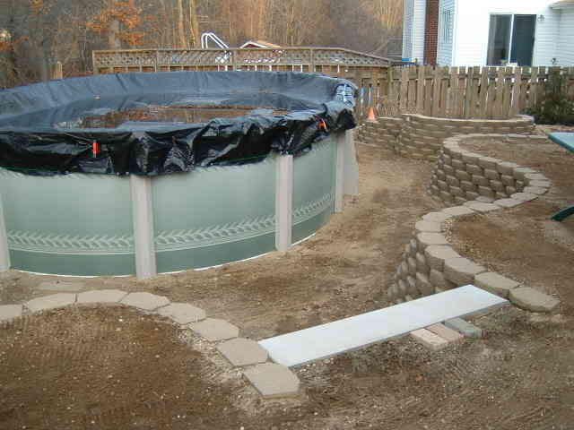

Just finished this one- boy mu back hurts! /forums/images/graemlins/crazy.gifthe walkway & patio are in more pics to follow.

here's another view
