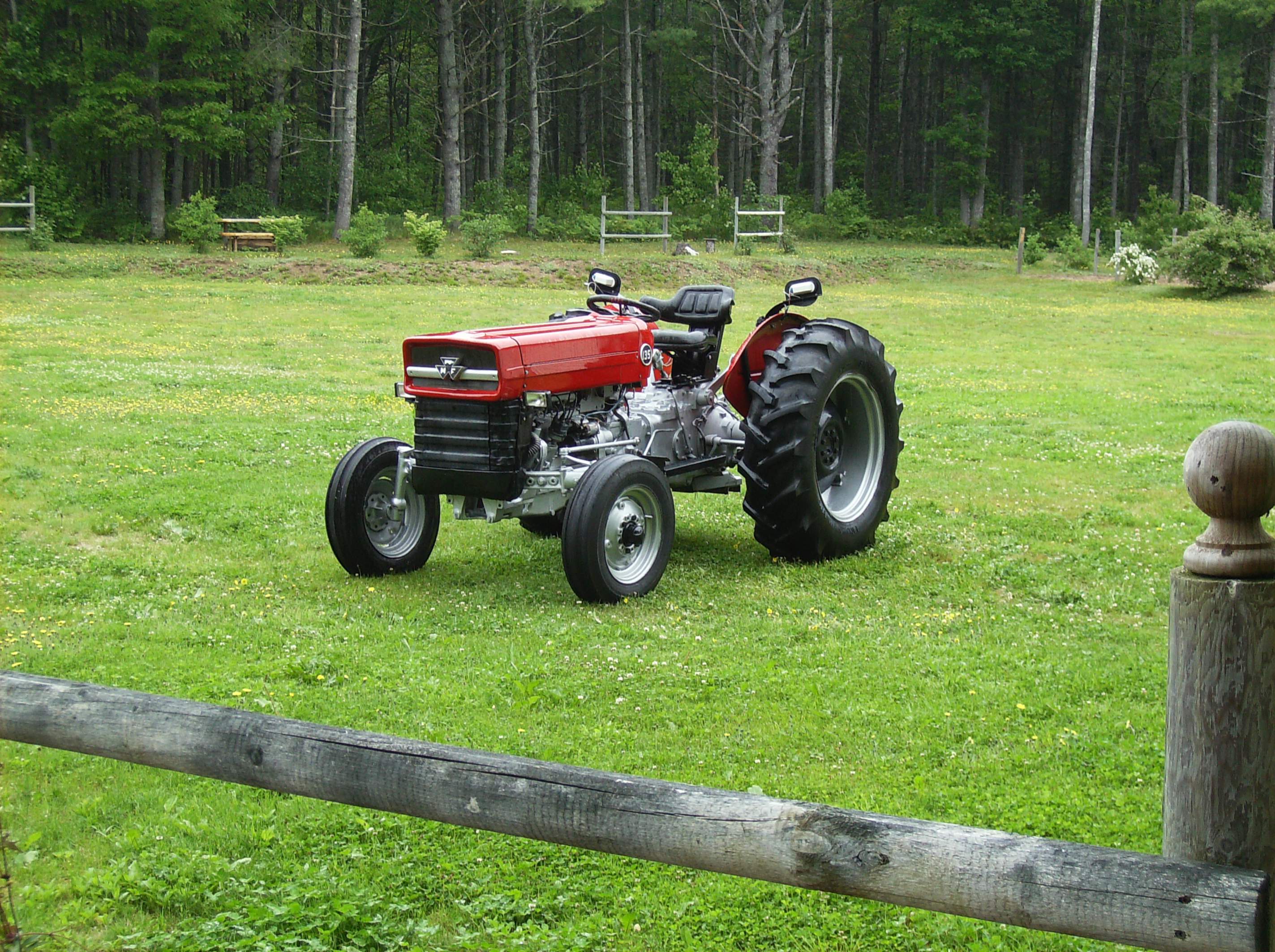

Orbital sander is what you need. Stay away from grinding if at all possible. A small palm sander and some of the sponge pads with med grit on one side and coarse on the other (I found them handy for the crooks and crannys).
You don't need to spend a lot of money on a sander, 20 - 30 dollars will buy you what you need, unless you plan to take up restoring old vehicles as a hobby, then you would want to consider more expensive pneumatic tools.
You'll have fun and get to know your tractor pretty well.
A few pics of mine after getting a little TLC.

That's a good lookin tractor what do you think about sandblasting the sheet metal it has alot of rust I am kinda worried about pitting I want it to look as good as it did the day my great grandpa bought
   / Restoring my MF 65 #9
You could sandblast all the skins if you want to, it would save you some work. I don't know how badly yours is rusted. Mine was owned by a poultry farmer so it had it's share of rust too. I didn't bother taking the smaller dings out of mine, although I did have to pound out the nose quite a bit, I think whoever owned it before me practiced rolling stops against whatever was in front of him :laughing:
The paint I used was left over from my painting my 04 Ram, poppy red. It's a pretty close match to the MF red, especially on the newer tractors (my neighbour just bought a 1528). I don't know that I would have gone through the expense of buying base/clear coat if I didn't have the paint leftover to do it but I'm glad I did, the clear coat is a very tough finish. I've rattled chains on the deck lid and around the fenders without so much as a scratch.
Good luck, post some pics as you make your way through the restoration. :thumbsup:
