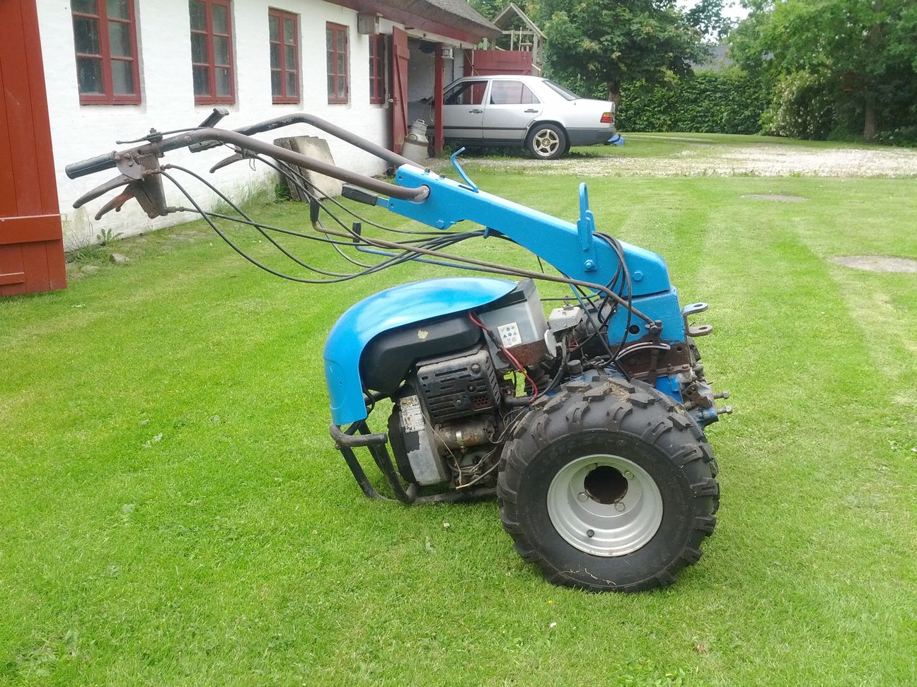

Renovating a BCS 737
Hi
I am a (very) happy owner of an old 737. Bought it with a large three rotor mower last summer for 3500 kr (about 600$) but havent had time to mess arround with it untill now. It is in quite poor condition and looks like it has been spending alot of time in rainy weather.
But is starts immediately. It kan shift gears and the PTO is spinning. The ACME engine sounds fine and runs steadily even in idle running. Some cleaning, rust removal and paint has now made it look very fine again. img_20120630_134034.jpg

1. The engine is old, so do I have to use leaded gasoline?
2. Acording to a manual I found on the net, the transmission holds 2 litres of oil, but I only drained about 1 litre fom it. I have filled 1 litre on it again and it now reaches the upper marking on the dip stick. What is the correct amount of transmission oil. One or two litre?

Nice looking machine you have there.
1. No. The 737 was built in the early 90's, so it' not exactly ancient. No lead needed.
2. If you drained it as it sits in your pic, you didn't drain all of it. You need to have it tilted back to get all the oil out.

I just finished a 725 to 735 conversion on my tractor and it took just a little over one liter to fill to the upper mark also. I left it and have checked it several times - still looks ok to me. I believe that these are like most other transmissions and your better off not overfilling.

Put larger diameter wheels and tires on the tractor to increase the ground speed. Look at the information on this page: Tractor Accessories

The fourth gear is only accessible in "tractor" mode. You'll need to find the sister model - a 605 - to get fouth in "mower" mode.
I think you'll have several problems with pulling a 4 wheel tractor-type rake. First, the tractor style ones have the PTO above the drawbar and you'll have the PTO below. Second, the PTO turns at 990 RPM on a BCS. The 6 spline PTO on a full sized rake will be 540 RPM. I have not tried to use one, but you should be able to find a ground driven bar rake in Denmark. I don't think you'll have enough traction w/o overloading the little BCS, but maybe...
