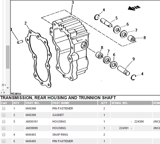

The jd 314 shows in jdparts.com and there is a gasket between the transmission rear housing and the transmission cylinder block.
part # M45399
Don't know if this is what you are meaning by the words you use, but seems to fit.
This schematic shows the parts between the rear housing and the block, but can make out the gasket.
Is this where you questioned the need for one?

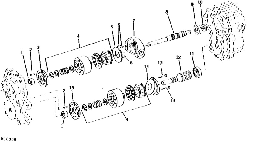

Hmm....seems to me there was a square cut o-ring between the two units. if you could post a pic of what your components of concern are it would help. I think you are talking about the pieces that join male to female - spline to an internal coupler shaft. beenthere is on the right track with the exploded view...although m45735 is the o-ring I am thinking of in the charge pump and oil filter schematic. your restoring a great tractor the 14 hp kohler is top notch when paired with the hydro tranny. are you rebuilding the engine?
   / Restoring a 1983 JD314 tractor
Hi Folks,
Thank you very much for your responses. I added a file below which shows the parts I am referring to. The parts diagram definitely shows a gasket but when I disassembled the unit there was only RTV silicone to make the seal between the units. I am sure I can make the gasket or order it. I am the second owner of this tractor, bought it when is was less than a year old so it is possible the differential housing was opened for repairs and the gasket omitted. It is a royal pain to disassemble this section so I want to do it only one more time.

Try jdparts.com for some clearer pics than what you posted.
Here is one from jdparts.com that shows the transmission rear housing and the gasket that is item 2 (part # M45399).
Maybe this is not where you are having the leak.
