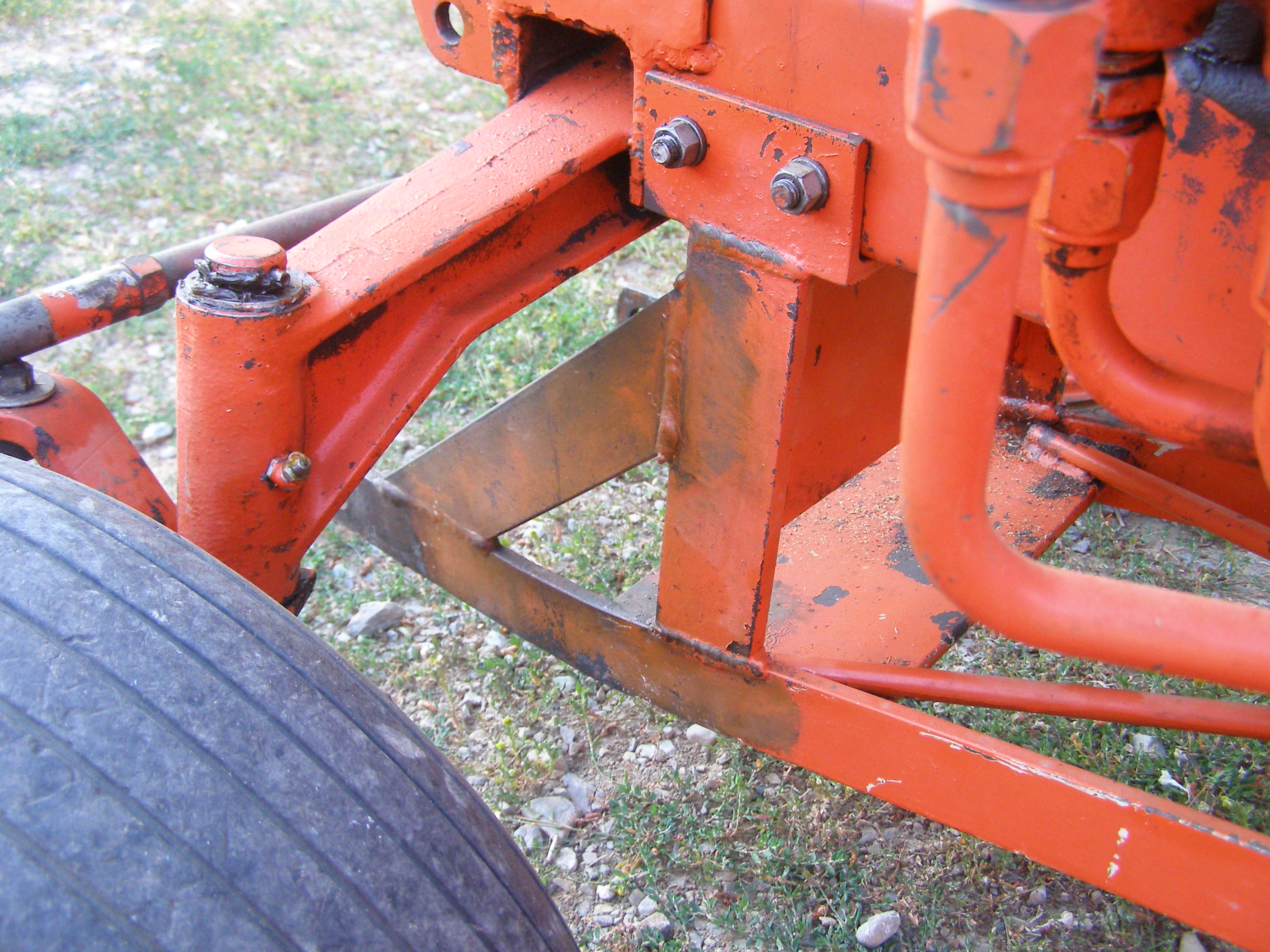

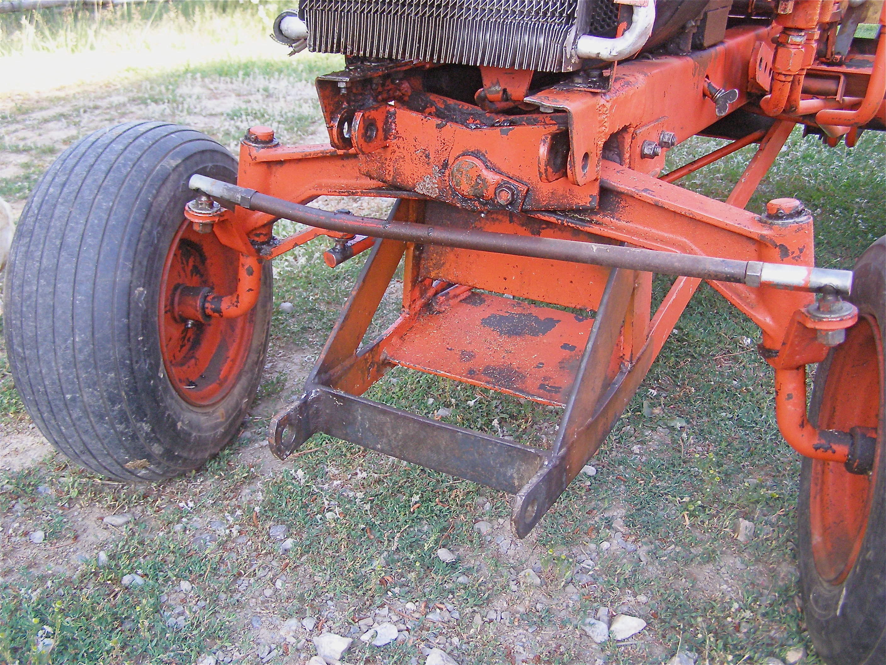

The belts are worn on the mower deck, the drive chain on the rototiller is broken and the sacrificial edge on the blade is rough, but otherwise the units are in good shape. My problem is getting the mower connected.
There is a structure attached to the underside of the chassis that interferes with the deck's lift rods and the idler assembly connecting to the lift frames and front bracket. Is this structure removable? Is it something that is used to connect the utility blade but has to be removed to use the mower?

Im not sure how much they have changed thru the years, but im pretty sure the front blade has to be removed. The mule drive should mount where the blade is attached to the frame now.

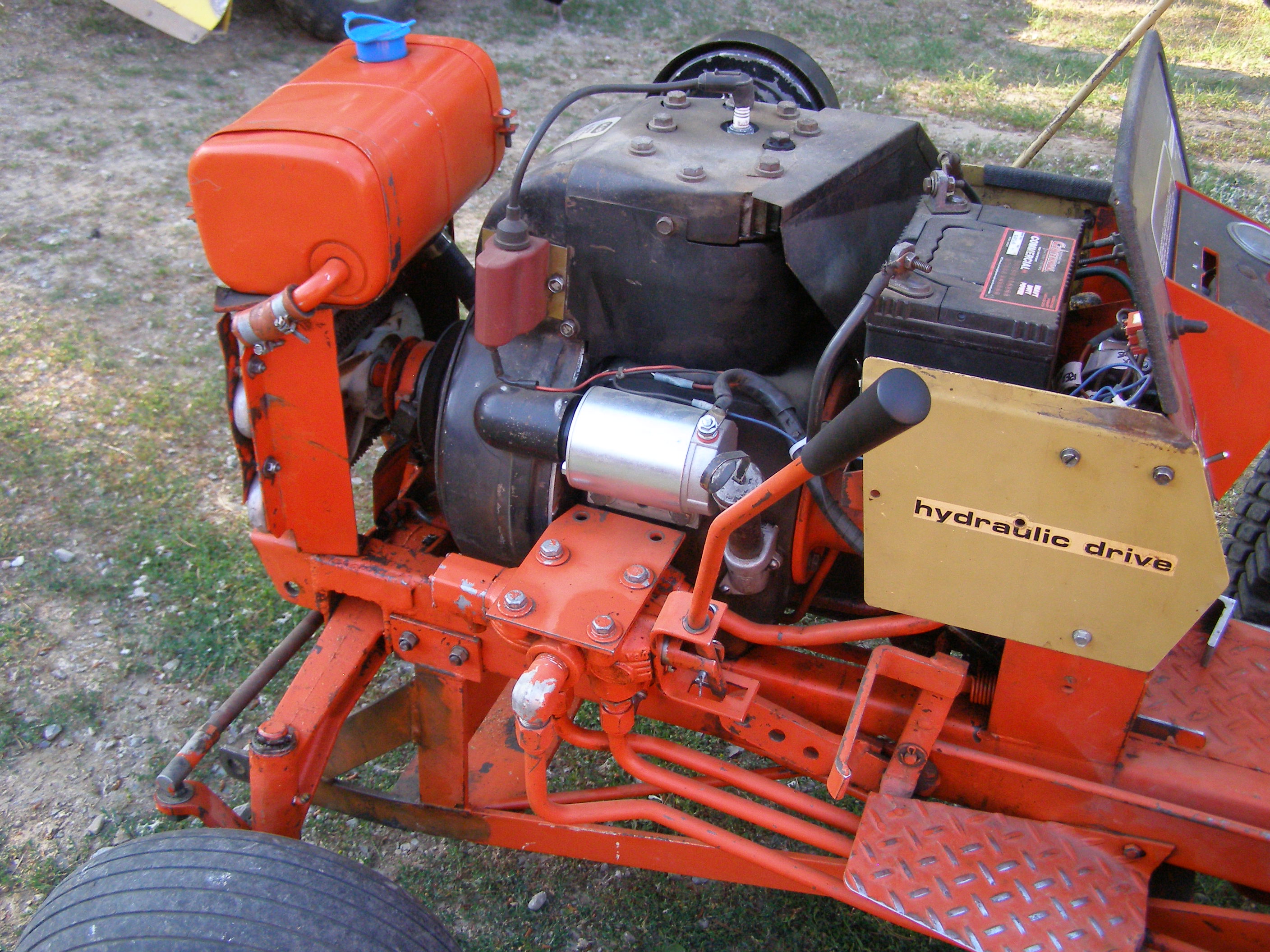

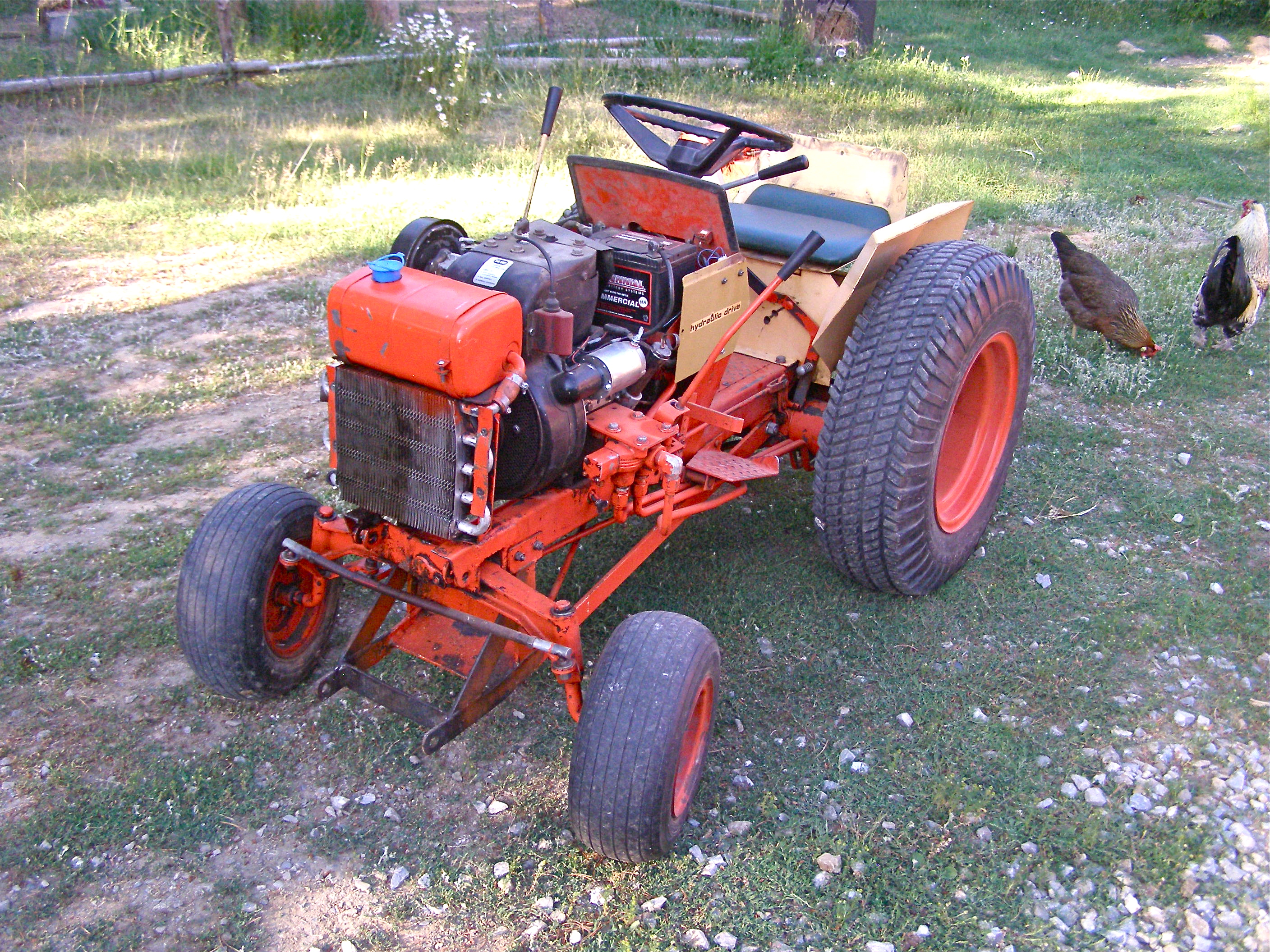

Case444-1 copy.JPGCase444-4 copy.JPGCase444-2 copy.JPGCase444-5 copy.JPGCase444-6 copy.JPG
Yes I have the hood, I just took the thing off so I could get to all the character building "challenges" that keep happening.
The good news is I've figured out the structure under the frame is indeed the utility blade attachment. The blade slid right on with a large pivot bar as a hinge held on with cotter pins.
The bad news is after a few strokes over some soil i needed to level i saw a large oil leak shooting all over my left shoe. Not a simple hose this time, I think I've blown the pump to the tune of $500.00,
which makes my new Case 444 a $3,000.00 paperweight. No way I can afford to replace the pump.
Oh I'll still take it off...maybe its just a gasket. But my "great deal" on all this neat stuff is becoming a land boat: a hole in the garden into which you dump money.
I think that **** "downward pressure pin" might be the culprit. The manual said you could damage the hydraulics by not having it in the "outer float" position. The 4th image shows how the thing is configured now.
Can anyone explain to me how I'm supposed to use this with different attachments?
