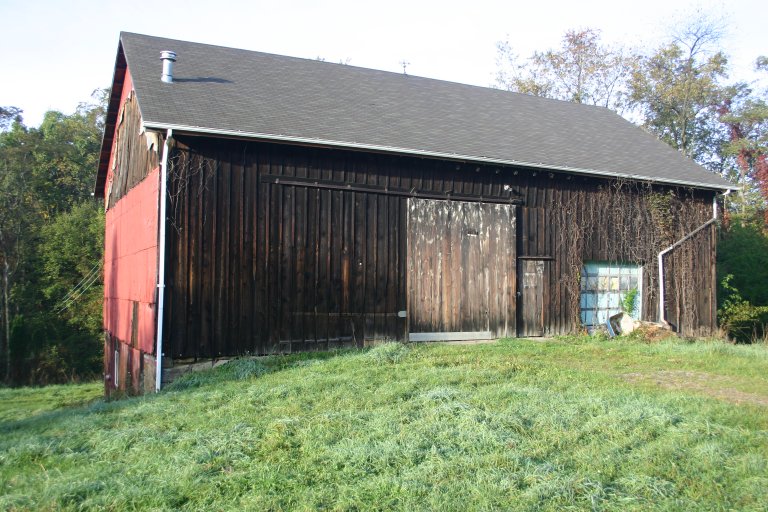

I have an old barn that needs to be reskined. I had planned on using rough cut lumber running vertically. Someone suggested that it would be easier (and better) to run the lumber (or siding) horizontally. Is there a standard way lumber was run on barns? My barn dates back to the 1850s and the exterior lumber runs vertically. I've some some searches and 70-80% seem to have lumber running vertically. Any thoughts?
Here's a fairly recent pic of the barn:

I would think a vertical board and batten barn would look more like a traditional barn. If you run the boards horizontally wouldn't you have to overlap them like clapboards to make the barn watertight? Seems like more work.

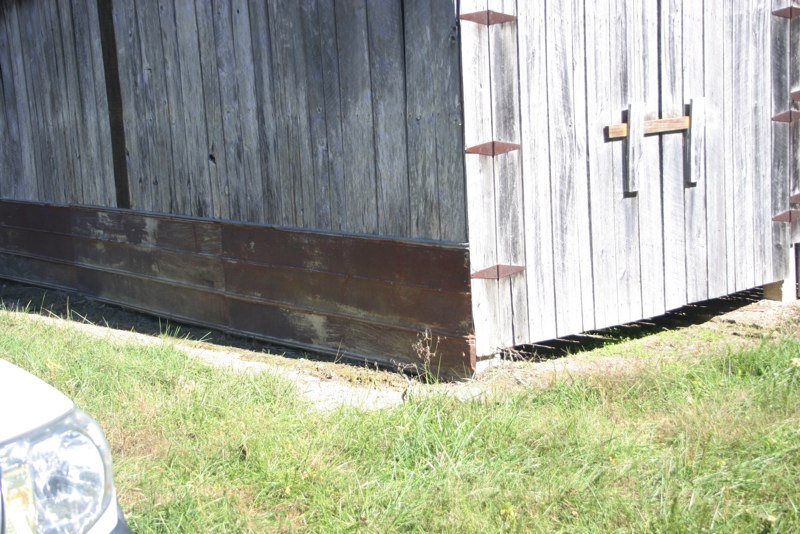

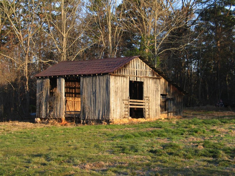

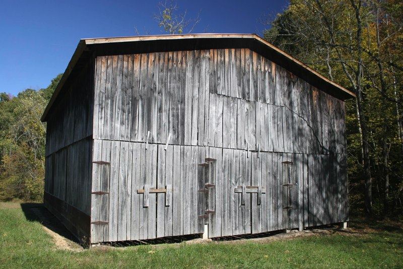

My brother in law did this old tobacco barn. Basically shore up all the uprights, cut the bottom three feet and replaced, re-roofed and used the old tin as a splash guard(no gutters). Also, cut all the wood to be about five inches off the dirt. Only the real high jumping termites can get to it. He did mention some folks treat the bottoms with diesel to keep the termites from infesting.
Your barn looks to be in pretty good shape. I've got one(the last picture) I need to do that to but it really needs some work.

I've seen them done both ways and really don't think one way is any better then the other if done properly. Since the building was originally done in board and batton, it would keep it's authentic look to keep it that way.
Have you considered using 4/8 sheets of exterior grade plywood and then nailing/screwing battons on it every twelve inches? The plywood will add considerable strength to the building and save you allot of money. Another idea, and one that I'm going to do on my deer blind, is to use 4x8 sheets of Hardi siding and then cut Hardi strips to act as battons. The look will be very similar, but you will never have to paint it again, it will never rot on you and it's bug proof, not to mention fire resistant. Installing it is a little more labor then plywood, but less then doing actual board and batton. Cheaper too.

You will have to over lap if run horizontally, if you are using green or fresh cut rough cut lumber it will cup. Both directions were used here on old barns.

I did a tour through farm land in PA and OH. 80% of tha barns I saw had lumber running vertically. Since that's how it's on there now, I'm going to keep it that way.
