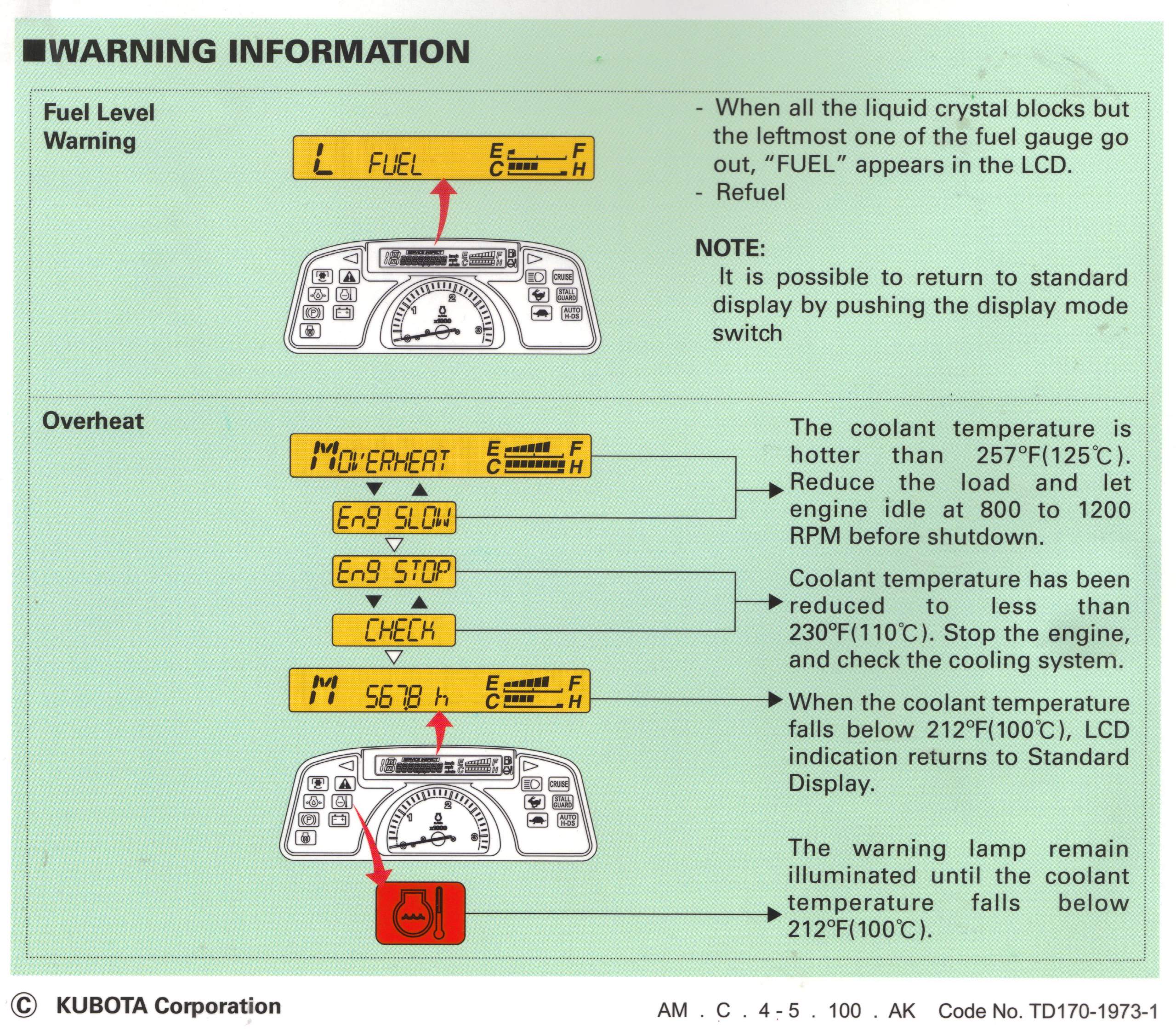

Did 50 hour service some time back, looked in the owners/service manual, could not find how to reset the service reminder, and wound up forgetting about it. Now up to 94 hours, climbed in cab and for some reason, that was the first thing I saw when I turned on the key.
How DO you reset the darned thing? once reset, will it count down the hrs from time of reset, or does it automatically pop up every 50 hrs?
Thanks in advance.

I believe you press both buttons while indicator is on hours and hold for about two seconds, reminder comes on every 5 hours regardless of when it was reset.

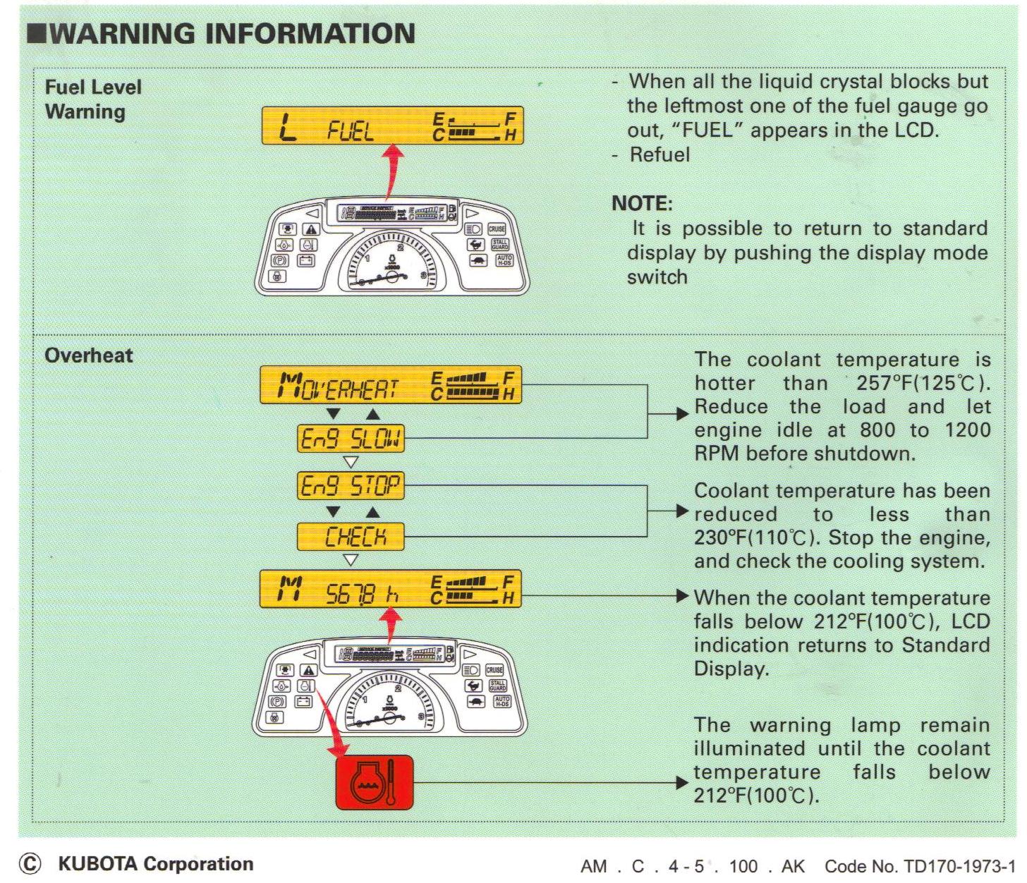

In this document are the instruction on how to reset the service minder. Once reset, say at 94 hours, it will count from there to your next oil change, which will be 294 hours. Philip.

Manual upload did not work. Of you want copy, send me private e-mail. Philip.
   / Reset service reminder?
Got it done,
Thanks for the help!
