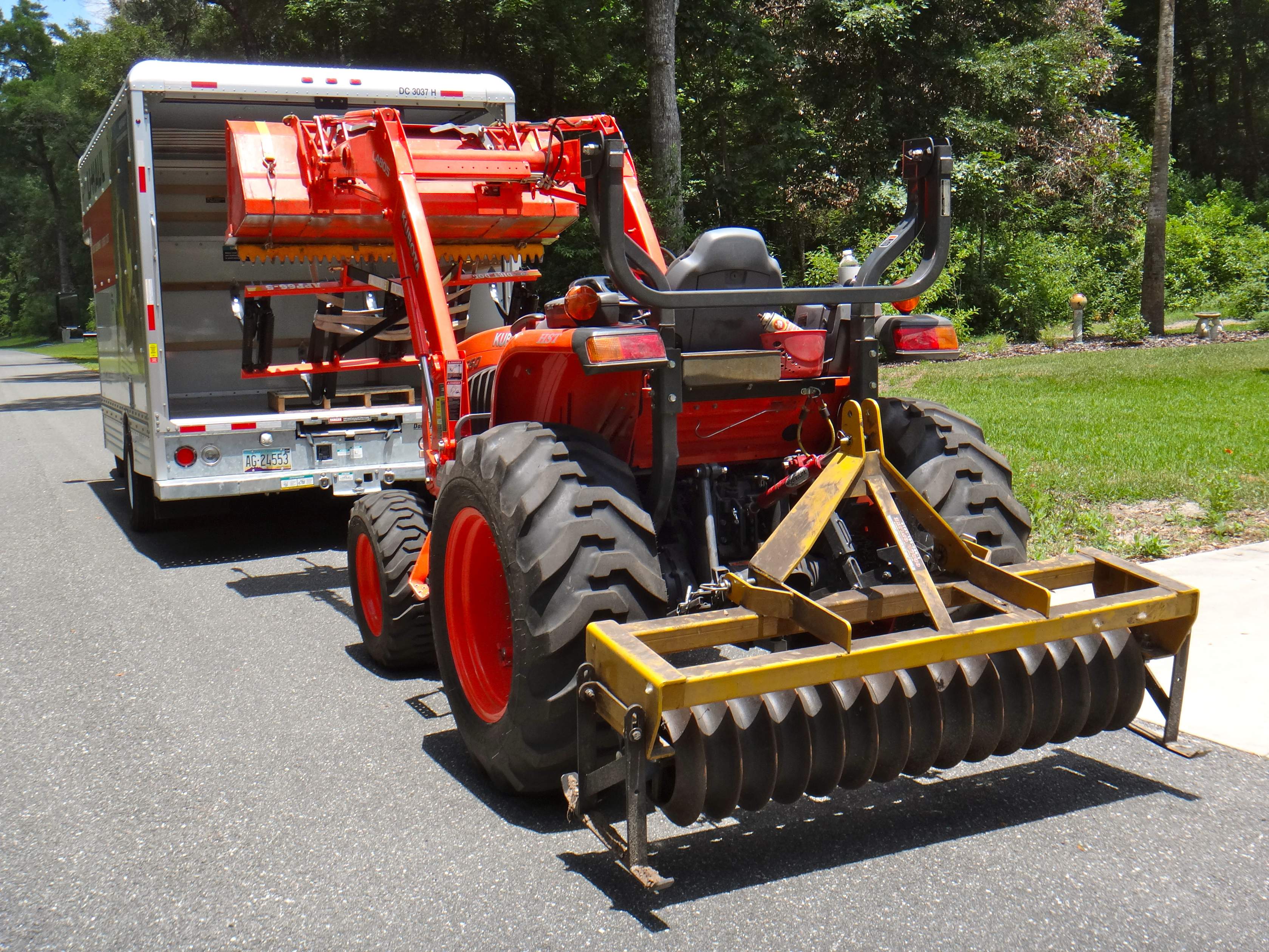

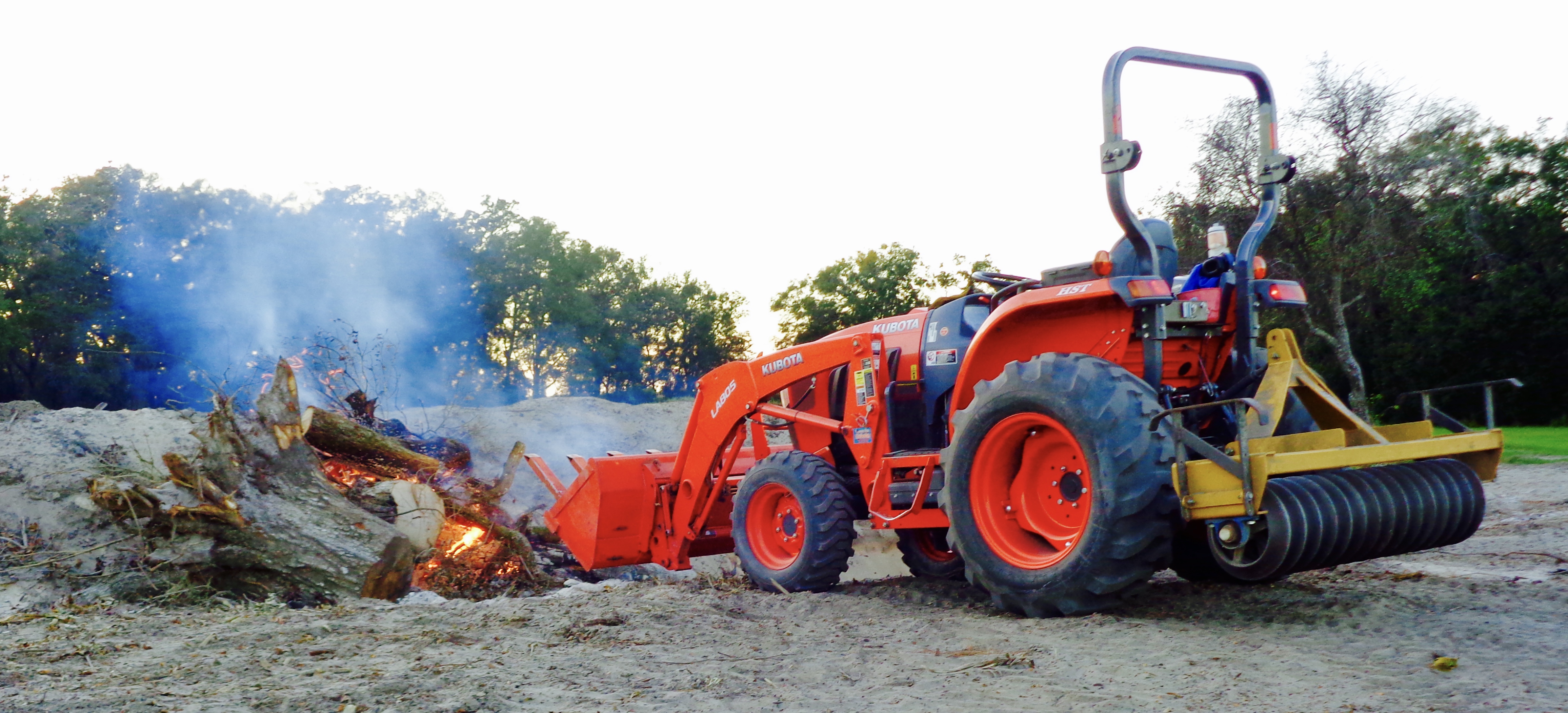

Both models require considerable Three Point Hitch counterbalance for max FEL lifts. This make the tractor + counterbalance a fairly long unit, with the M6060 a longer unit than the L4760. ~~ PHOTOS ~~
Neither of these tractors will fit in a residential garage with a standard 84" header. Where do you intend to keep the tractor? Tractors are theft prone.
If you will be fueling out of 5-gallon containers as I do, fueling an M6060 will get old fast.
