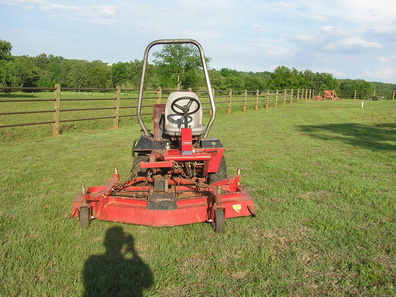

Why do you ask? Going to put a front deck on your John Deere? Going to buy a Kubota front deck machine?
My 28hp Kubota powered TORO has no problem with the 72" recycler deck:
