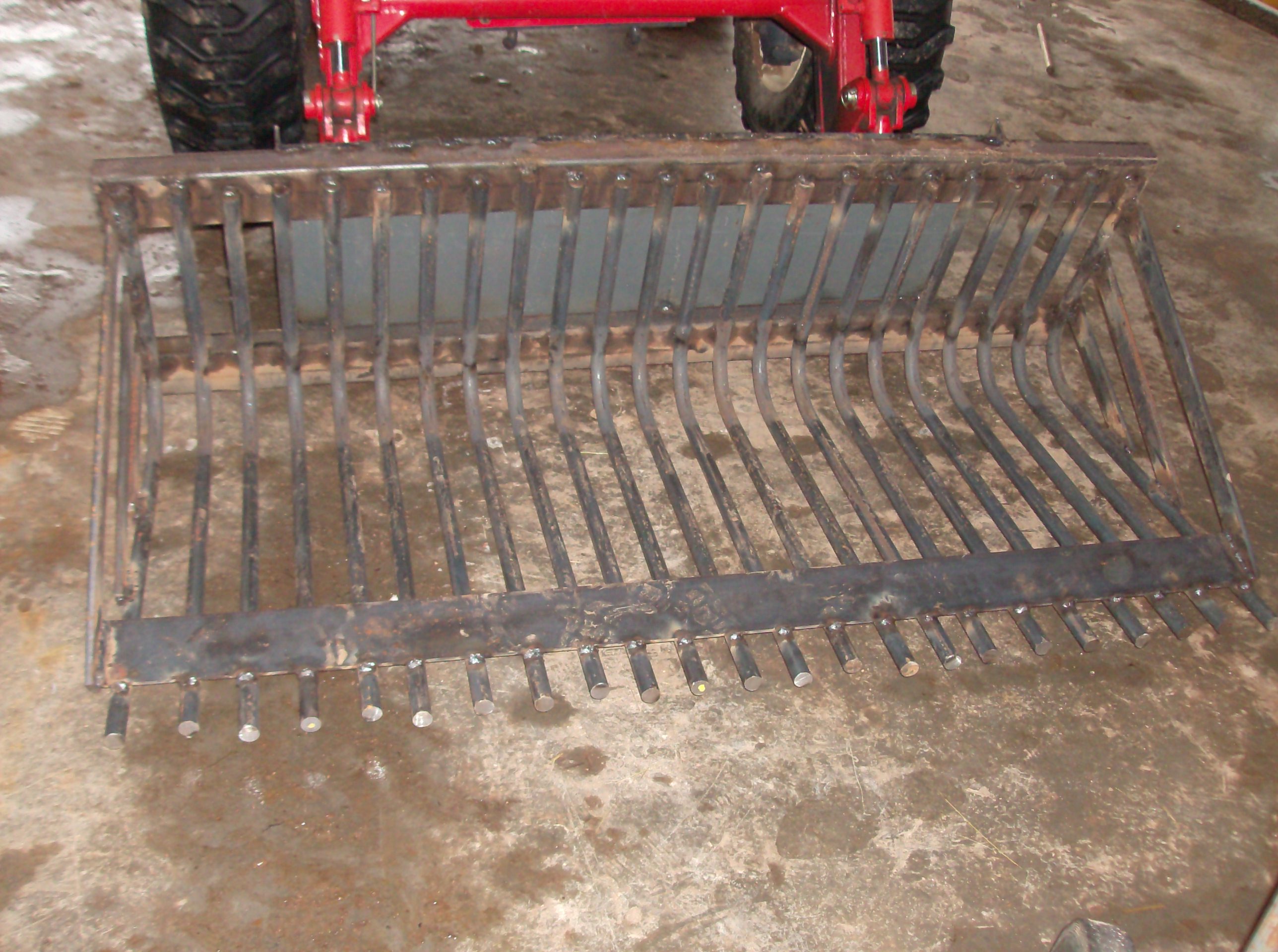

Just bought a new Kubota 4wd L4600DT with the QA FEL. I live in 'Rocky Top' Tn. Lotta rock content in teh dirt as well as roots. I am trying to harness an area maybe 80' x 150' for veg farming (personal consumption only- -I just retired). All along, Ive had my trusty 29 yr old JD 750 tractor with the FEL. I try to use it or the 'fingers' on a box blade to surface roots or rocks (basketball or larger) Sometimes I will work at it and dislodge one perhaps 500-600#. Then I have to struggle and pry it into the bucket w/pry bar. Very time (and lumbar) consuming. I am considering a QA 'rock bucket' that I see on Ebay for $800 delivered. SKID STEER SKIDSTEER LOADER 72" ROCK SKELETON BUCKET FITS BOBCAT, CASE, DEERE on eBay! Aint sure if this is a good unit or even if its a good Rx for what Im trying to do. Thanks from a newby

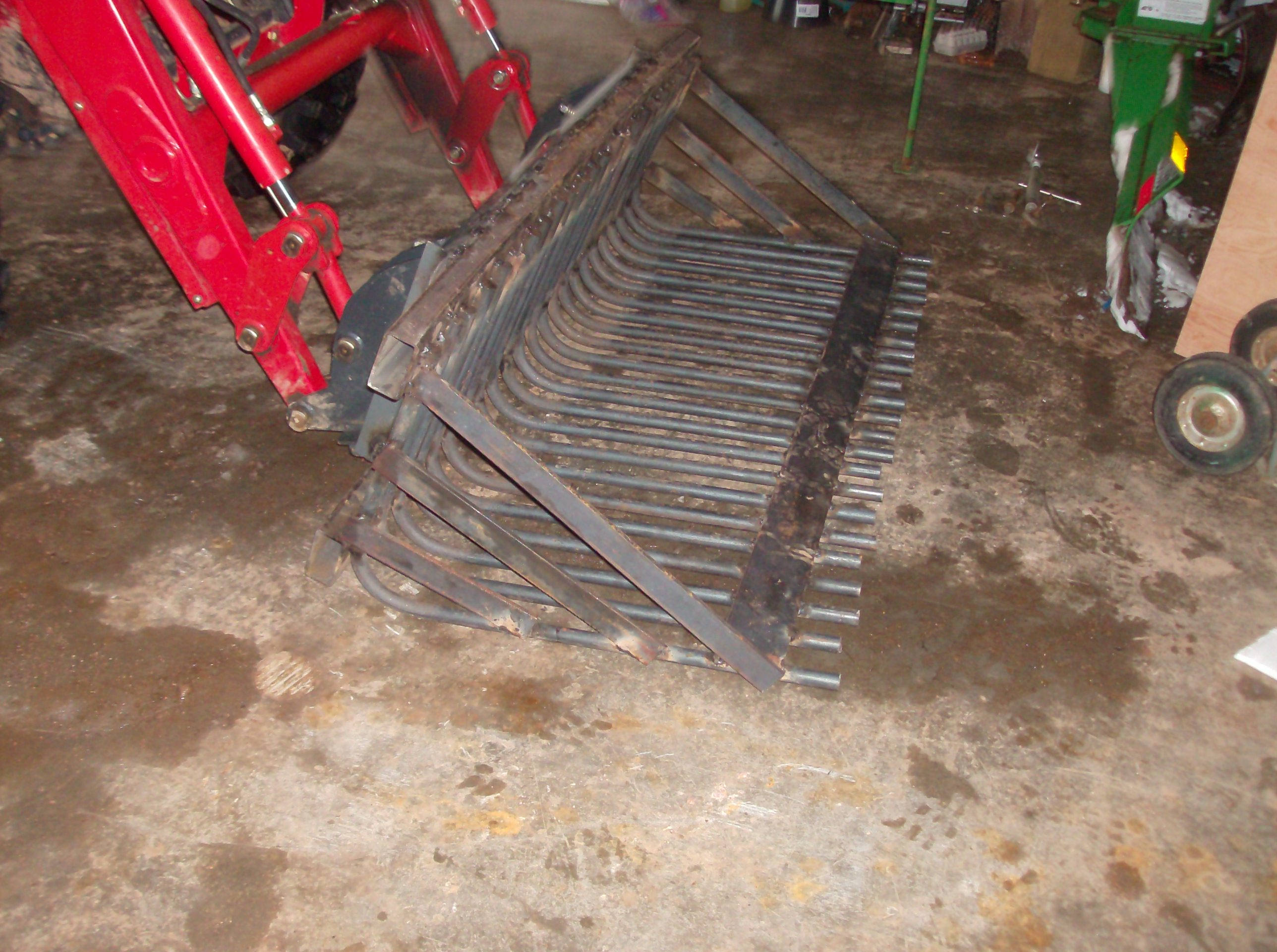

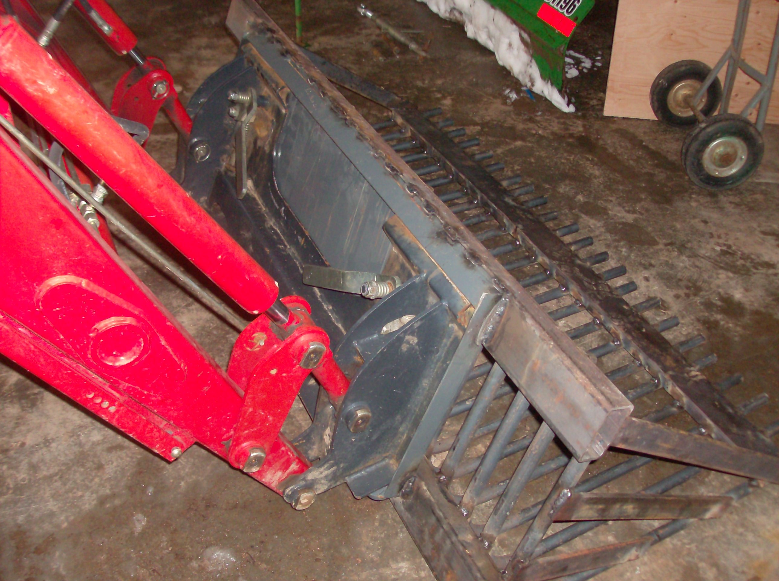

I just built one over Xmas . Cost was about $600 . So $800 doesn't seem to unrealizable with delivery.
