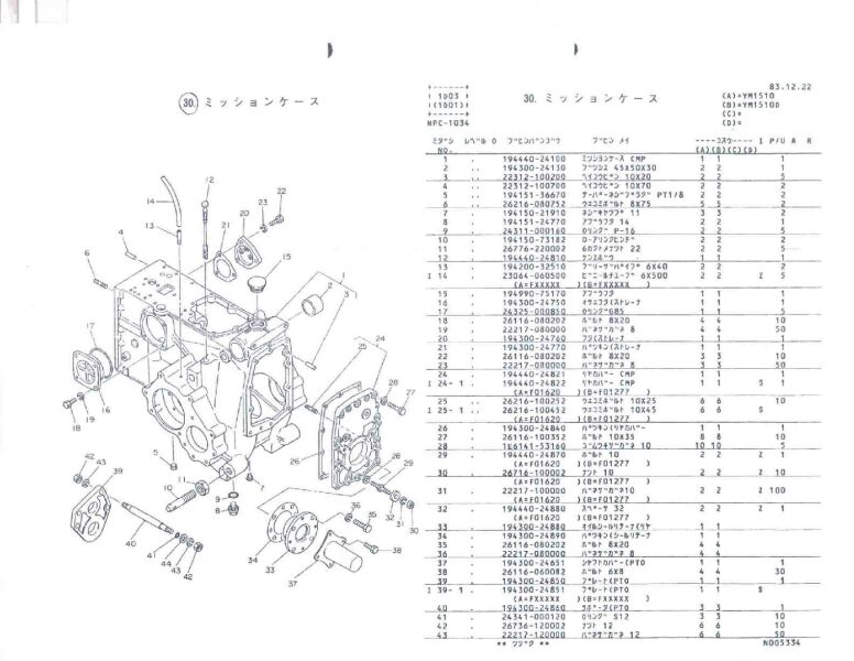

I don't have a YM1510 or YM1510D, but I do have a parts manual. Have some patience and I'll try to get you jpg's of the appropriate pages from the manual.
Here's the first - you can see that the lower link arm pins just thread into the rear tranny case. They are part 10, with a jam nut part 11 in the picture. I don't have anything on the rest - but I believe that the drawbar is the same as on my YM1110D's. It is simply a piece of heavy U channel bolted under the rear tranny case between the places where those pins are with the open side down. You should have at least three threaded holes under there to use to fasten it. Then there is a small diameter tube which runs across and through it lined up to be on the same axis as those lower link pins. I think the idea is to put a bolt through the drawbar to attach the sway chains to.
I'll try to get a photo of one of mine tonight. I don't currently have a 3pt on mine, but you'll get an idea of the arrangement.

I would definitely appreciate the photos. Mine does have three bolts up into the bottom of the case. Currently there is a make shift bracket there. Simply a boxed in piece of 1/4" stock with some rings made to hold the chains.

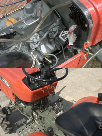

Here's two shots of the tractor - the back at the PTO and the Decompress lever at the dashboard and on the engine. Hope they help.

That was the Decompression lever.

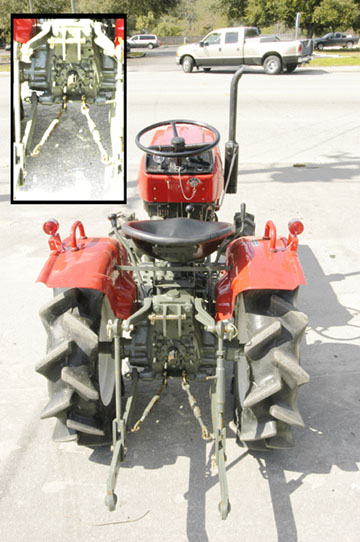

Next the PTO coupling.

Thanks for the photos. Nice tractor. I wish I bought a D. That's my only complaint about my tractor is the lack of 4wd. I've had mine for about 3 years now. The only problems that I have had were with things that were assembled wrong when it was re-conditioned.
I see that you have a clear fuel return line. Make sure that it is compatible with fuel. All of my lines were air lines which were not compatible with fuel or the pressure. I just finished replacing all of them. They had deteriorated badly in just a few years.
Unfortunates it looks like you don't have a draw bar either. I have a few people looking for a used one for me. If I can't find one I'll try to make something up that will work.
I couldn't trouble you for a close up of the hood hold downs could I? I'm missing these too. I'm sure I can bend up some rod that will work but I'm curious about the spring arrangement on the bottom.
