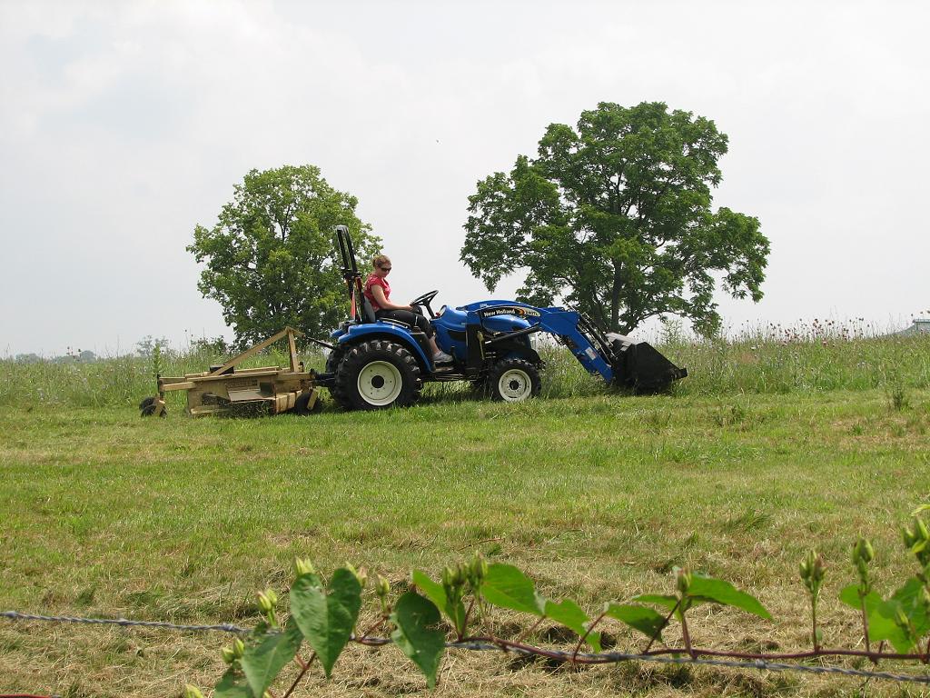

My wife and I are helping the neighbor mow their field. They just got the property and do not have the equipment to cut the field. The field is clear of debris and sablings and is just tall grass. (Walked the field several times over the years and yesterday.) This morning my wife cut a few acres of the field while I worked on other items.
I know a bush cutter would be much better for this but we haven't had any issues at all cutting the high grass. We are staying well away from the tree lines and we and the neighbor are scouting the fields before we mow. In total I have about 10 acres of this to mow and the little NH is having no issues with the 90" mower.

   / Report: 90 Inch Finish Mower on New Holland TC31 #6
Wow! I didn't even know they made a 90 inch side discharge mower. Amazing it can move all that grass out the chute.
Looks like the wife is having fun.

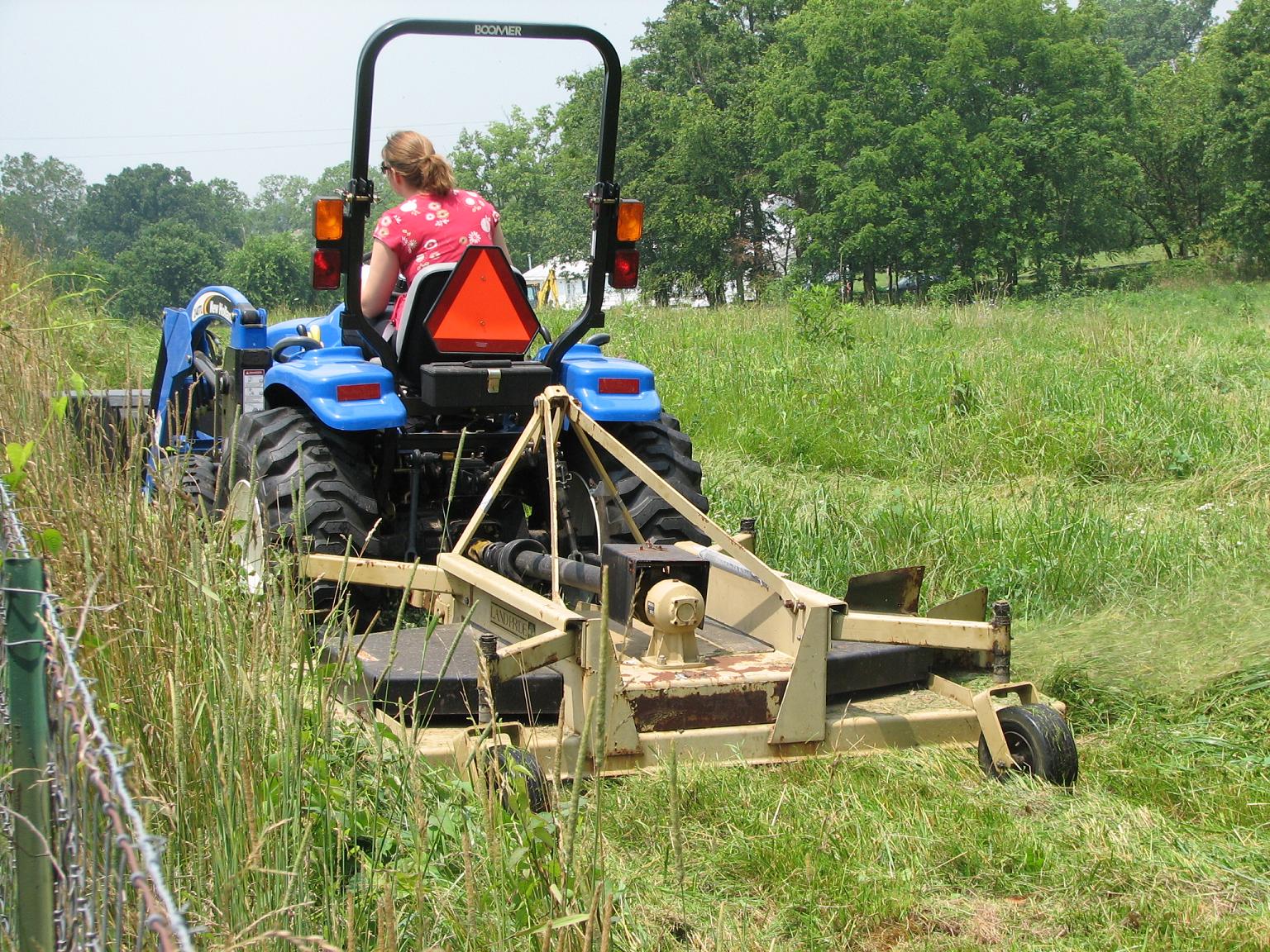

   / Report: 90 Inch Finish Mower on New Holland TC31 #7
I hate to question you, but from looking at the picture of your mower from the back, it's hard to believe that it's 90 inches wide. Are you sure of it's size? My 84 inch mower, which I am sure of because I've bought replacement blades for it, sticks out over a foot past both of my rear tires. It's out there a good distance, and yours just doesn't appear to be as wide.
Eddie
   / Report: 90 Inch Finish Mower on New Holland TC31 #8
Eddie
Ya, looks like a 72" to me Eddie.
#9
You have me doubting myself but it is a 90 inch. (AT3590) In the picture the chute is up you can barely make out out the left side edge of the mower. Sorry
Better picture showing the the rear from this weekend. The black part of the deck just covers the spindles and not the entire deck.
