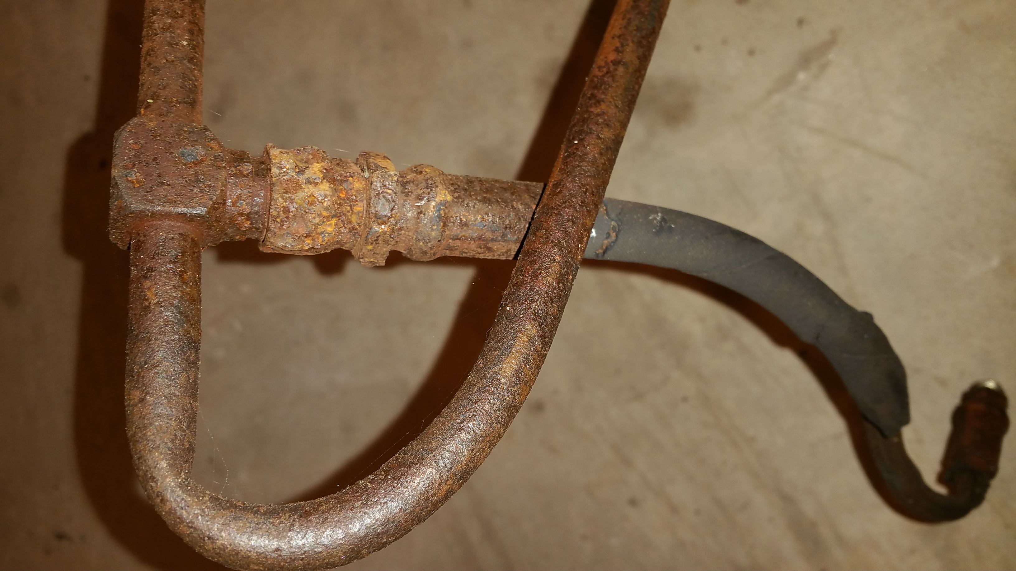

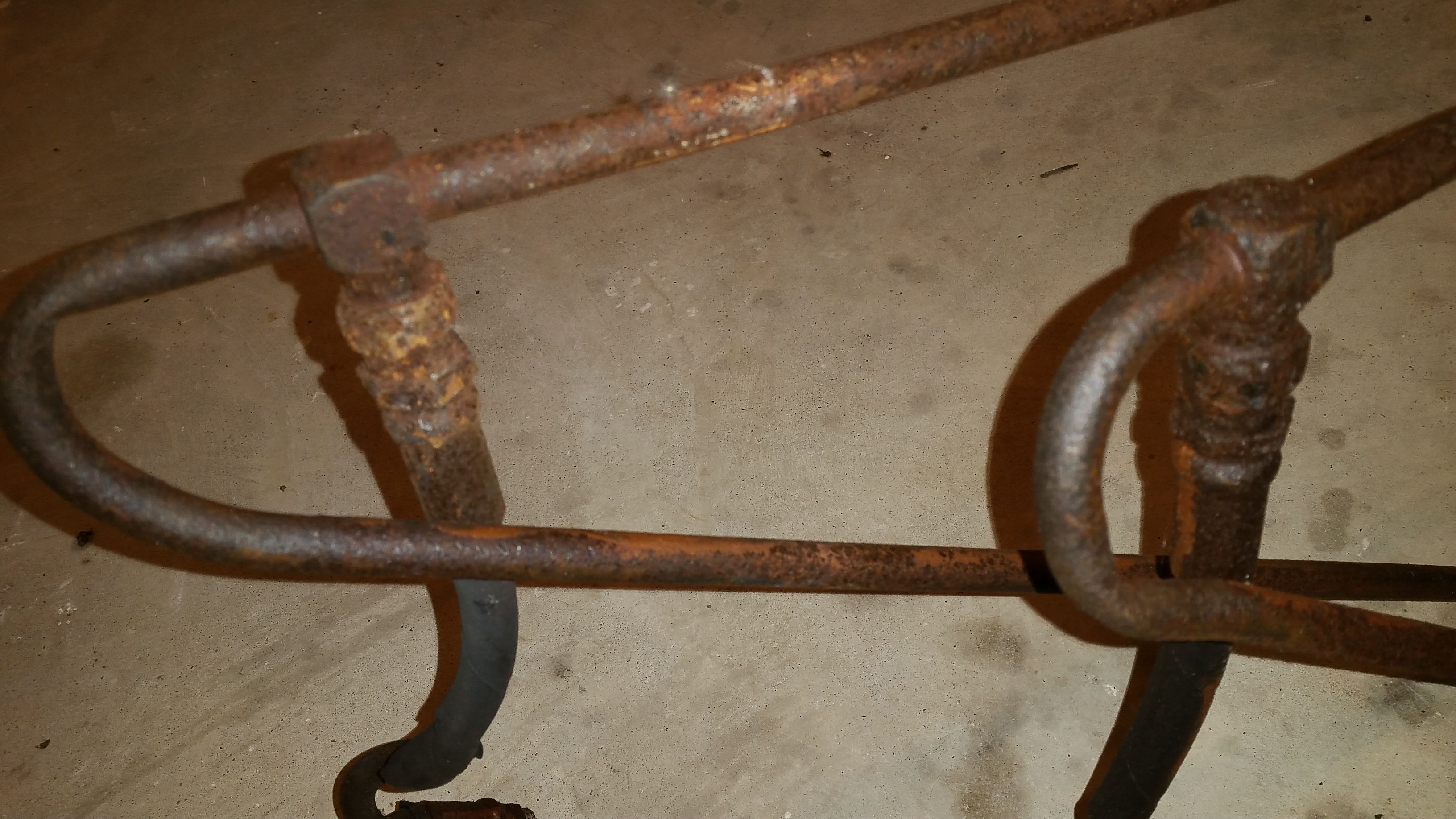

After suffering through 2 hurricances (Rita and Ike), all the hydraulics on the KL249 loader of my Kiotic tractor finally gave up. The lines are all rusted and all the connectors are beyond reuse. I took all the lines, hoses, and cylinders to several local shops. I received quotes totaling roughly $2500 ($1300 for the steel lines & hoses and $1200 for the cylinders). Some offered 10% discount on the price, which would cover the sale tax but that was it. $2500 is far more than the value of my loader so that wasn't an option for me.
So I went on a shopping spree mostly on ebay and the Surplus Center advertised here on TBN. I ordered all the cylinders and hoses from Surplus Center. Then I bought stainless steel tubing (Zorro on ebay), stainless steel fittings (various sources), and oil impregnated bronze bearings. My total bill so far is $650 including shipping.

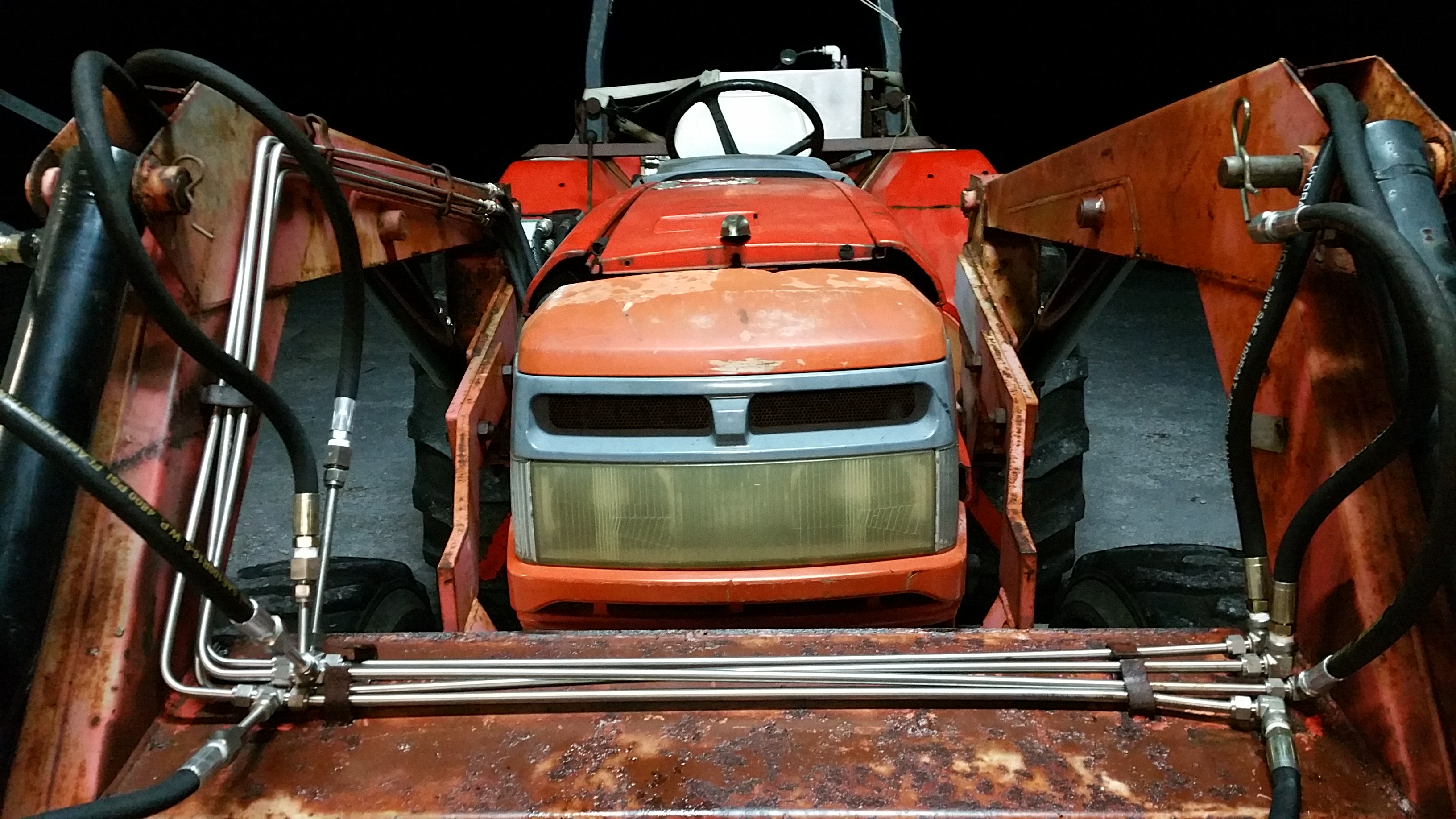

Got it all done. The stainless steel tubing worked out very well but come to think about it, I could have done the whole thing in hydraulic hoses for much cheaper. As it was, I replaced all the steel lines and fittings with stainless for reasonable cost because I spent time to buy them through ebay. Now I have a crappy, rusty tractor with shiny shiny hydraulic lines!

My tractor got flooded with salt water and that caused severe corrosion every where. Last month the steel lines sprung leaks and I had to replace them.

I need to arrange the stainless steel tubes to make them all neat. It not as easy as I thought but it will be done. Right now I'm just glad I get the tractor operating. There are more pressing stuff I need to get done like repairing my hurrican damaged shop.
