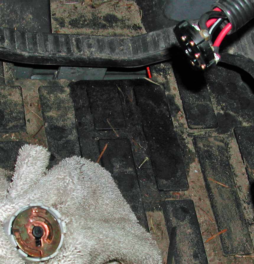

BTW, it is very easy to dissassemble the Kioti key switch and check/clean the contacts. This photo shows the
insides of my 2005 CK30 switch, which I opened up to see how it looked. After hearing of others
who suspected switch problems, I am glad to say I have had none. (Ground contacts from battery to
subframe, that's another story.)
