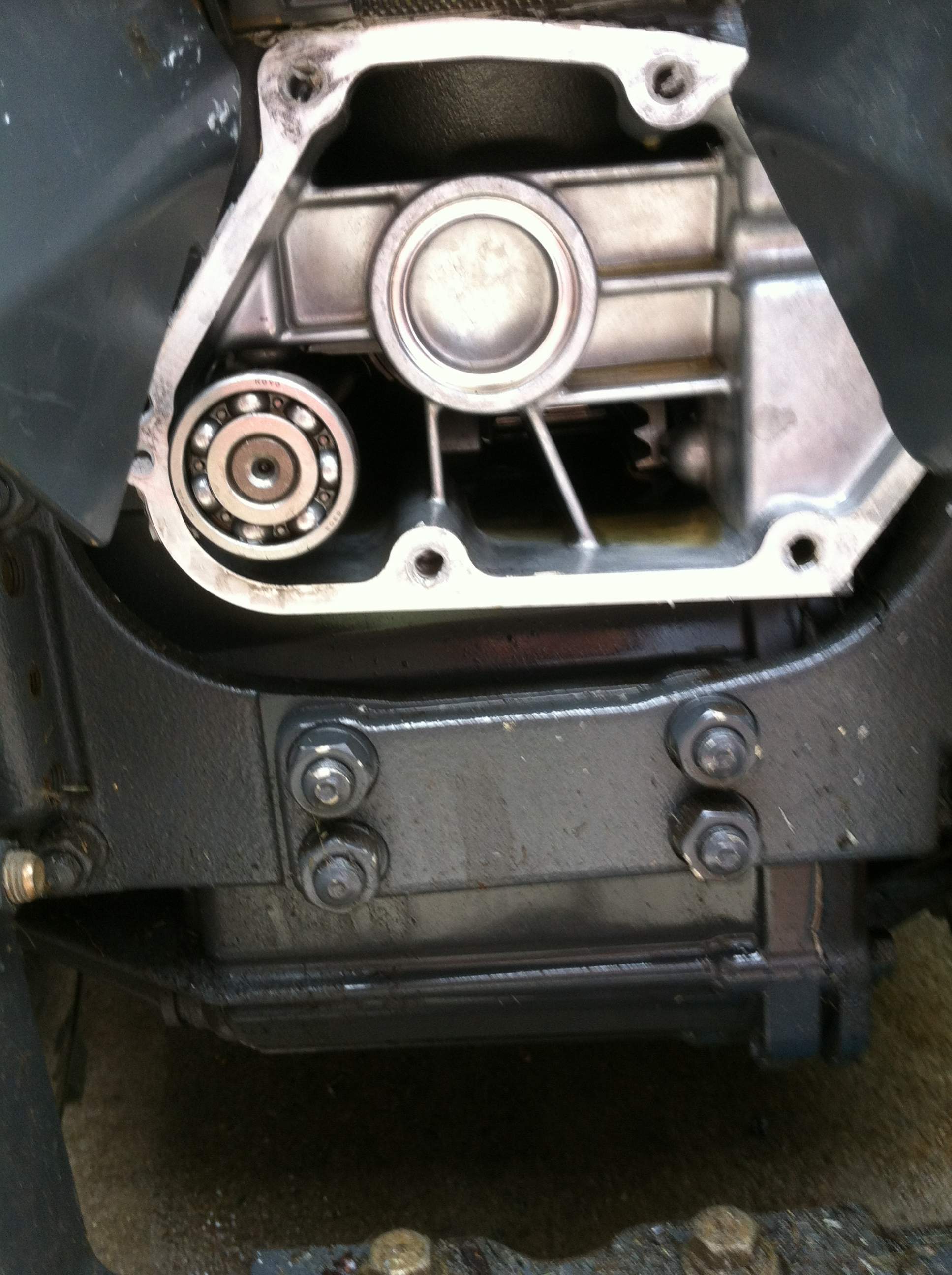

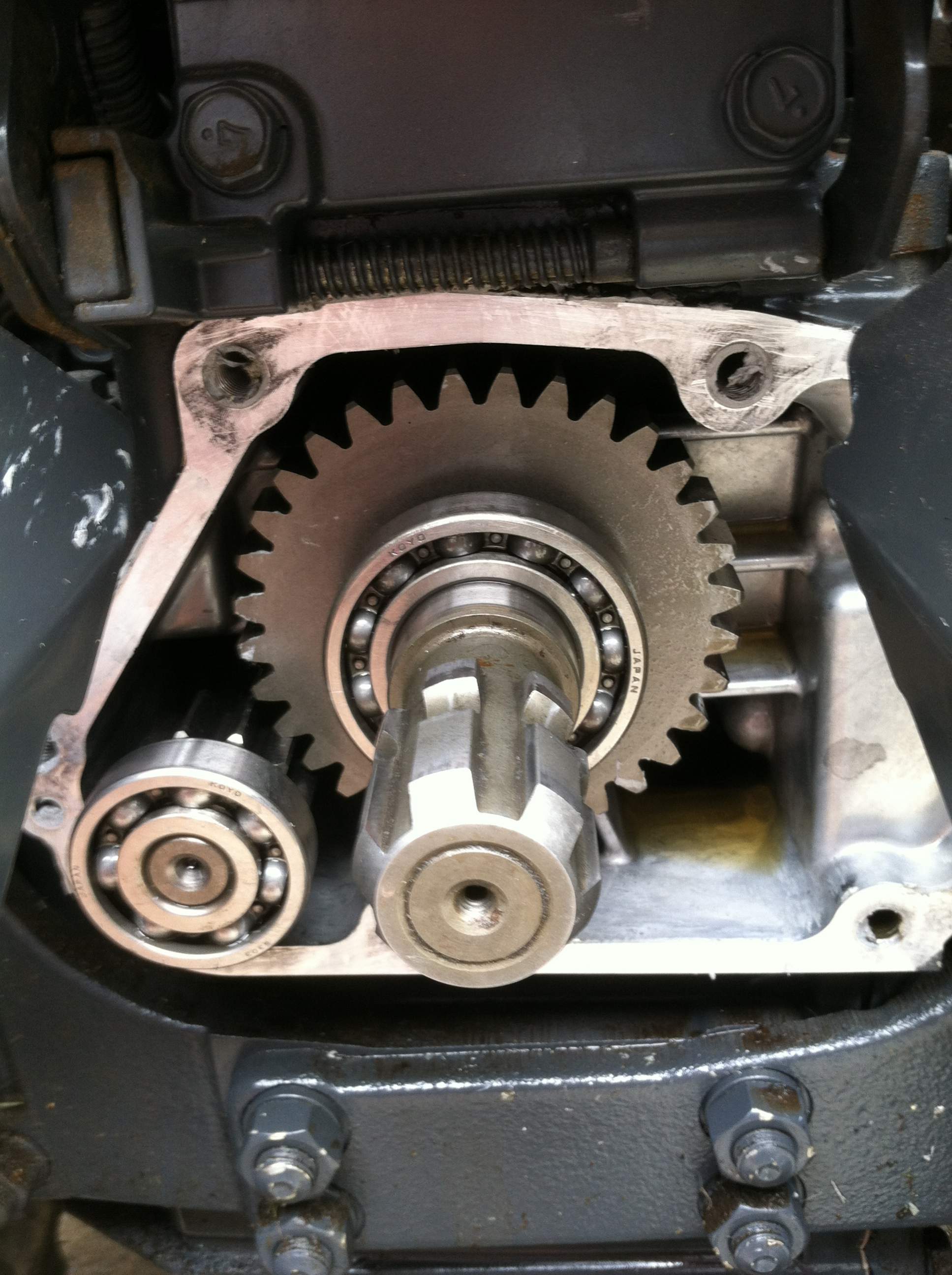

Finally got around to replacing the stub shaft. When I pulled the cover, the stub shaft came free of its bearing housing extremely easy, but the lower shaft (the gear on this shaft rotates the stub shaft) pulled out a bit since its bearing housing on the stub shaft cover was a bit tight.
Now, I can't get the lower shaft to push back in to its normal position to re-install the cover. The PTO selection lever has something to do with this, as it will move between the Rear PTO Only and Mid & Rear PTO lever positions, but will not move into the Mid PTO Only position.
No matter what I try I can't get it to push in far enough to re-install the cover.
Need some help on this one please. Any thoughts?

BTW, I have the shop manual and although there is a diagram of the internal workings, it's really of no help to explain anything. Any thoughts on getting the other shaft back into place???? Appreciate any help on this one.
   / Replacing Rear PTO Shaft - BX24
#9
PTO Stub Shaft 2.jpgPTO Stub Shaft 3.jpgPTO Stub Shaft 4.jpgPTO Stub Shaft 1.jpg
Here are some pictures with the cover removed. First one shows the two shafts. 2nd & 4th show only lower shaft & bearing. 3rd one shows how much further the lower shaft must go in. looks to be about 5/8" to 3/4".
   / Replacing Rear PTO Shaft - BX24 #10
Can you rotate the mid pto shaft by hand then try pushing the rear engagement shaft into position? Reason I suggest this is that when I've had issues getting the pto selector to move where I want it from where it is, I engage the pto for a short sec or two to realign things. Usually will slip to the other slot after a few tries. Of course I do this with the engine running , but that would be a no-go for you at this point.
