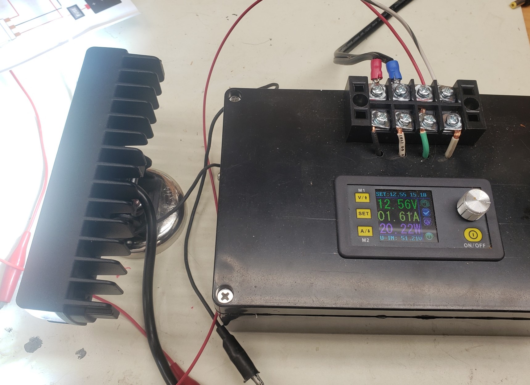

Yes I agree 100% Tinhack. The problem is I don't have a lumen meter but I can measure amps & voltage. The rear work lights that I bought were advertised at 40w each. They actually measured 20.2w with 12.6v applied (about 1.6 amp).
They are plenty bright enough for me. You should be able to get 3 to 4x the lumen output for the same wattage (LED to incandescent). At the very least these will give more light output at probably lower power consumption - even tho they say 25w. I'll measure their power consumption when I get them and I'll bet they aren't really 25w.
