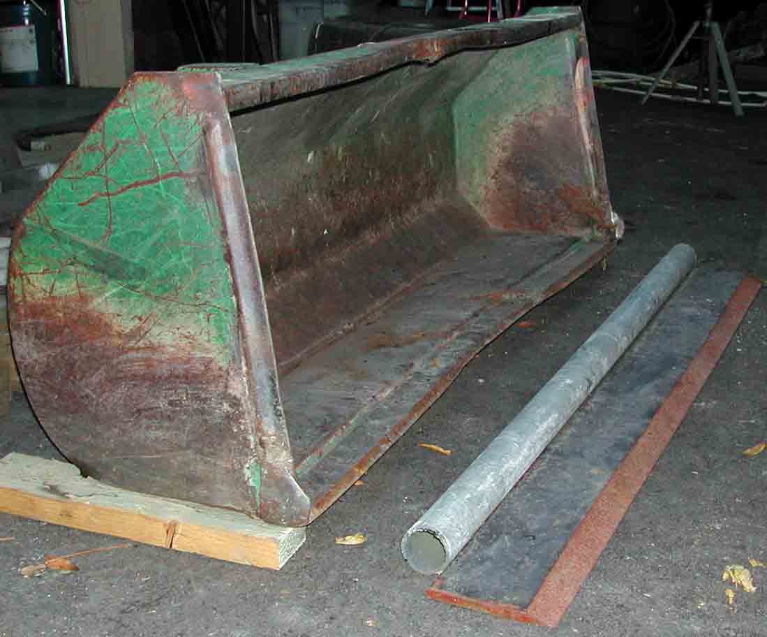

I have done one, but I also cut out the whole bottom of the carcass. That's much easier than
trying to straighten it.
I found some 1/2" x 6" beveled cutting edge at a steel seller, and it was 1/3-1/4 of what
2 tractor dealers wanted.
Anyway, I used a plasma cutter for surgery, and was not concerned about heat warpage.
If you use O2-Acet, then you will get more heat.
When welding on the new edge, I stitch-welded about 1" at a time, 6" apart. I used
1/8" 7018 rod at about 130A DC with a Miller Thunderbolt buzz-box. Very happy with
result. I have no idea how well flux-core MIG will work. No strongback used here.
I eventually put a continuous weld on both sides. I am not a weldor by trade, but I have
learned a bunch from experience about heat distortion in the past 15-20y.

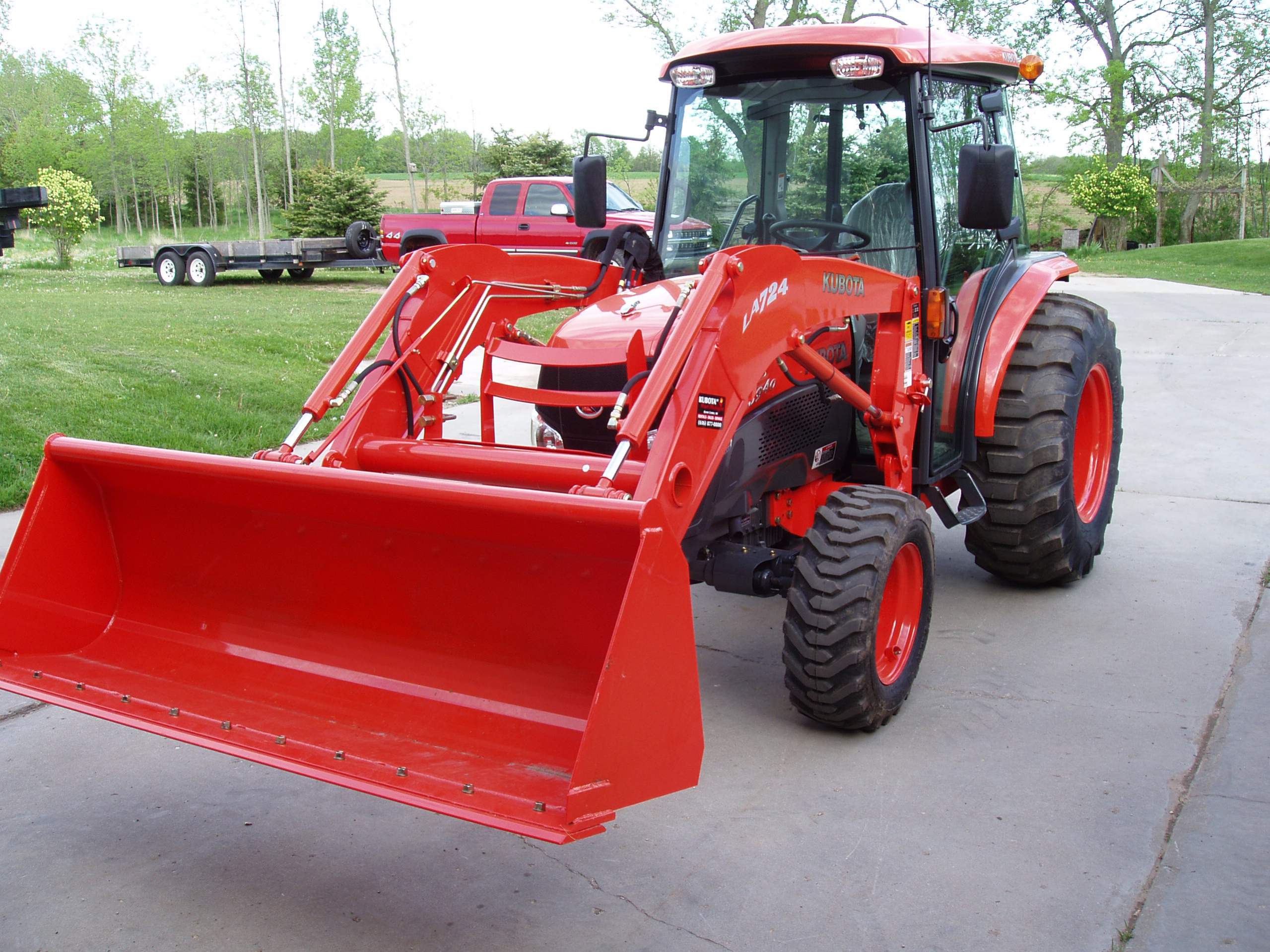

If you use your bucket alot, I would get a bolt on cutting edge, with the double bevel, it will last twice as long, and helps stiffen up the bucket. All you need is plow bolts and a sharp drill bit. When edge wears down, just unbolt it and flip it over.:thumbsup:
   / Replacing Cutting Edge #5
MY 724 was factory drilled and the first thing to go on it was a double edge!!! I should never wear out the original.
