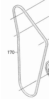

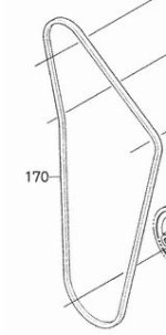

There are 4 pulleys, drive pulley, A/C pulley, tension pulley & a small idler pulley. I do not now which side to put the belt on this pulley.
   / Replacing broken a/c belt on Kubota M8200 Tractor #2
Something close to this.
   / Replacing broken a/c belt on Kubota M8200 Tractor #3
I would think if the idler pulley is a v pulley, the v part of the belt would run on it. If the idler pulley has a flat surface the back side of the belt would run on the flat side of the pulley.
