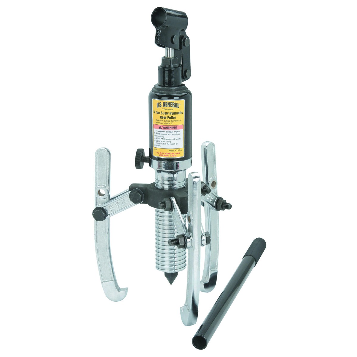

Fellas, I know I'm real late jumping into this thread but thought I'd share for anyone else who stumbles across it. I have an FTH-720, that had been sitting out 10 years. What I ended up using is a hydraulic gear puller from Harbor Freight. You have to take out grease fitting (I messed up one before I figured this out) and I also used PB Blaster in addition. I used the 5 ton version:
5 Ton Three Jaw Hydraulic Gear Puller
