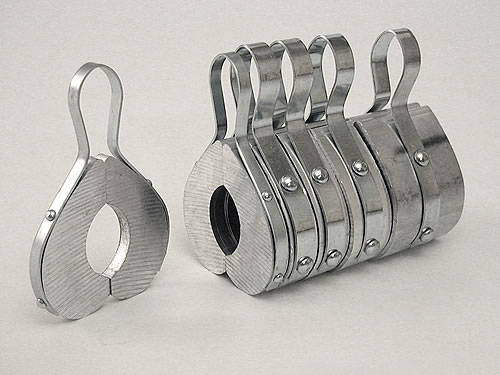

For setting the height ( drop.. whatever ), you get clamp on donuts to go on the cyl rod so that it's can't compress fully. they make them in different thickness's also called cylinder limiters.
http://www.catford.com.au/images/B6436wm.JPG
http://www.depthstop.com/imgs/block_set_a.jpg
/ replacing a single acting cylinder with double acting #5
extend cyl, clamp a few on.. drop cyl.. see if it's too low or high a height, then lift cyl again and swap in more or less donuts of different sizes till you get it to ride where you want it.
once you have your set picked out, leave em on... you can still lift and pin to transport height.
if you later decide to go lower.. just pull one/few while in transport and see what you got.. etc.
they are cheap.. sold in sets at farm stores... lots of implements with lift wheels and folding decks or wings etc use them.

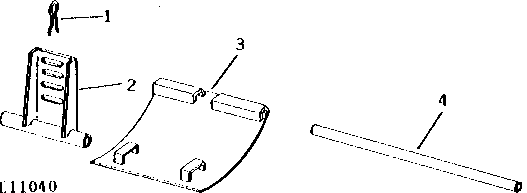

Actually if SA cyl. rod seal,hose or male coupling isn't leaking you should be able to lower cutter bar to desired height put control valve lever in neural then cutter bar should stay at set height. This depends on if control isn't leaking internally. Soundguy's depth stop clamps will insure cutter bar stays at set height or you could set depth shoes that came on your Mo-Co.
