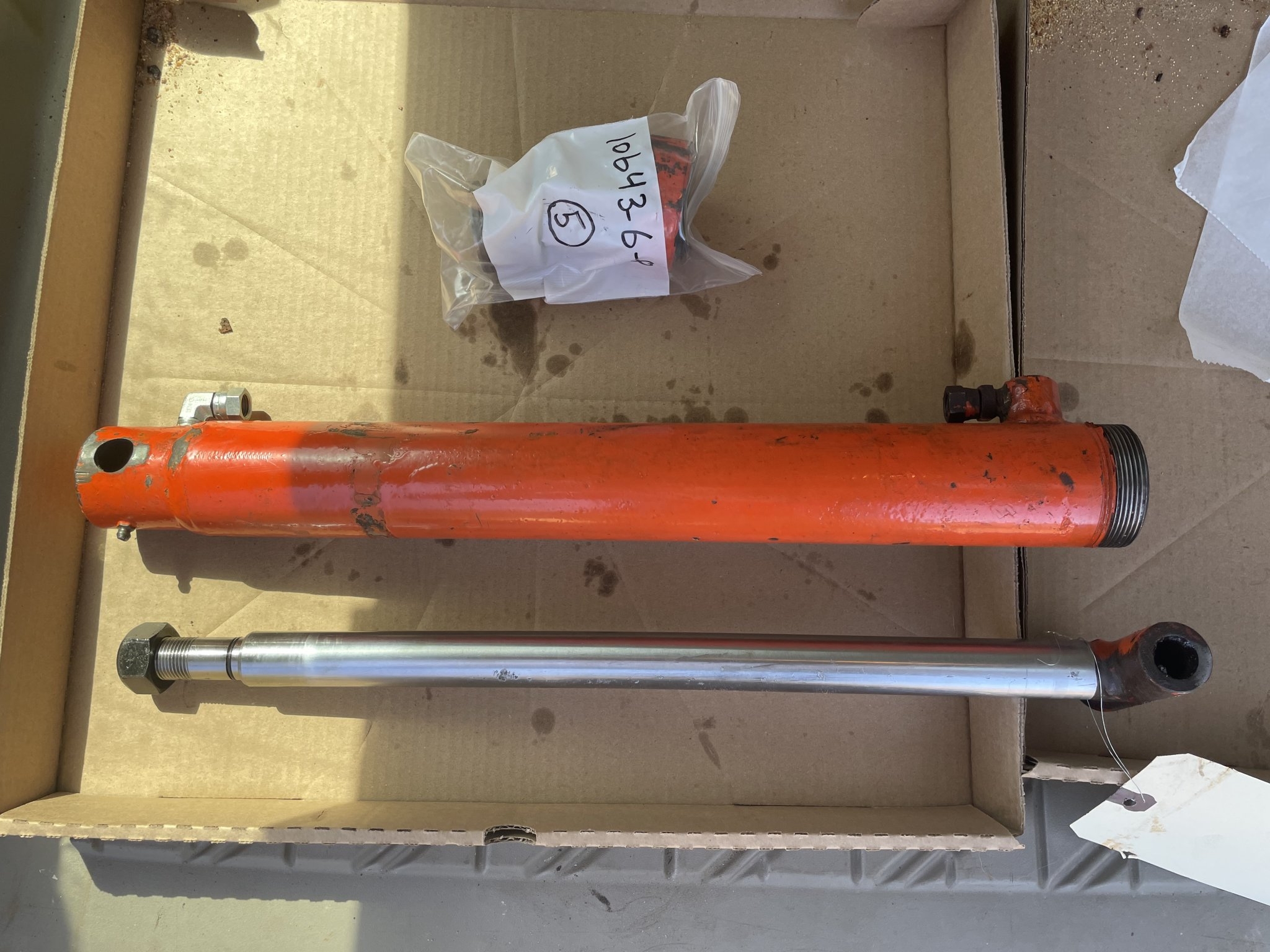

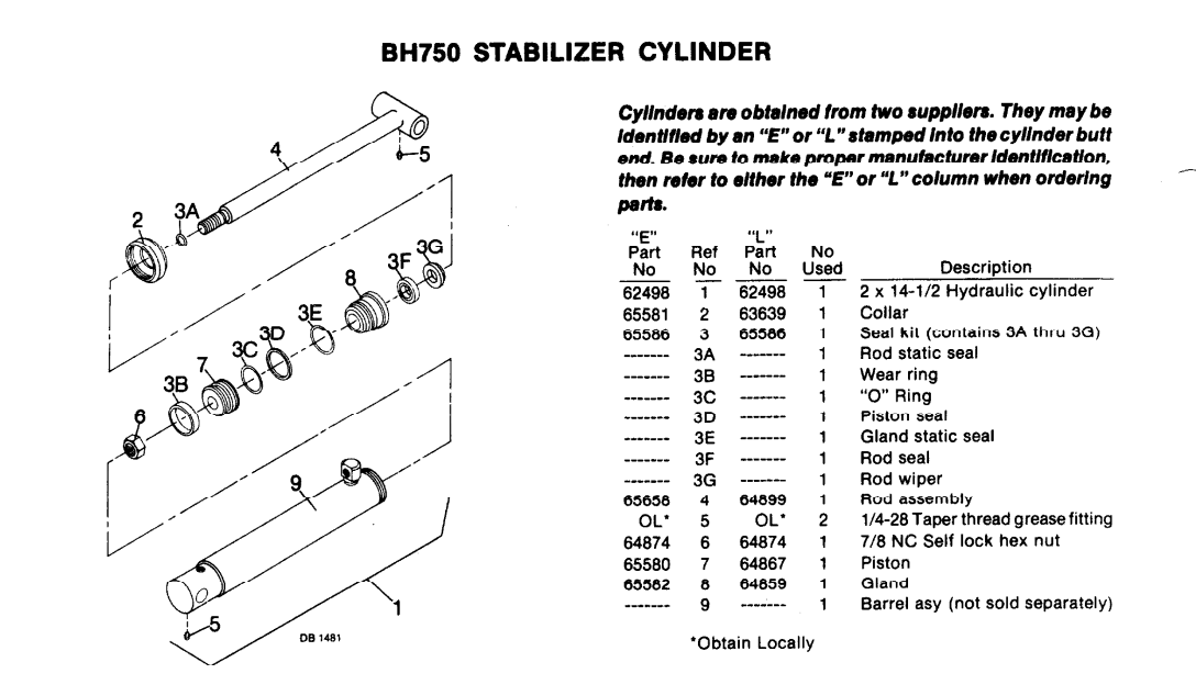

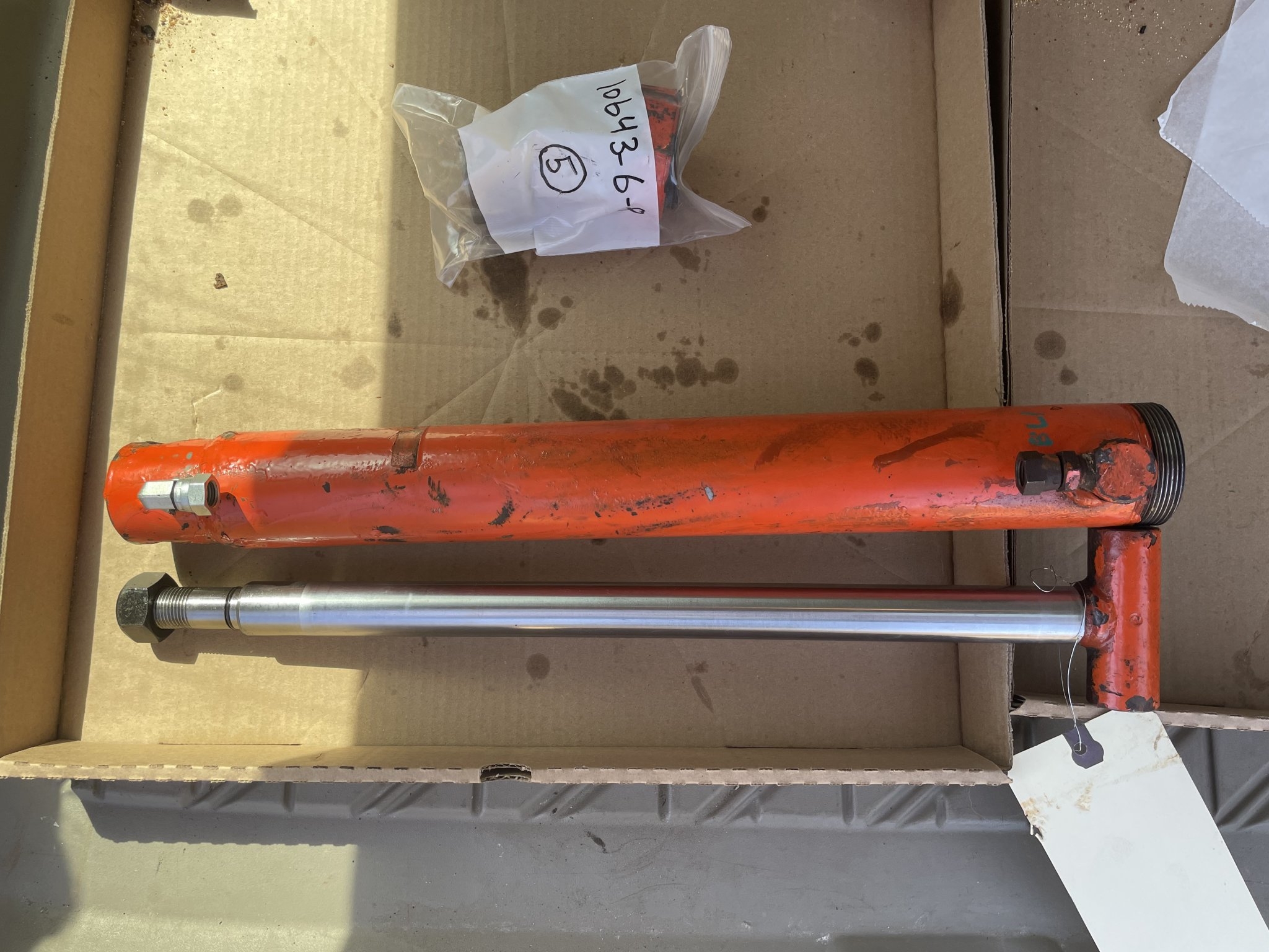

So both my Woods Woods BH750-3 stabilizers are shot, beyond repair according to the cylinder guy. The Woods OEM replacements are $900 each. Any experts out there able to help me figure out a replacement hydraulic cylinder from one of the third party manufacturers?
Original Woods Part #62498
HYD CYL DA W 2.00 X 14.50 - Price: $935.54
I have to believe there is are alternatives?
Thanks in advance
Jacques

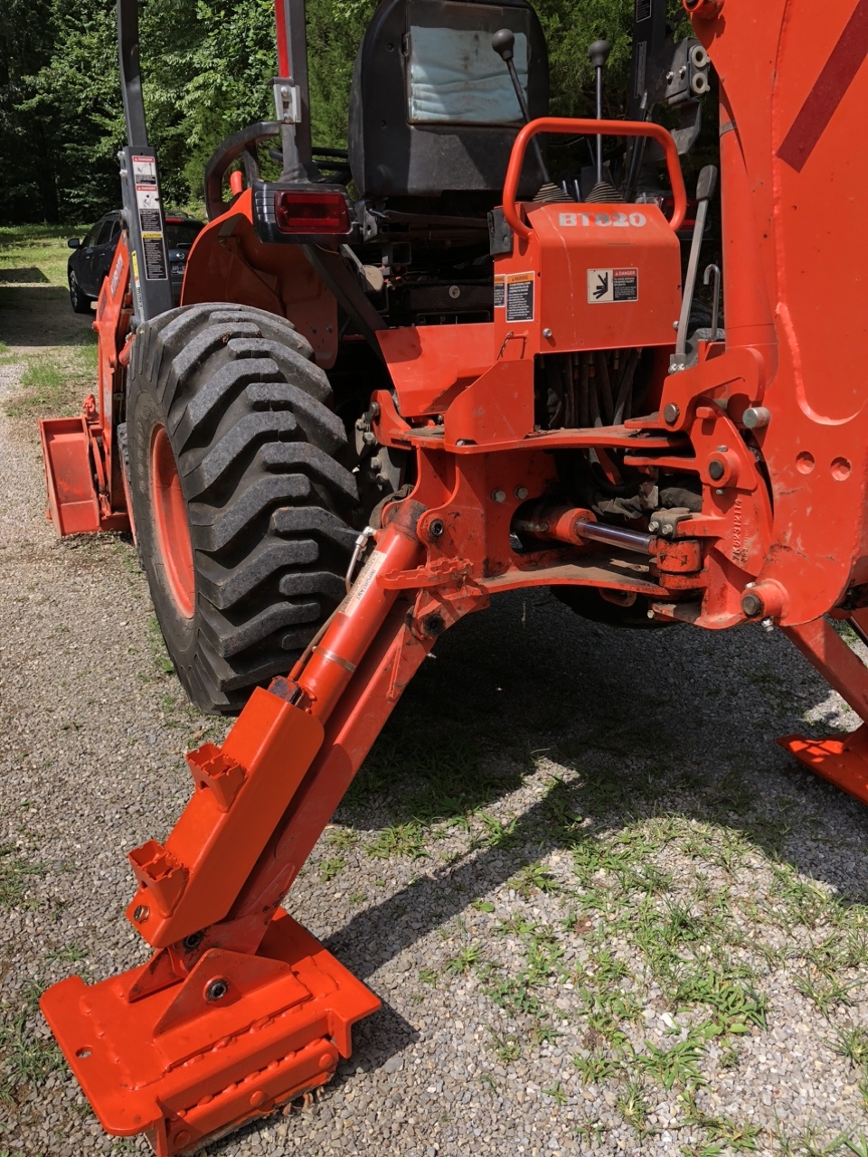

Here's what it looks like

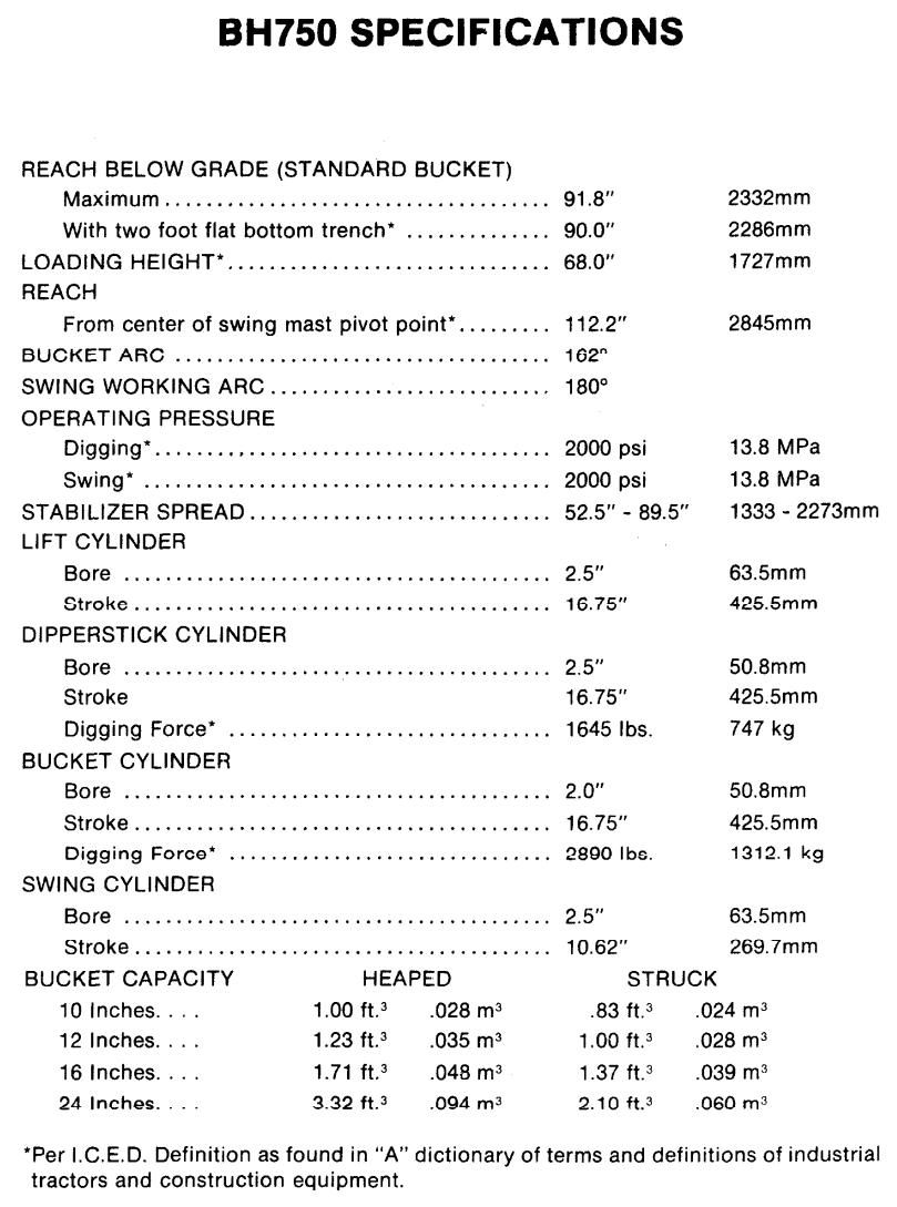

Specifications of the BH750
   / Replacement Stabilizer Cylinders for Woods BH750-3 #5
What's wrong with it? Scored barrel? Bent rod?
EDIT: The specs above don't mention the stabilizer cylinders.

I cannot find more detailed info other than this HYD CYL DA W 2.00 X 14.50
   / Replacement Stabilizer Cylinders for Woods BH750-3 #7
Good cylinder shop should be able to repair or make cylinders cheaper than that.
May need some cylinder guards.
