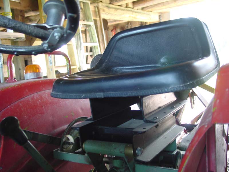

Here is a pic of my home-made seat mount.
4-pcs 3" channel iron, 2-pcs 2x2x3/16" angle iron,
a chunk of plywood, and some machine screws.
Stacking the channel irons gave me a few extra
inches of height. I'm only 5'11", and the OEM seat
mount was killing my back AND my knees.

#13
nice set-up... I'm shorter than you and I'm constantly banging my knees into the dash, etc.
Thanks, everybody fr your suggestions!
Tony
