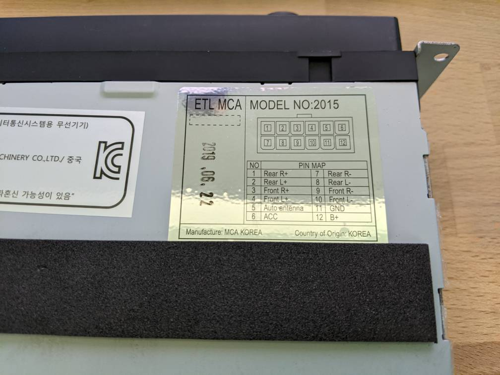

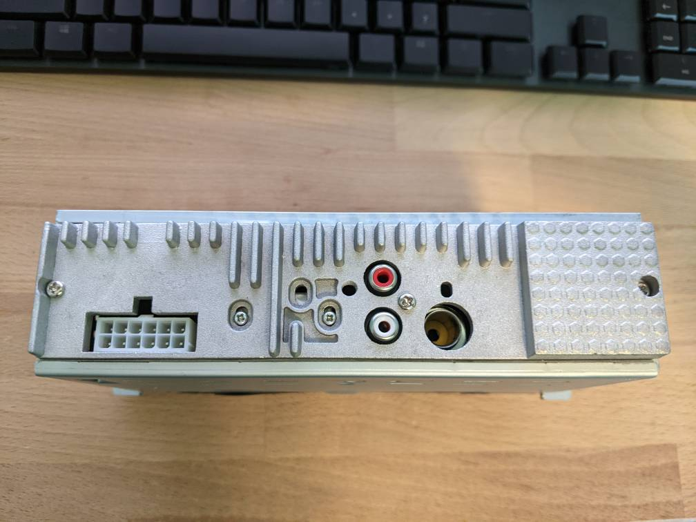

Well I took the radio out today and it appears it just uses the standard aftermarket radio plug that all the ones at Walmart use. I'm guessing most aftermarket ones use that same plug.
It looks like it uses a 12 pin molex style plug with 7 of the wires connected. I will attach pictures of the wiring diagram it has once you take the unit out for reference if anyone else happens upon this thread in the future.
Also after taking it all out, turns out the factory radio DOES have Bluetooth after all. It just has a dumb/odd pairing procedure. It does not pair like most of the Bluetooth things I have used where you push and hold the power button to put it into a pairing mode. It automatically goes into pairing mode when it turns on but it gives absolutely no indication. But after you turn the unit on if you search on your phone for Bluetooth devices it will find it.
Once you have a phone paired when you switch modes in addition to "line" there is also "bt" but that does not show up at all unless you have your phone connected, so it didn't give any indication it actually had a Bluetooth mode.

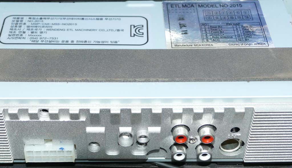

Interesting - the radio my Kioti was equipped with looks to be the same as yours, except for the stereo RCA output sockets on the back:

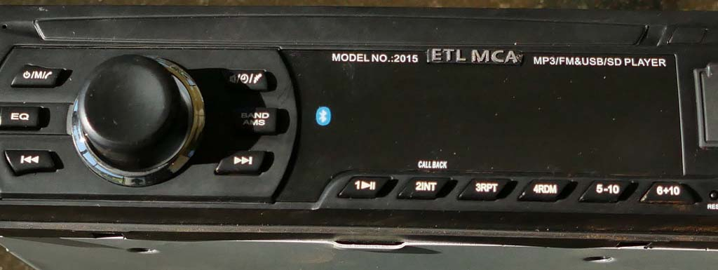

Also a Bluetooth symbol on the front:

Very interesting! Yeah mine definitely doesn't have that bluetooth symbol on the front and the manual didn't have tat section about the pairing.
Thanks for sharing!
