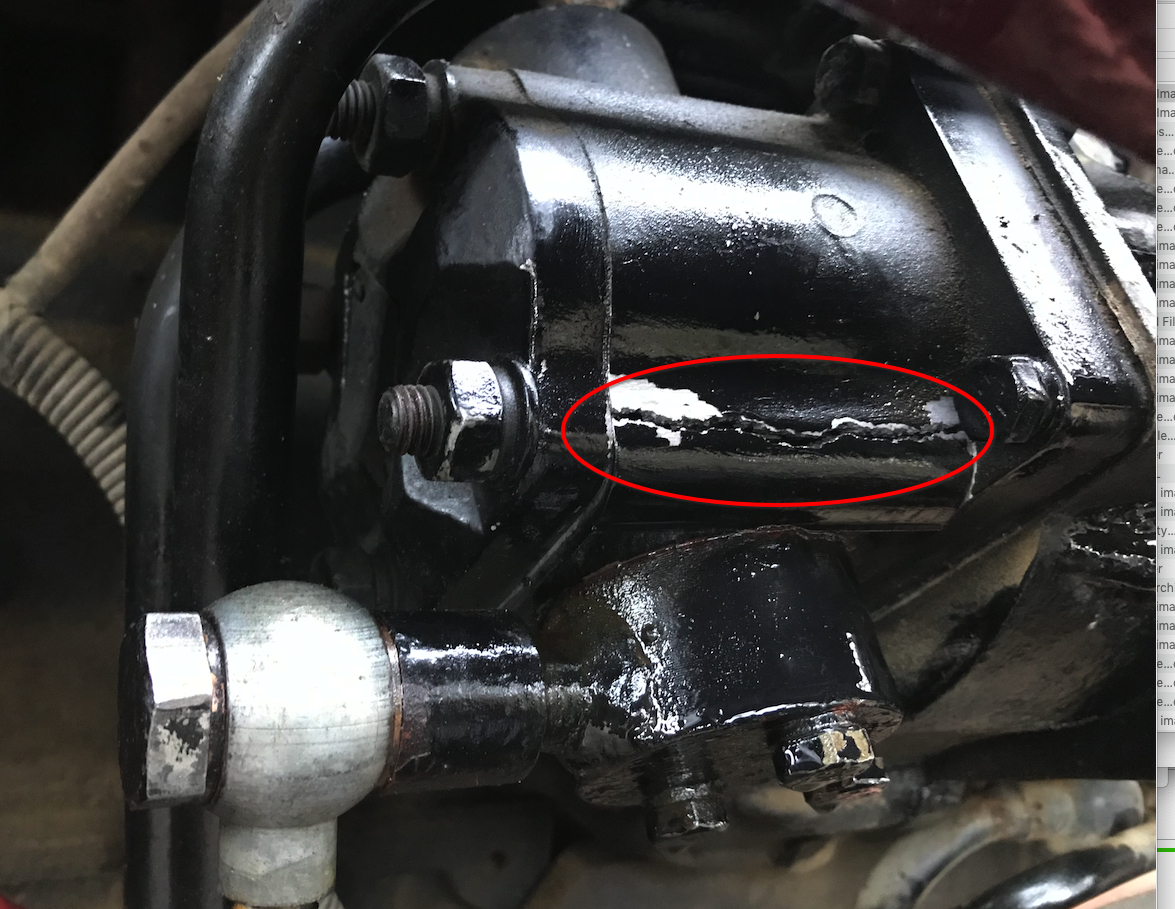

I had to replace some broken hoses on my Taskmaster Tractor TM438D (SN 841262). After installing the new hoses and starting the tractor hydraulic oil came spewing out of what appeared to be the hydraulic pump (Photo attached). I think when replacing some of the hoses they may have been connected to the wrong port on the control valve for the loader creating excess pressure somewhere which cracked the pump. I want to replace the pump now and I am finding it difficult find a replacement. The part number per the parts manual that came with the tractor is CBN-E306B. Can anyone please advise where I might locate a replacement hydraulic pump for this tractor? Also if any advice could be provided regarding the correct routing of the hoses from the pump to the control valve it would be greatly appreciated.

I would try 1 of the advertisers listed in here
https://www.tractorbynet.com/forums/chinese-tractors/172108-jinma-tractor-dealers.html
You may also want to try FarmBoys They mainly specialize in Rhino tractors but have access to china suppliers for other brands also

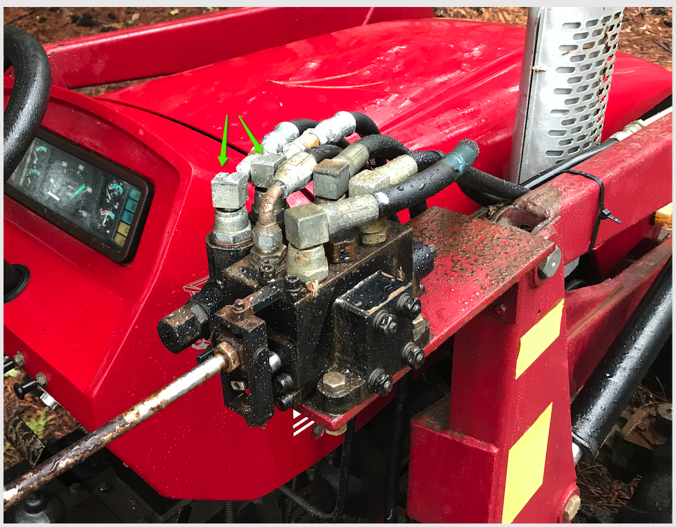

How many lines or hoses connect to your valve assembly?
If 6 then:
Plumbing connections:
From pump outlet to inlet or pressure port of the valve.
Valve outlet or tank port directly to tank
Remaining 4 are for loader functions
If 7
Then you have the power beyond feature. This port can be labeled multiple ways. This line supplies oil to three point hitch or rear mounted directional valves for rear remotes.
Post some pictures of your loader valve & I am certain that someone can tell which ports are what on your valve.

Here is a photo of the joystick control valve for the Front End Loader. I am trying to determine which of the two ports as indicated on the attached photo is the "In" port and which is the "Out" port. I think that because these were reversed it may have created excess pressure causing the pump to crack. Is there anyway to determine which is "In" and which is "Out"?

In that picture my guess is tank is closest to the end by the joystick and pressure or inlet is the other port that you an arrow by.
On most valves there is some form on label in the casting. Have you looked carefully at all the surfaces by those ports?
   / Replacement Pump for TaskMaster 438d (DongFeng) Tractor #6
Your in port well be next to the relief valve. So if I understand ray right he is right ( left handed arrow}.
