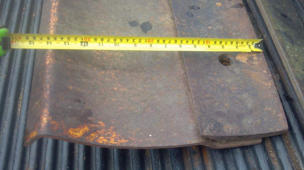

The cutting edges do wear. Slowly in dirt and faster in gravel. Most are 6" wide and 1/2" thick. Some are 5/8". Usually they wear unevenly, on the ends or in the middle. If it is good and flat where it contacts the ground it probably isnt wore much. Cutting edges are replacement parts and readily available. Figure $20 to $25 a foot ball park.

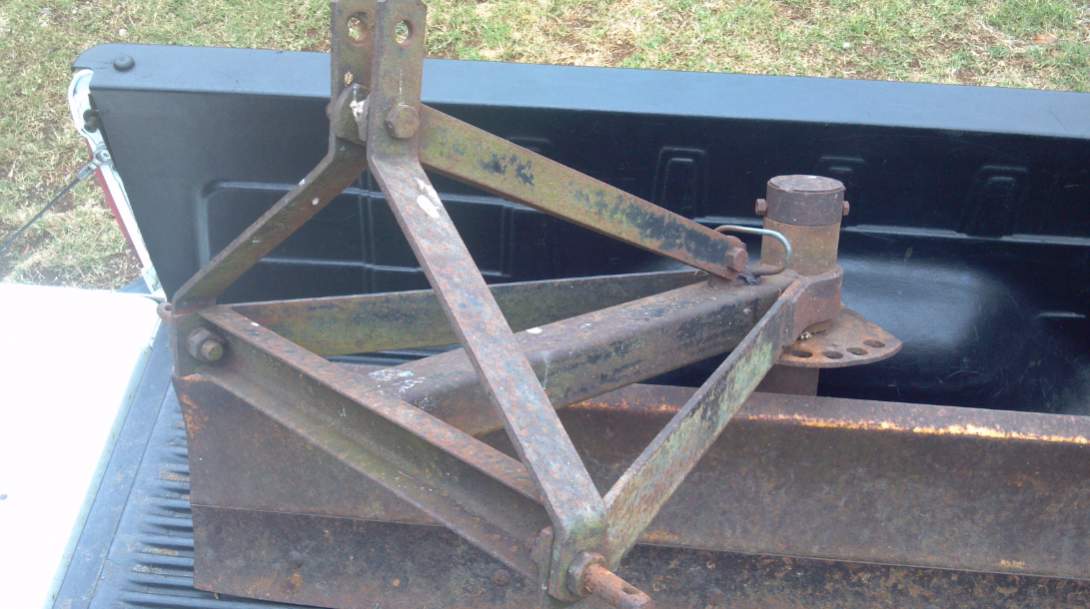

edit: If they bend it is usually around the 3 pt hitch connections and bracing and not the moldboard.

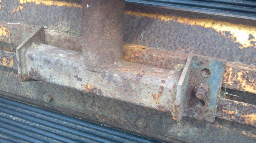

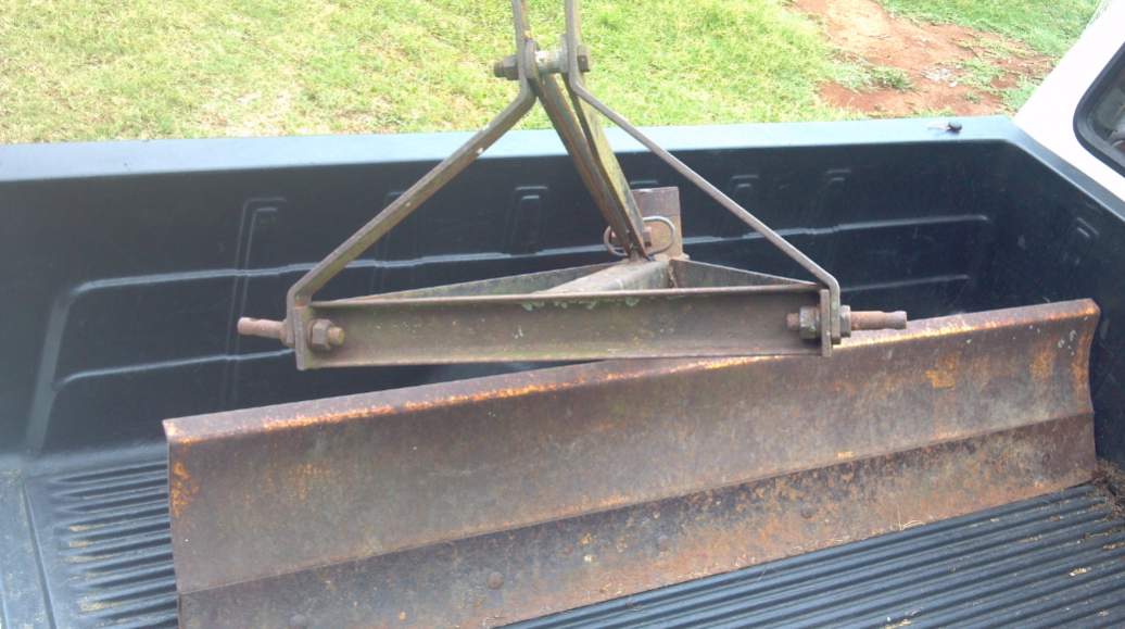

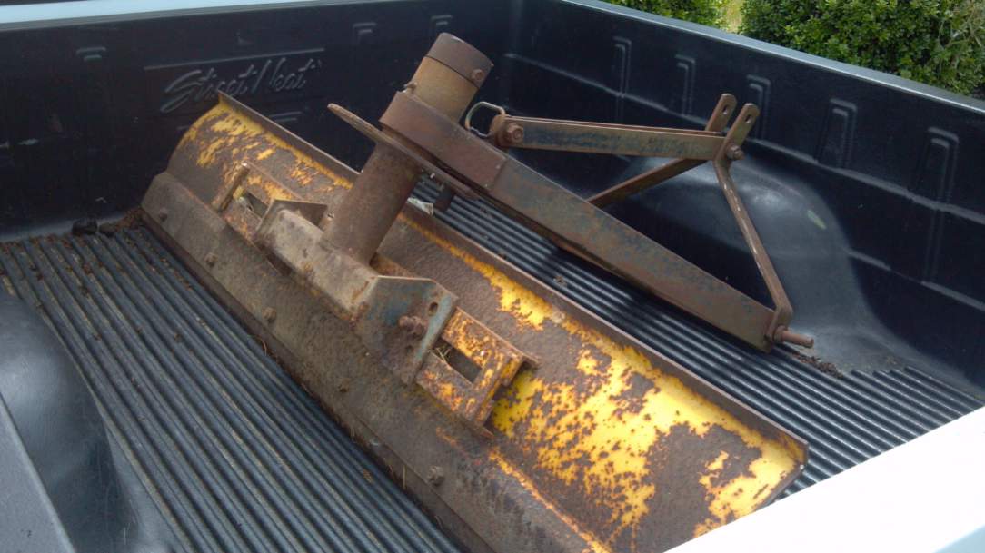

Went and picked up the 72" grader blade this afternoon. It used to be yellow, maybe King Kutter? I've found pretty similar designs online, but not this exact one. I paid $100. The 1/2" x 6" cutter blade is almost new - just a little wear on one side on the outter 6 inches. The only other blemish on the machine is one of the two braces from the pivot point to the top-link pin is slightly bent. I wish I had a big press to bend it back straight...
It has the side-to-side off-set as well as the ability to tilt the blade up/down on the left or right.

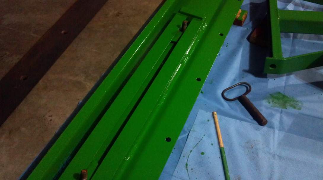

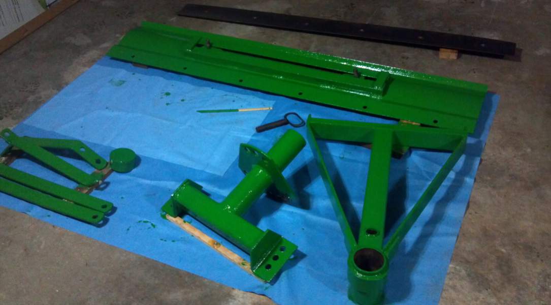

I cleaned the whole machine, then brushed it with a wire wheel. Put a coat of paint on this evening. I have new plow bolts for the blade, grade 8 bolts for the rest, and new and lift pins.
