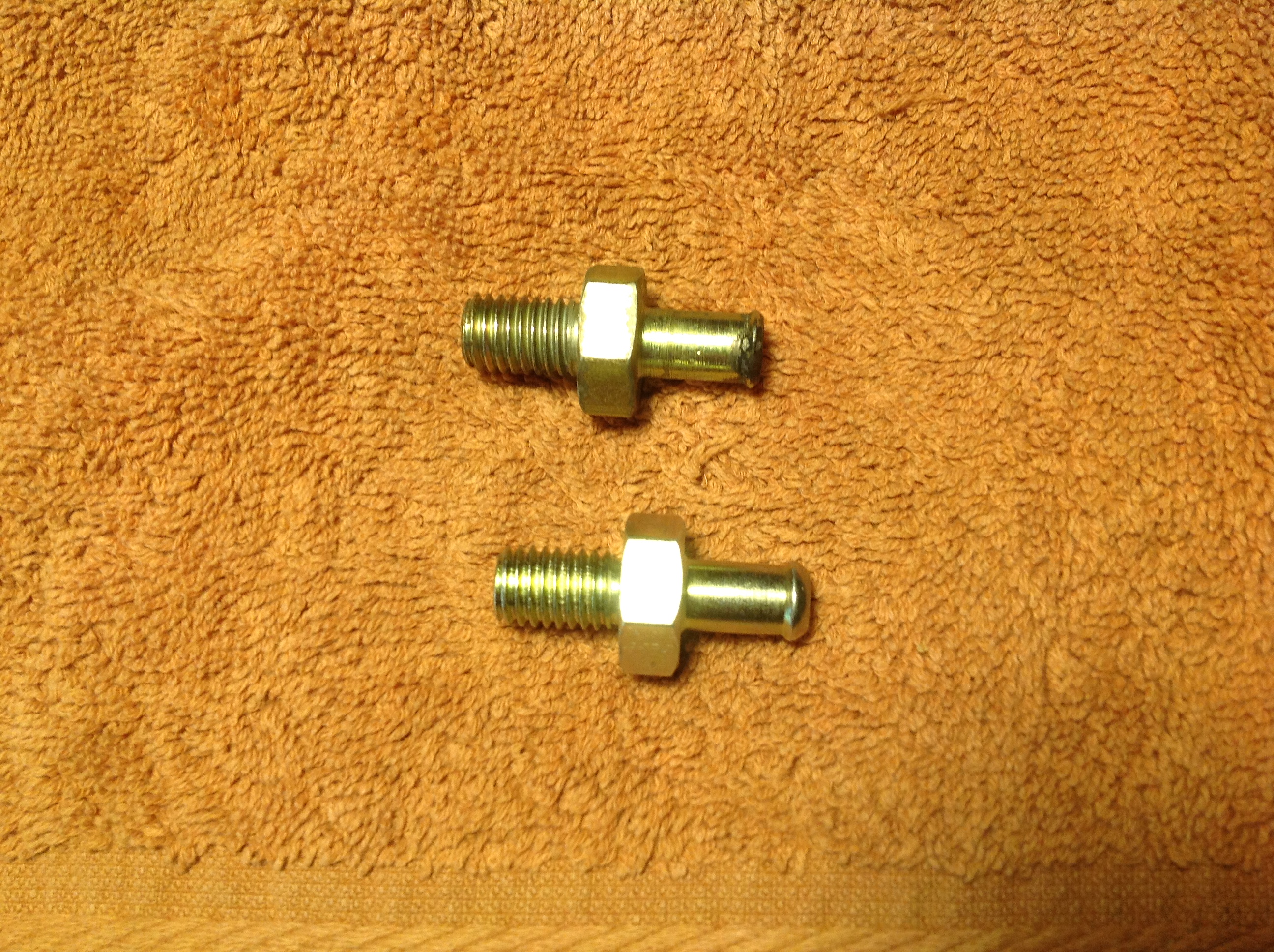

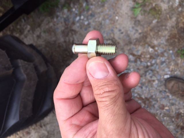

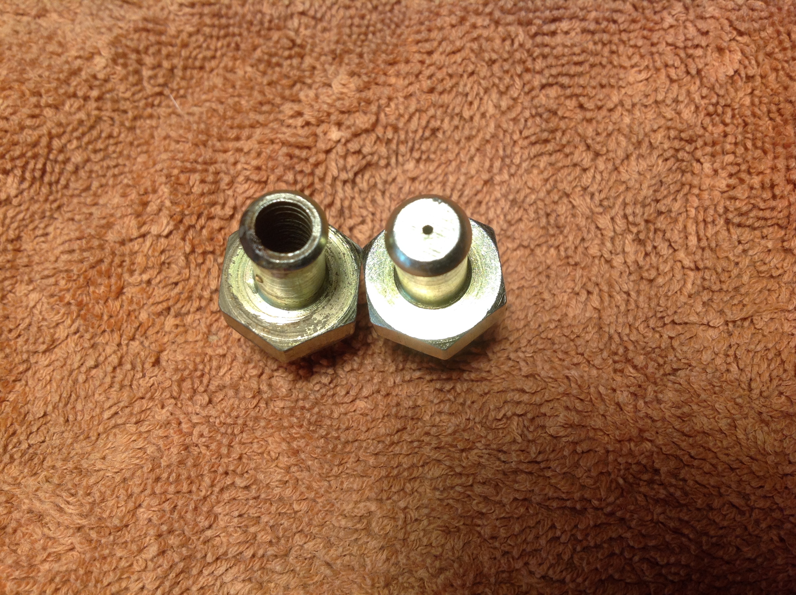

I received the new orfice fitting today and I was very surprised.
Here are some pictures of the old one and the new one.
As you can see, the new one is way smaller then the old one.
Here are the numbers:
Original orfice: 0.225 inches a #2 drill
New orfice: 0.041 inches a #59 drill
You need a 17mm wrench to remove the fitting.
PLEASE NOTE: There is a small washer under the fitting, be careful or you will loose it.
Only time will tell if this will fix the problem. I do not exactly get a warm (no pun intended) fuzzy feeling about this fix. Only time and running the tractor will tell.

It'll work. Very similar to the original prototype restrictor that I have in my 3550 machine. That top hose is just a vent hose for air in the egr cooler, not ever supposed to flow coolant, just bleed air. It's amazing how much cooling capability that little hose actually has. Unless the engine is really working, it's not actually putting out much heat and that little hose without a restrictor is enough to drop the temp.

I received the fitting last Friday I believe and installed it with no problem. I was amazed at the size of the hole in the new one. I was truly doughtful about this "fix", I just couldn't believe that a 1/4 inch hose could carry enough coolant to prevent that big engine coming up to operating temperature. Anyway, I had a chance to do some things with the tractor today. I ran it and kept an eye on the temperature gage. It took a while but the temperature came right up into the operating range. Learn something new every day.
