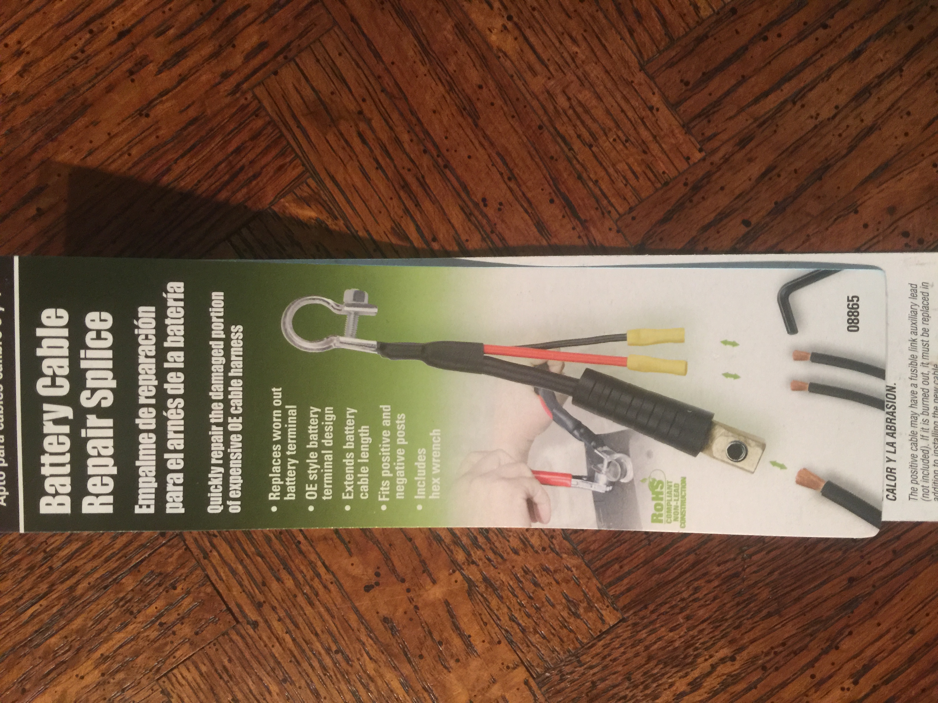

I found this Battery Cable Repair Spice at O'Reillys Auto Parts store. It was a perfect solution because it allowed me to extend the main positive cable as well as the smaller red wire that clipped into the connector.
   / Replacement Battery Terminal Clamp?? #9
Can you post a picture of it installed. When I replaced my battery I went with ones with posts to front - this would have come in handy for that extra inch of cable I needed.
