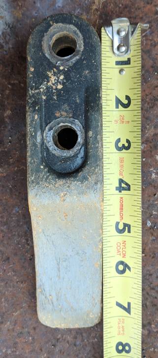

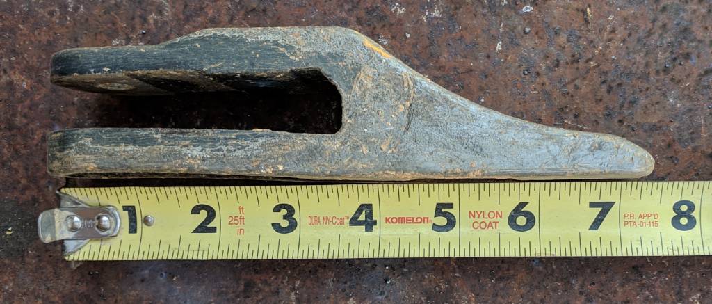

My 3520h's BH76 backhoe's teeth encountered some rough action today and I fractured a couple of them... I'm an idiot and wasn't too gentle on some big rocks.
Has anyone replaced their teeth? My bucket has 4 teeth, each is 7.5 inches long, 1+5/8 inches across, and has two bolts holding it to the bucket, with the bolts 1+15/16 inches from center to center.

Do you have a picture of the teeth? My much bigger backhoe teeth aren’t that long. In any case changing backhoe teeth is pretty easy.

It's not the changing I have a question about, it's finding an appropriate replacement
For the moment, I did my patented amateur welding job on the two broken ones... I'll try to avoid dropping the bucket... and hopefully my dental work holds up for a bit!

Did you get this resolved?
I ordered and received 2 backhoe teeth (one was a replacement for a cracked one and the other is a backup part) from Dave's Tractor where I assume you bought yours from.

I also ordered a couple from Dave's.
They seem pretty pricey IMO; I'll keep that in mind in the future when I'm tempted to abuse the backhoe and hopefully will think better...

Would these be better for you? You prolly need to adapter to go along with the tooth. B.
Free Shipping | Twin Tiger Tooth | 717321ef |717321 | Earthforce Parts
I'd love to get something like that - both bolt-on shanks that the various teeth go on are the wrong hole spacing (ours are about 2.125" / 54mm). I suppose a new hole could be drilled, but I'd be concerned about weakening the bucket edge. I haven't found a bolt-on shank with the right bolt spacing yet.
