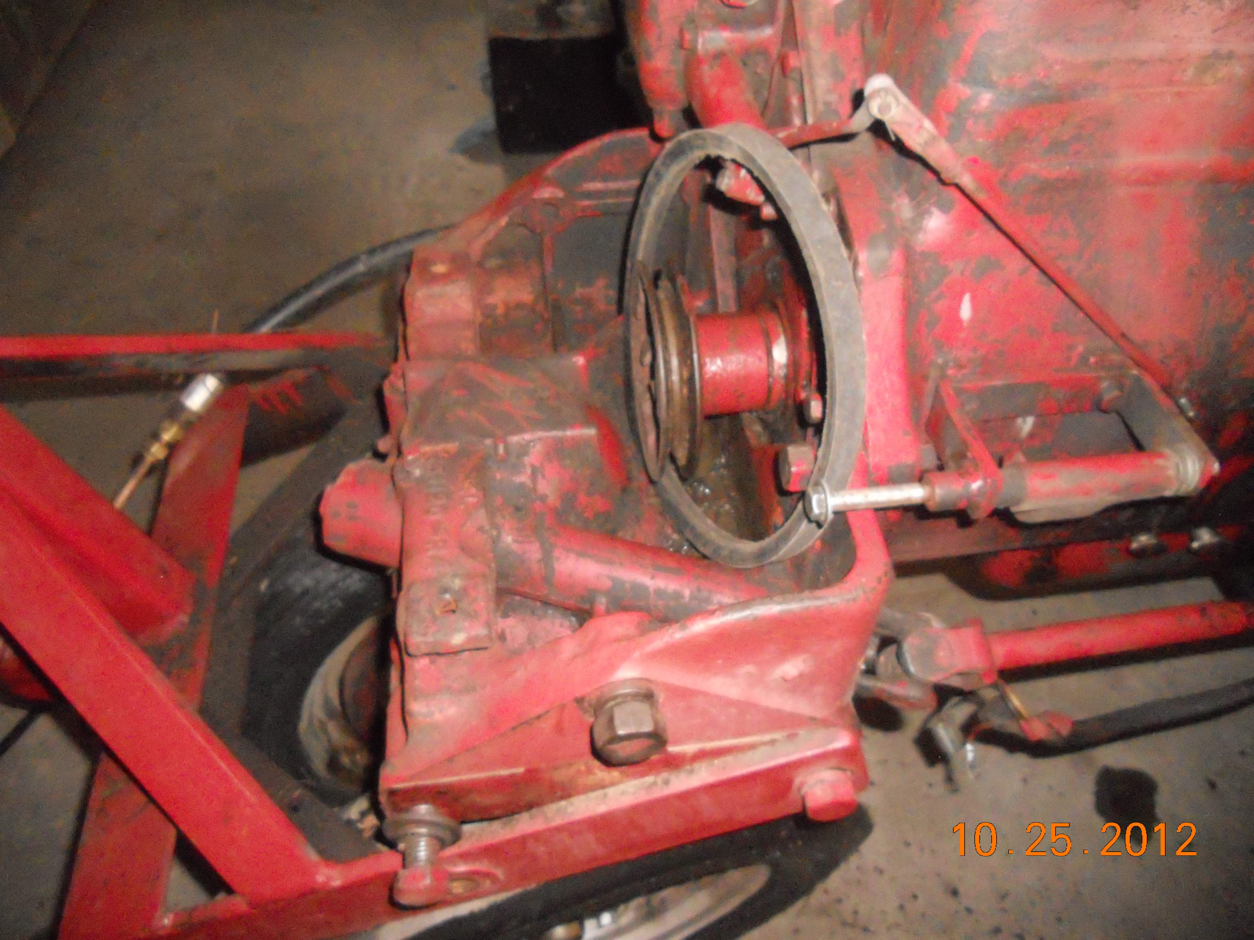

My Farmall C operators manual and IT shop manual do not have names or part numbers for what I need help with so please refer to attached photos. Two questions.

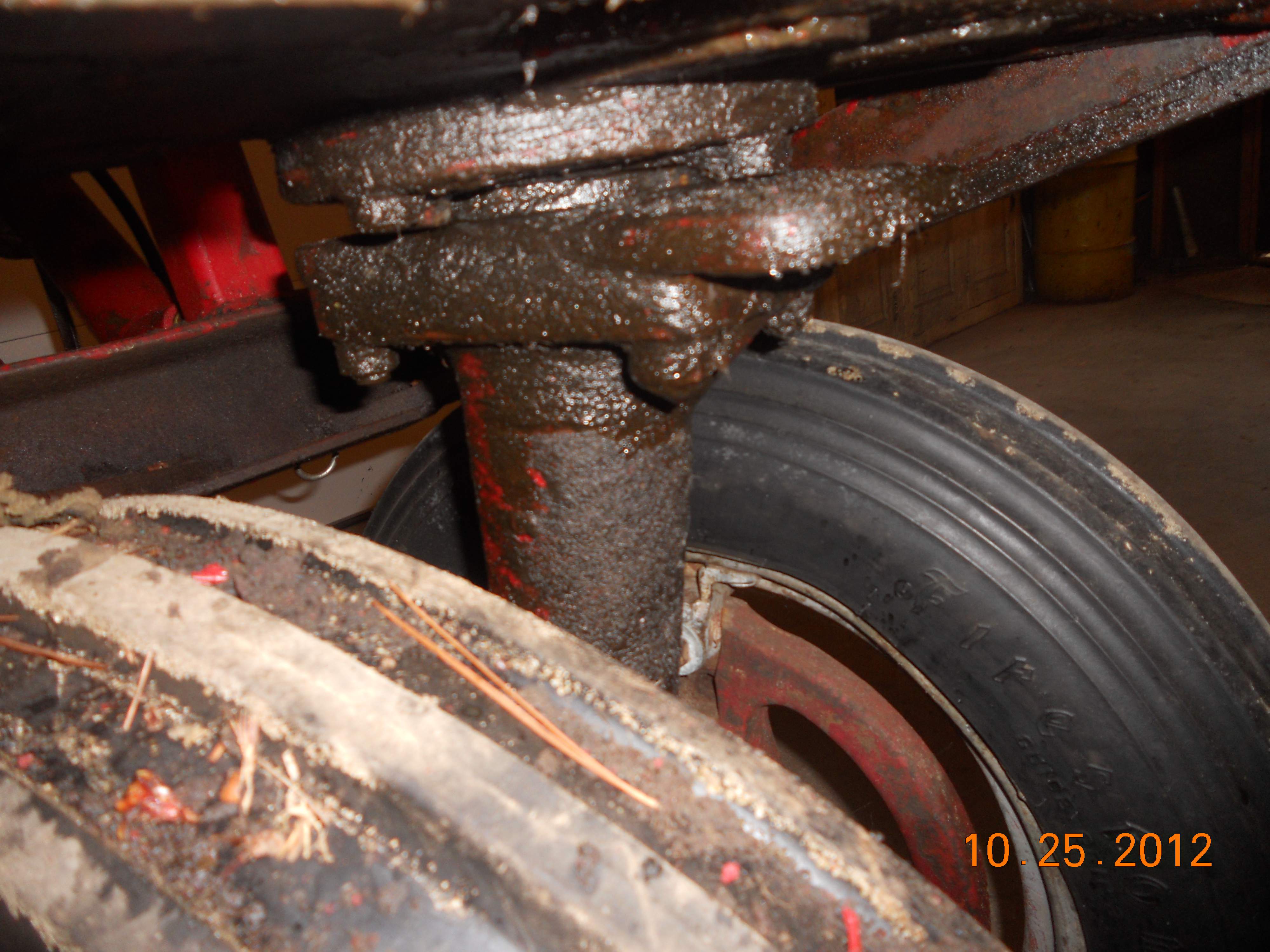

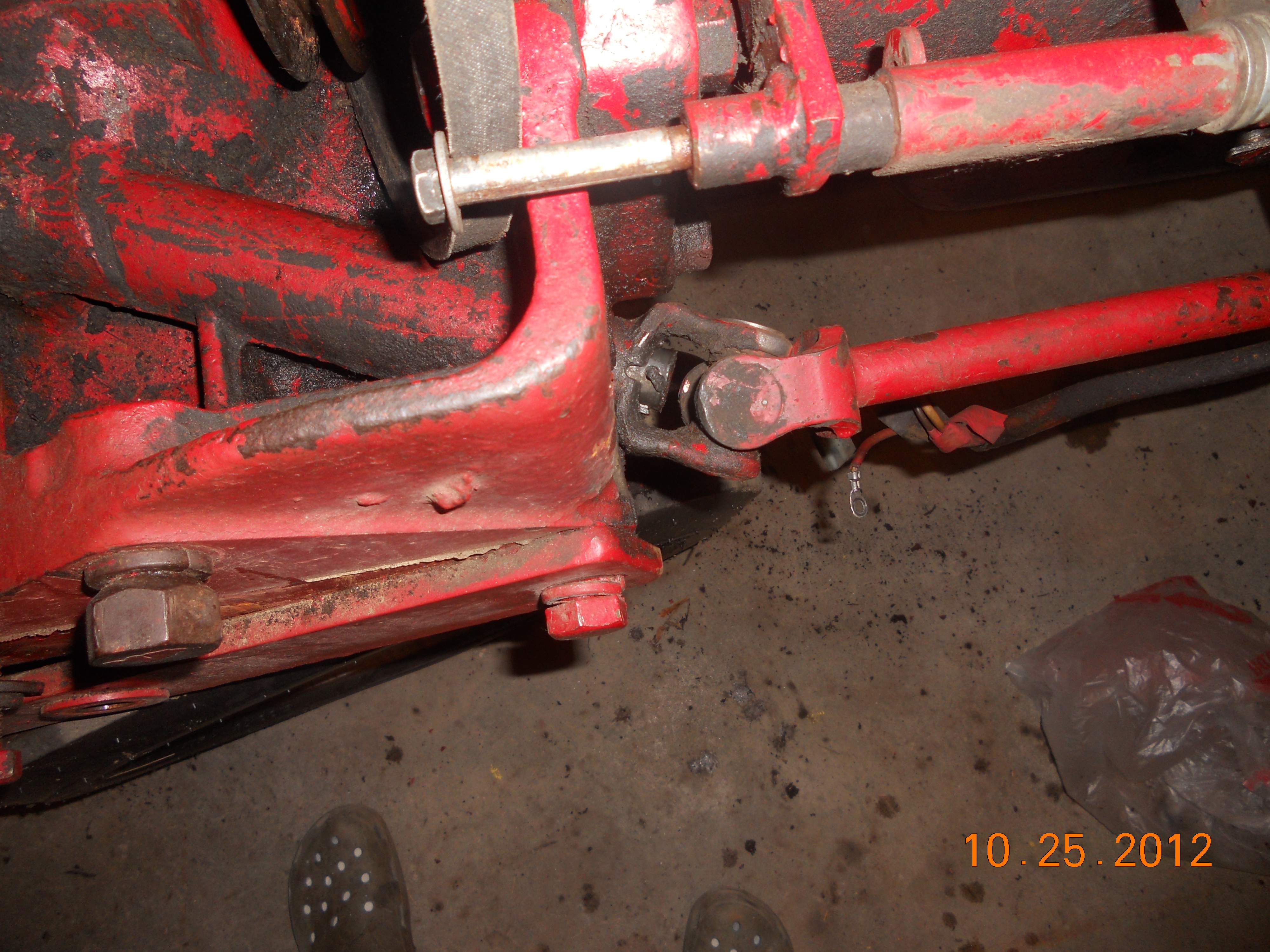

The front axle is covered in oil (Photo # 3) that I am guessing leaked from the housing the axle inserts into because the housing is empty of oil (looks like it holds a quart or so of oil). In addition my guess is the seal in the housing that the steering rod connects to (photo # 2) needs to be replaced too since that is empty of oil too.
Question # 1 Does anyone have a name and part number for these two seals so I can shop on line for replacements?
This is what I propose to do and if some one has tackled this before let me know if it is correct.
I will remove the tires and then front axle. Next I plan to remove the entire front bracket (photo # 1) from the engine that the front-axle inserts into. This will allow me to flip it upside down to clean it and make it easier to install new seal. Re-attach front axle, flip it up right and re-install or attach to engine (with someone helping).
[The other reason for removing the front-bracket is to have a clear shot at removing broken crank case pulley with bearing puller and install a new pulley].
Question # 2: look at photo # 2 where the steering rod connects in to the steering mechanism that turns the front axle. There is a cotter pin. If I remove that pin then I should be able to pull the front bracket straight away and off. Correct?

OK...here's the deal with the bolsters on the letter/number tricyles...don't use oil...it will, as you know, leak out below..suggest you pump a bunch of grease in there and drive it. Trust me, they all do that after 50 or 60 years. As long as you put a half a tube of grease and top it off with 90W gear oil, you will be fine, sooner or later the grease will slow the leak. Don't worry, your worm gear will be fine...good luck. BobG in VA
