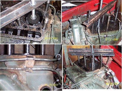

any one know what to use to get sleeve out. have been to parts ste has a wet sleeve puller. motor still in tractor so taking it some place is out. has anyone done this before and how hard of a job is it. hate to get in over my head.

I own a 1500D but haven't had to resleeve it yet. However, many years ago when I was teach Vo Ag, a kid brought an old Farmall in to rebuild. I made a sleeve puller out of scape steel and a long 1" diameter bolt. It worked pretty well. On the Farmall, once the sleeves was pull ~ 1/2" or so, they then came right out.

I pulled a sleeve out of a YM2000. I made it out of angle iron and a piece of all thread rod. It worked fine.

sounds easy will try to make something to pull it out

have been tring to pull sleeve. so far its come uo about a qt inch and thats it. have tring a slidehammer and then made a puller out of angle iron. still not comming out and other words of wisedom to try?

Have you tried chilling it? An icepack, or maybe even dry ice, may help it slide out easier.

Is the angle iron on the bottom slightly shorter than the sleeve OD? If it is ,more torque on the nut. With all the torque on the nut you are comfortable with, tap the side of the block, TAP with a brass hammer.

yes the angel is just on the edge. right now i'm using the slide puller and running a bolt up to an angel that is sitting on the head bolts. have it as tight as it will go. have wd40 on edge of sleeve. has been under presure all night and stil nothing is moving past the fisrt qt. inch.
