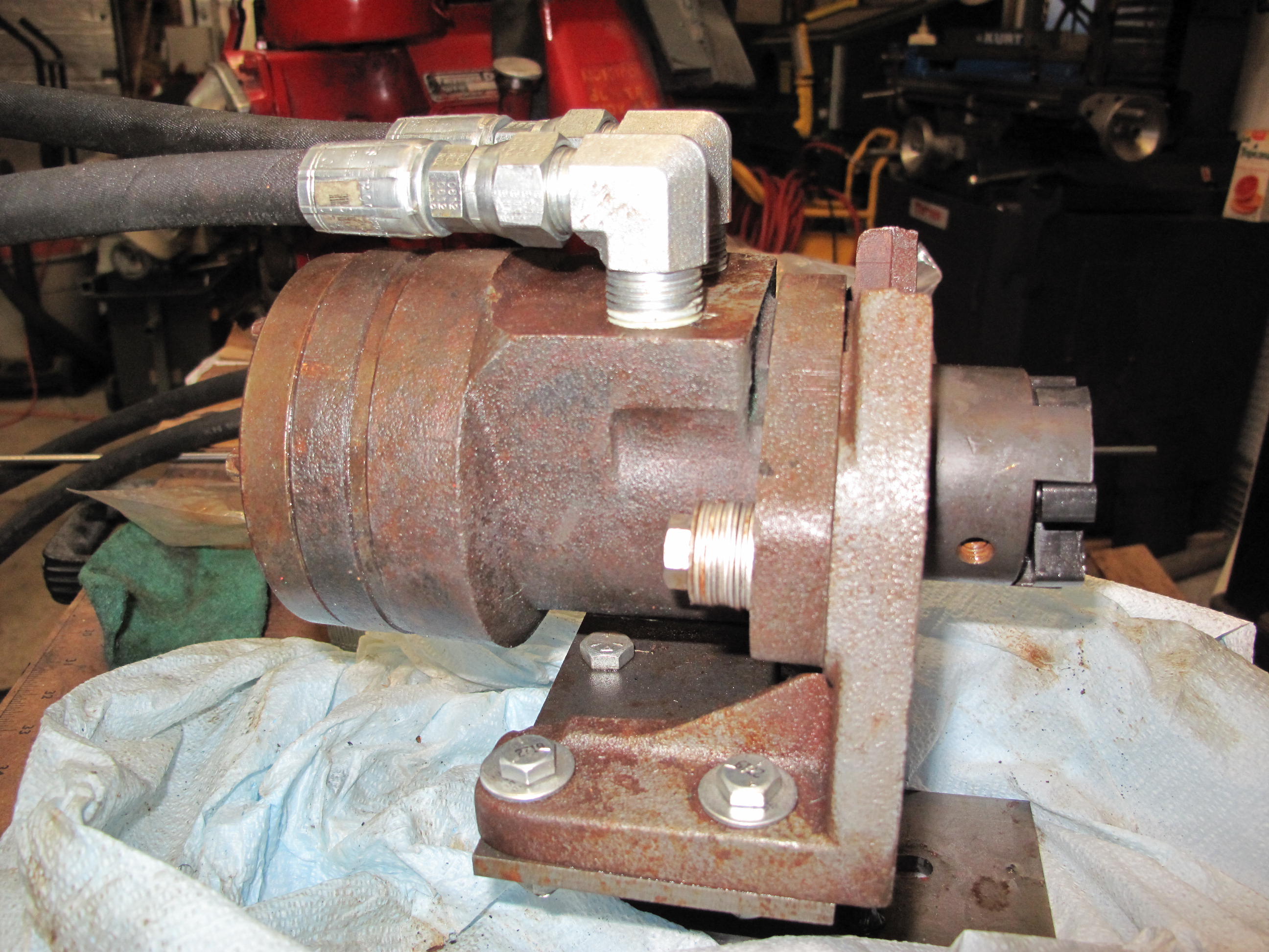

Hi
Well first I apologize for not giving more details but here is a problem bought this thing used it has no visible name or number on the body, name plate exist however is worn off blank so no help there neither I took a picture of it here it is
I was using it as a motor to drive the snow blower chute RT-LT it works perfect but **** thing leaks and I have a big stain on the concrete + I don't want to loose my hydraulic oil this stuff is not cheap
and don't want to ruin a tractor in case it gets low
I was hoping there is some sort of standard shaft size + opening in the front cover plate where the seal sits etc but I see I was wrong, I have been in few places but no help

   / Repering gear pump/motor #5
That is a LSHT (Low Speed High Torque) motor. It could be one of several different brands like Eaton Char-Lynn, White Ross, Parker, etc. Seal may be hidden under an aluminum or steel plate. May have to remove a snap ring to pull this plate out. Could be a couple of O-rings or quad rings used as seals also. If you pull the drive coupling off the shaft what do you see??

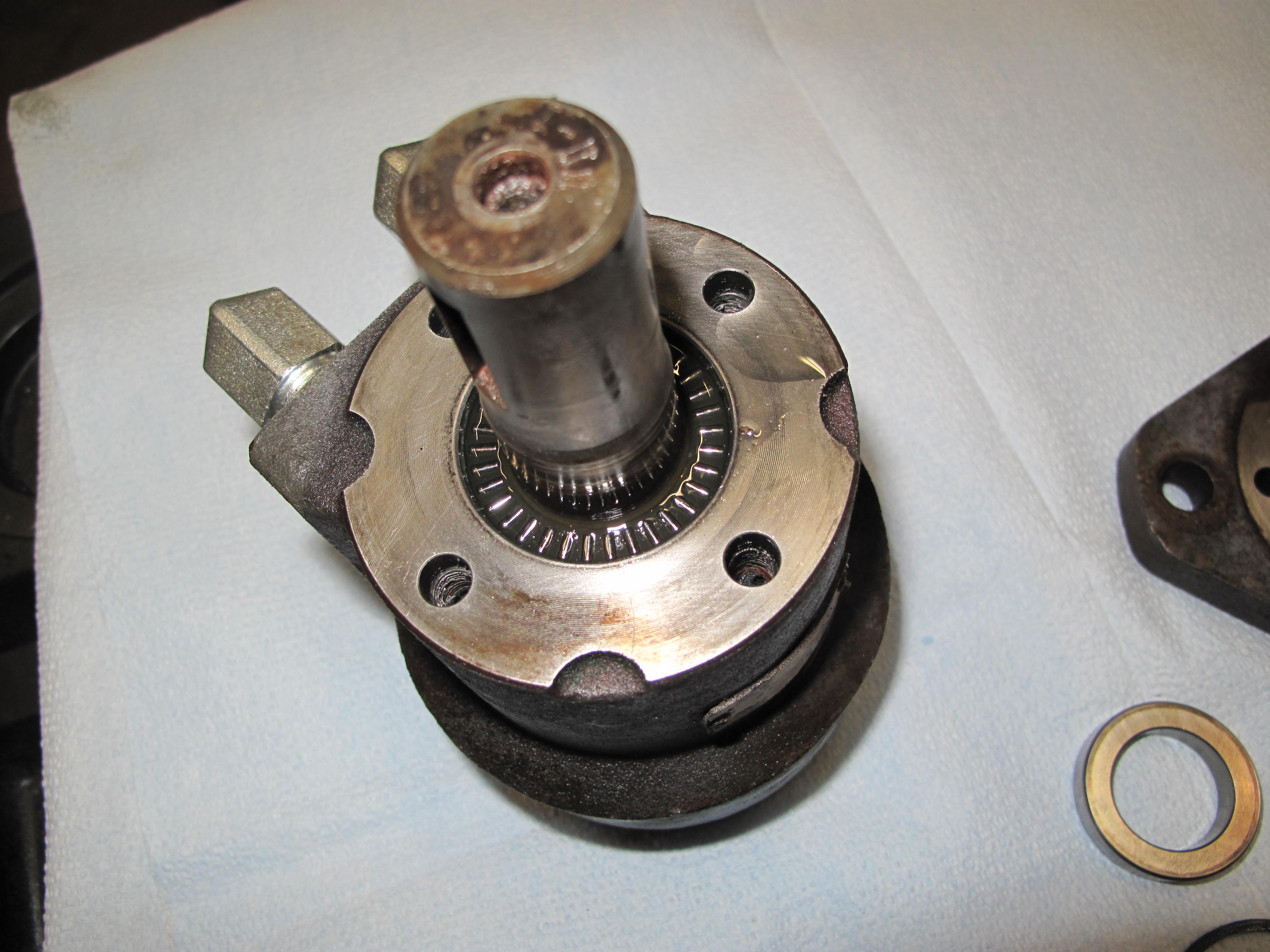

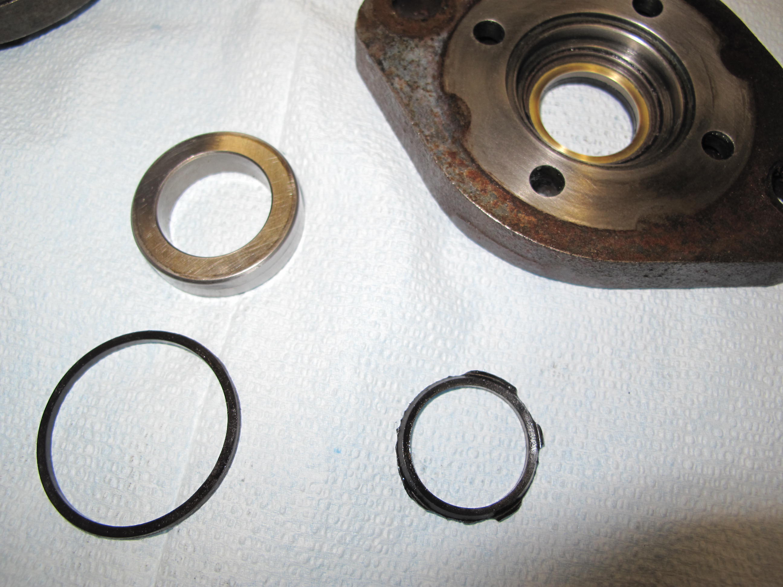

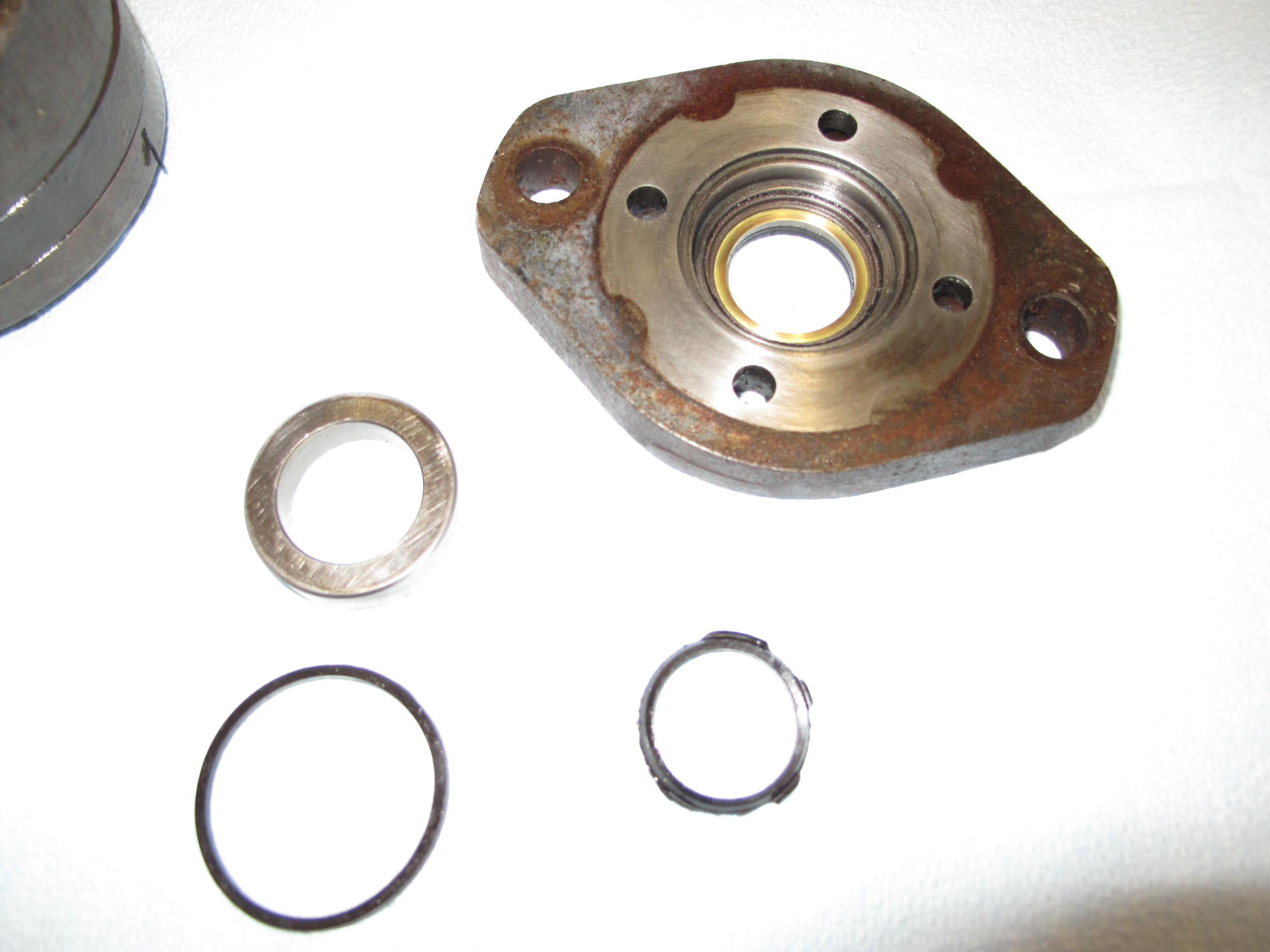

Hi
OK so here are the pictures of the inside one part of the seal was broken and you can see irregular edges rest look ok now I think that seal was a part of the metal ring (not a copper one that is a "wiper" I believe) where do I go from here??
   / Repering gear pump/motor #7
I would first browse through the motors in the Surplus Center on-line catalog and try to match your motor with the different brands they have. Do some research with the manufacturer customer service if you can find a match and try to narrow down exchanging pictures and description. SC does not sell repair parts, I think that is right. Dead end: take it to a hydraulic shop and have them look it over. They may have a universal seal replacement kit that works on many brands. This could be one of those catch 22 things; ie, the cost for parts and/or repair labor may well exceed the $300-400 cost of a new one from Surplus Center. My close by hyd shop even recommended SC rather than buying valves and cylinders from them. They cannot buy these items from their supplier for what SC sells them for.

   / Repering gear pump/motor #8
It looks like a Char-lynn but the seals don't look right.....it maybe a knock-off copy-cat from asia
What does that metal tag on the side say?
   / Repering gear pump/motor #9
I agree with WD, it looks like a S series Charlynn but the castings look too crude for Eaton. maybe a knock off like Young Powertech or Metaris. CJ
