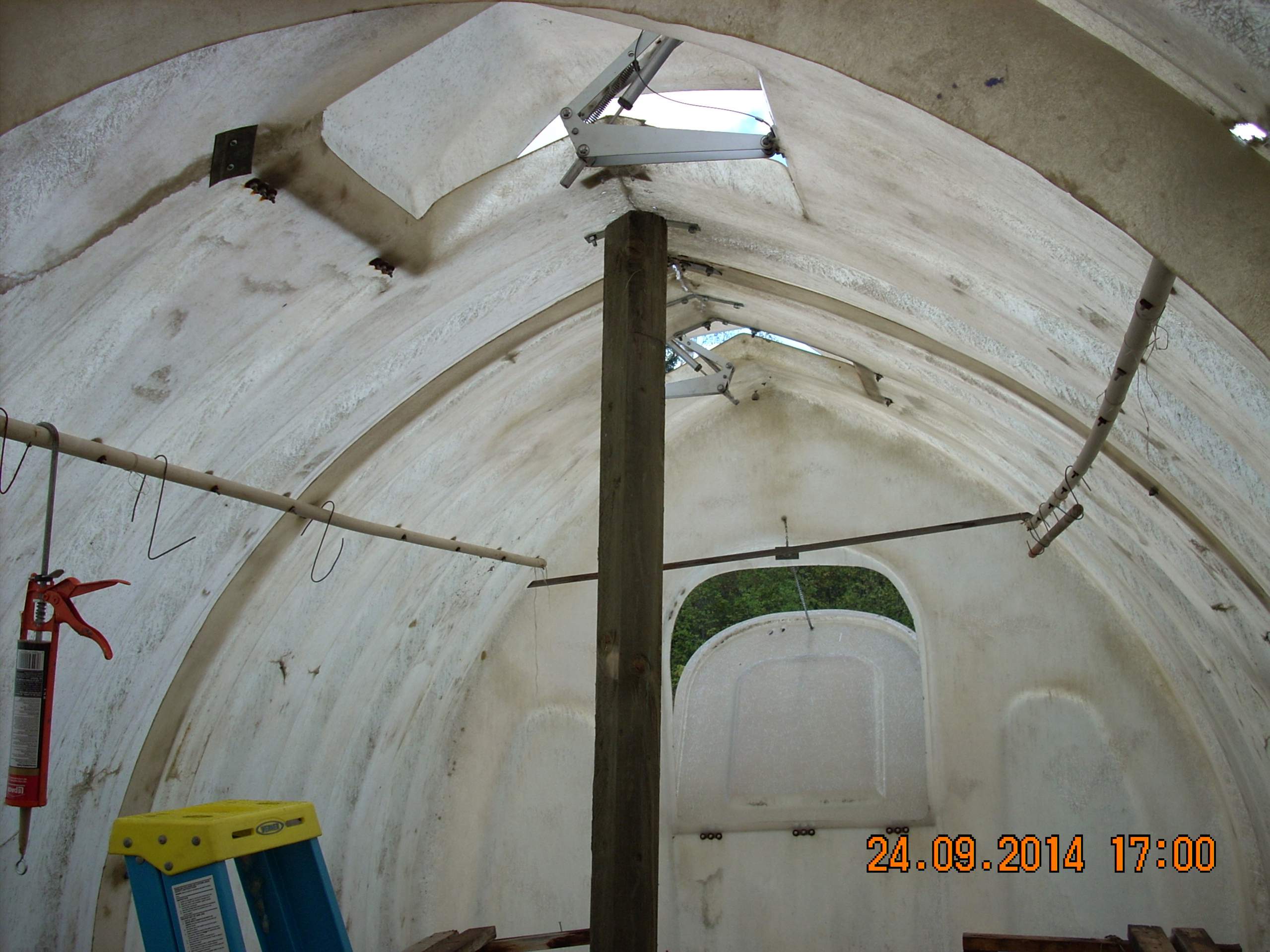

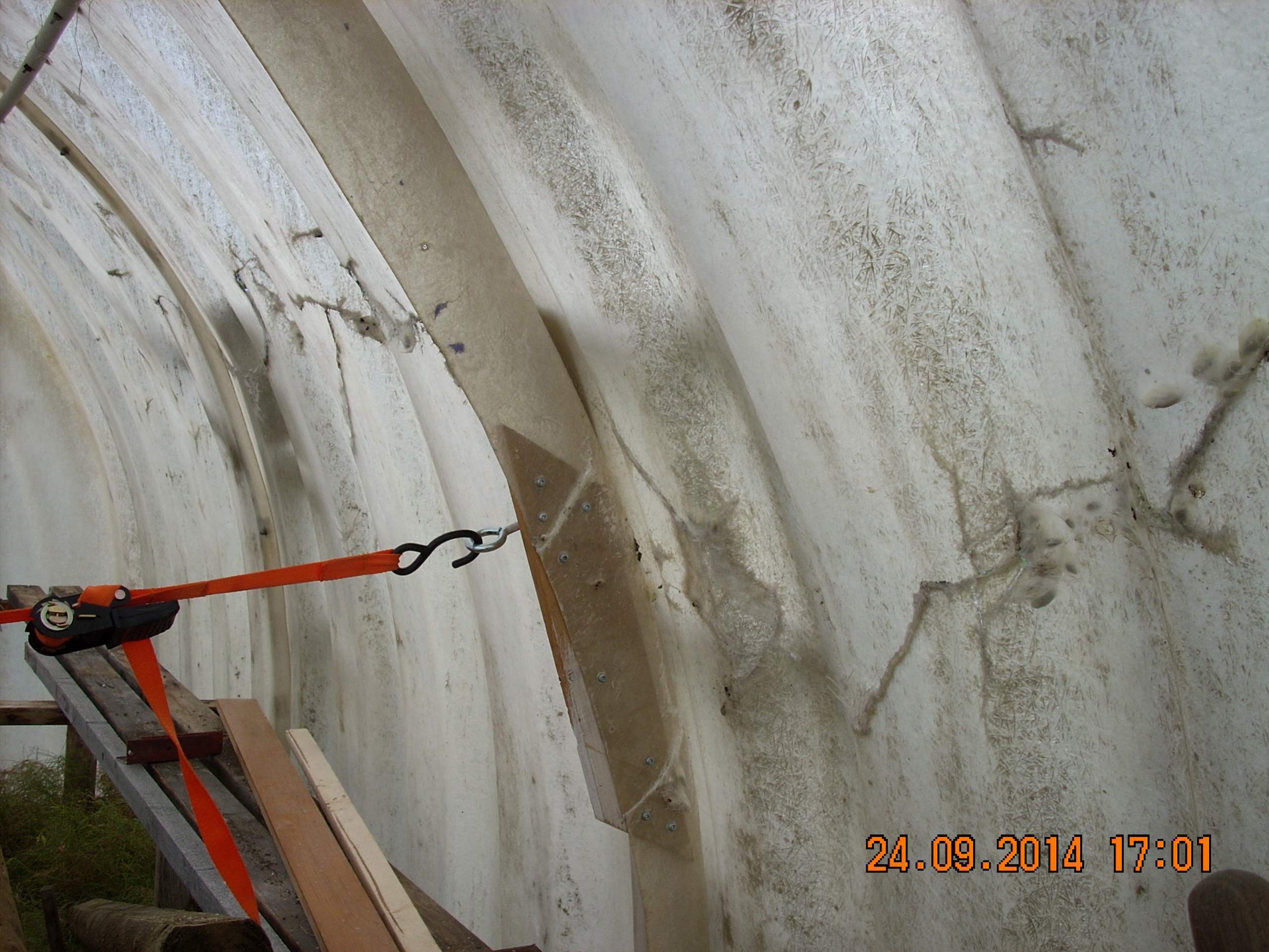

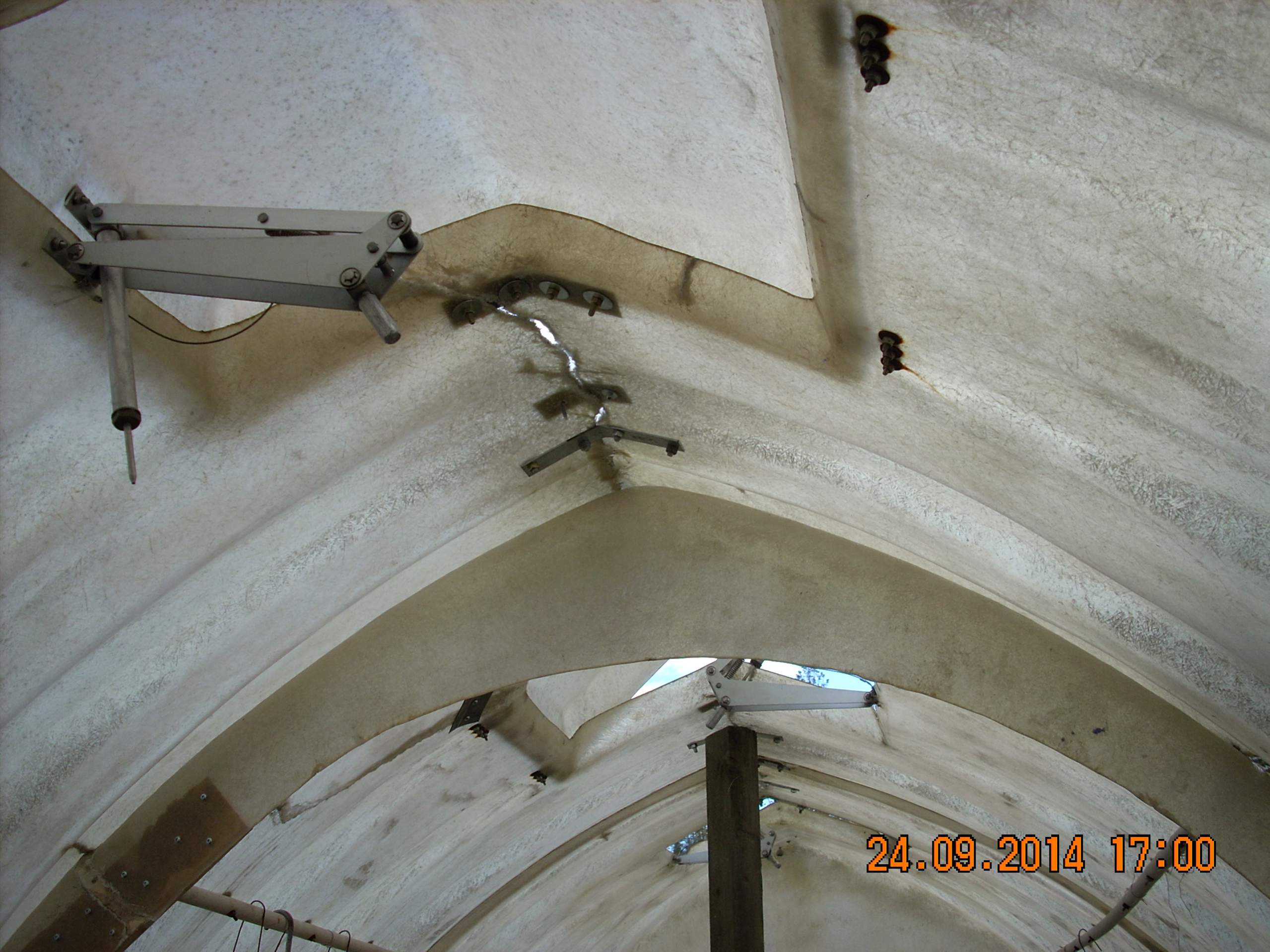

I am wondering if any of you have done much fibreglass repair work and would appreciate some advice.

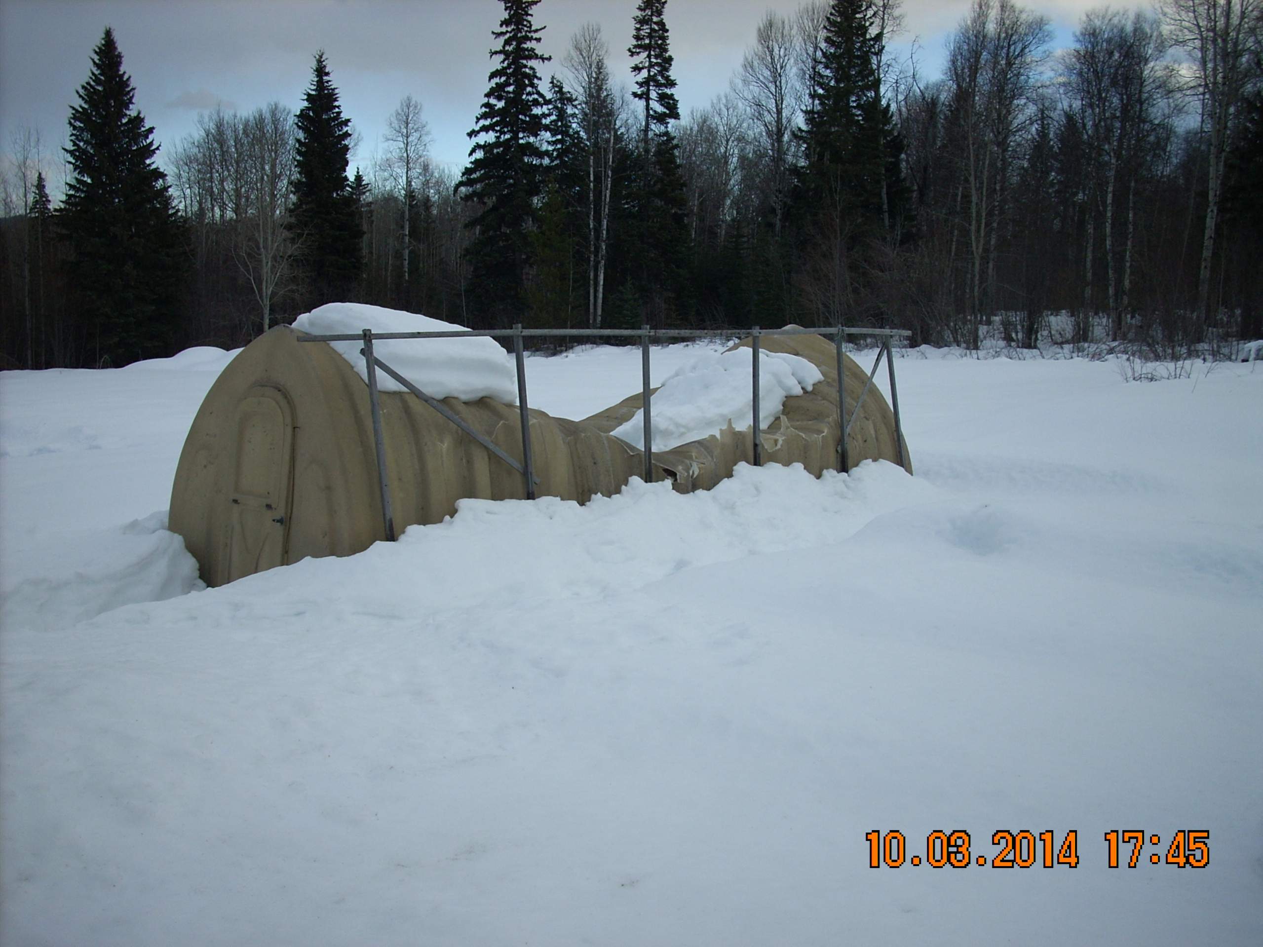

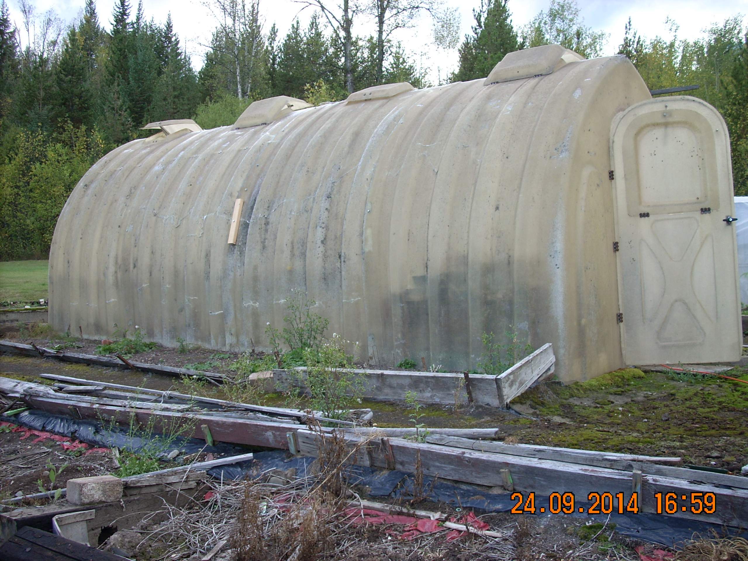

I have a fibreglass greenhouse that collapsed under a snow load last winter. The green house is around 25 yrs old and has suffered from UV and weathering, but it did survive that time without any supports etc.
I have managed to get the outside to close to where it was before collapsing and am wanting to repair the fibreglass for the coming winter. I have been told the epoxy resin will work in temperatures around 55F and extra catalyst/hardener would accelerate hardening time (offset the lower temps).
Providing I sand and clean with acetone, I am assured the repair will work fine and might take a little longer to cure.
I have attached some pictures so you can see what I am talking about regarding repairs needed. I believe the woven cloth cut to required sizes (strips) with the resin would do the job. I would appreciate any tips regarding the repairs to the fibreglass as I am a novice regarding fibreglass repair work. I believe ambient temperature and humidity play a major role - along with cleanliness and proper preparation. Once completed, the greenhouse will have "winter props" come winter time to prevent ay further collapsing.

The repair should be fine. If you can get the temp warmer it would be better. I prefer the mat type cloth versus the woven type, but either will do. Good luck.
   / Repairing Fibreglass Greenhouse #3
Fiberglass is pretty easy. The key is to be all prepared, because once you mix the resin you only have about 20 minutes before it hardens.
Most fiberglass uses polyester resin, not epoxy. It's also a good deal cheaper. It does have trouble catalyzing below about 60F, if you can put a halogen light on it for a little while that will help tremendously. If the resin is at room temperature when you start it will generate heat in the pot as it hardens, which helps too. With proper temperature it will harden in a few minutes. Without it will eventually harden, but will never be very strong.
You're right that sanding and cleaning the existing fiberglass will make it adhere. The other thing to worry about is that if fiberglass changes thickness too radically it creates a spot that will crack if flexed. So you want to feather the edges of the old material before patching, and feather the edges of the patch after it hardens.
The resin is really soupy and has no strength before it hardens, so you want to back a crack with masking tape so it can't move while it hardens. A hole you want to back with tape or cardboard.
   / Repairing Fibreglass Greenhouse #4
basically 2 types of fiberglass resin ... one for cars and one for marine ( will not de-laminate in water ) ... also has 3 different bases or mixes ... polyester based, vinyl ester based and epoxy ...
resin has no strength by itself (must use cloth to cover large ares )
old surface must be cleaned well , then sanded lightly to give some tooth to bond to , then wiped again to remove any remaining "oils" ( that may be present in the fiberglass )
fiber glass cures with heat ... low temps give a soft cure ... when the temp rises , the glass softens ( becomes more plastic ) and re-cures at the higher temp .. if the temp goes too high before it re-cures , the fiberglass can return to the fluid state and deform ( ask any composite plane builder about it happening on runways on hot days )
fiberglass is also affected by UV ... so most mfrs cover the final product with a UV paint or varnish ....
