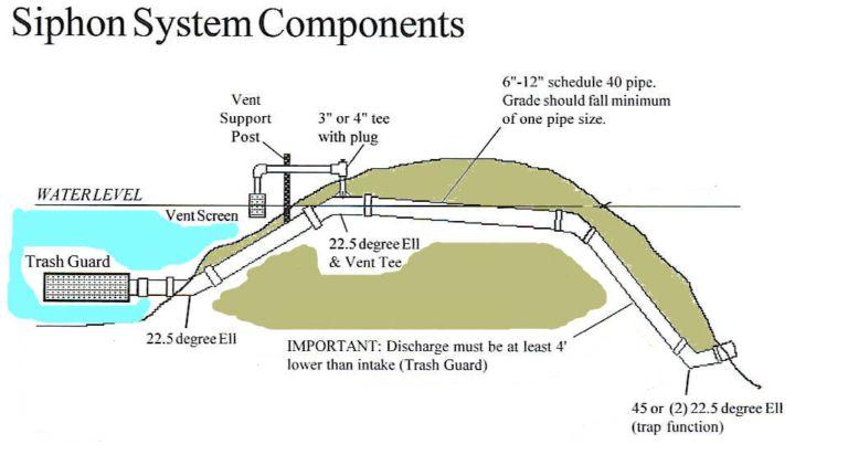

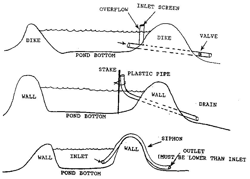

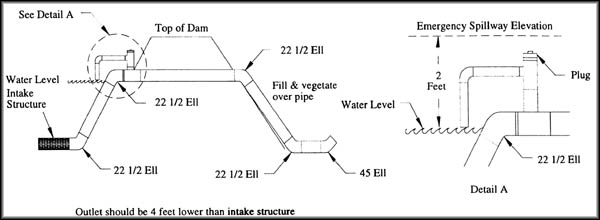

   / Repairing a pond dam. #8
What options do I have for keeping the water out while I repair it? This could be my biggest roadblock due to time and money restrictions.
Setup a temporary siphon:
