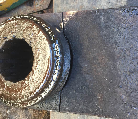

My first post here.

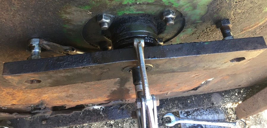

Just acquired a beat up 5' brush mower (503), good price, the gear box seems ok, but it needs a new bottom seal and stump jumper. I got as far in disassembly as the holder bar, and of course it was frozen in place. My baby puller did nothing, so added 2 bolt/nuts to push from backside.
I know it would put compressing stress on the shaft, but the bar was bent back 1/4" already so I cranked the 2 bolts until it straightened out. Heard a loud satisfying pop as the frozen in spine let go....well not quite, it was the 1" x 4" iron bar that snapped in two. I'm dumfounded, what did they make these out of anyway??
Best price I see on a replacement bar is well over $200, but it's still stuck in place. I am open to any ideas!

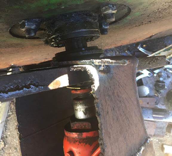

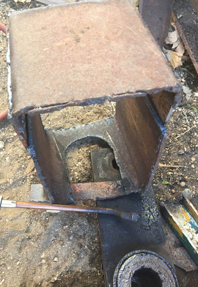

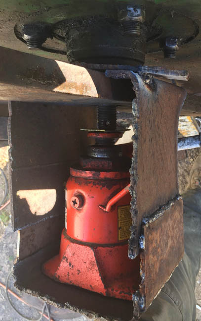

Success!
If I can load more pics you will see my 'better puller' - hydraulics to the rescue. Even with it it took full crank of the handle, 5 minutes with the rosebud, (while cooling the shaft with poured water) and...banging on the holder bar with a 4 lb hammer.

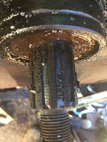

Now I can see that it is not only splined - it is a tapered spline, no wonder it was so awful tight. But now i see the weak spot in the bar - that the turned spline holder rally cuts into the strength of the bar, I see no way even a certified welder has enough bar there to weld safely.

Ingenious (and functional) puller jig!
