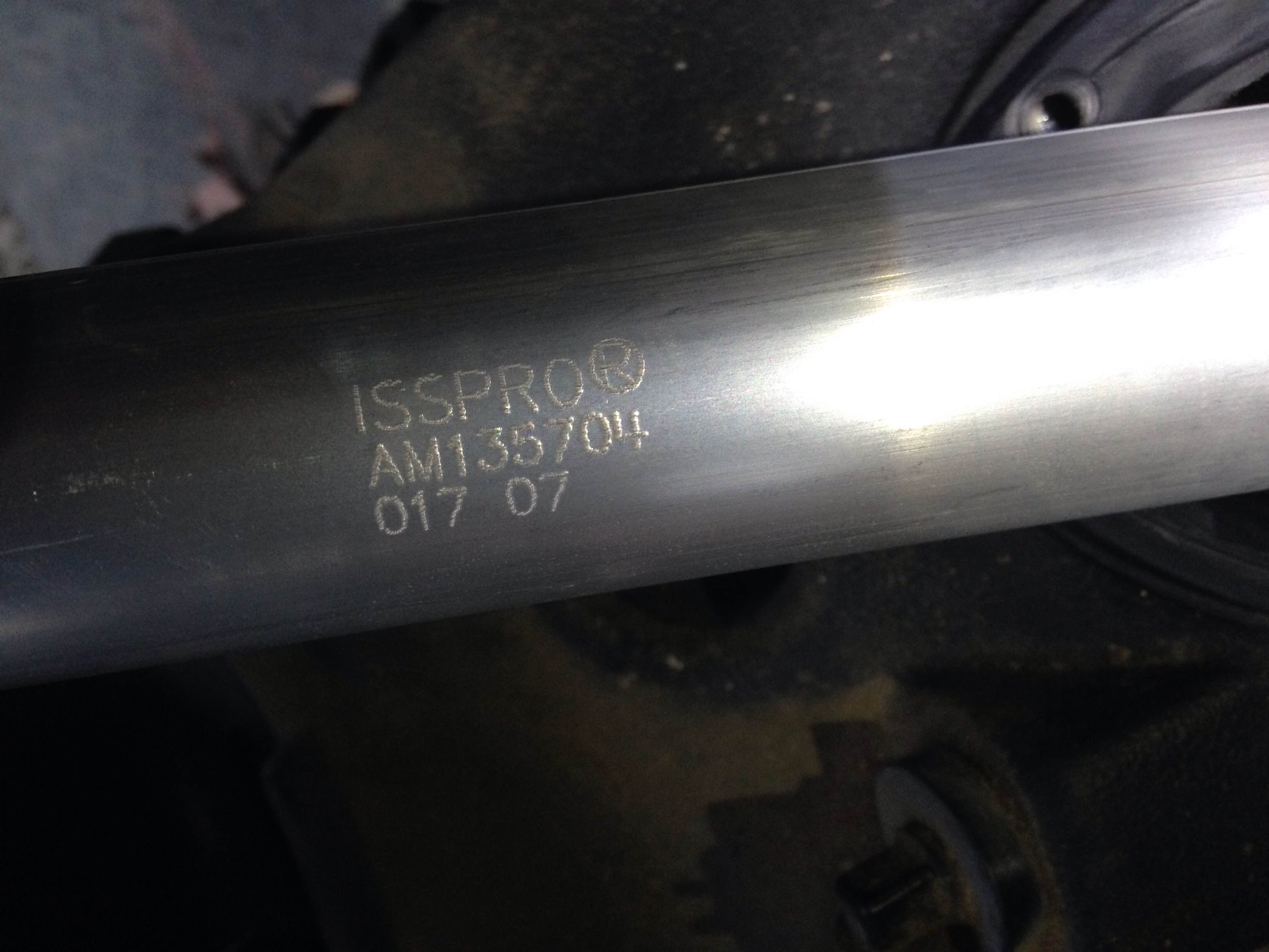

Next take the 2 screws off the bottom plate that holds the float inside. I removed my float, put it in a cup of gas, and it sunk immediately. Bingo! That was my problem. I also found that the mfg of the sender had their name and JD part # and date code etched right onto the body of the fuel sender, so I decided to look them up and give them a call. A step I hadn't seen anybody describe on the forums before.
My sender was manufacturered by ISSPRO (ISSPRO.com - Quality Gauges, Tachometers, Speedometers and more!). I called them, asked for tech support, and described my problem. They asked for the JD part number of my sender and the mfg date code (See in photo), and were able to mail me a replacement float and I opted for a new gasket as well. The float was $25 which seemed a little ridiculous to me, but at the end of the day the sender works fine otherwise so it still saved me about half the cost of a new sender. Gasket was $5, shipping was about $7.

Fuel Sender.JPG Fuel sender where mfg is identified.

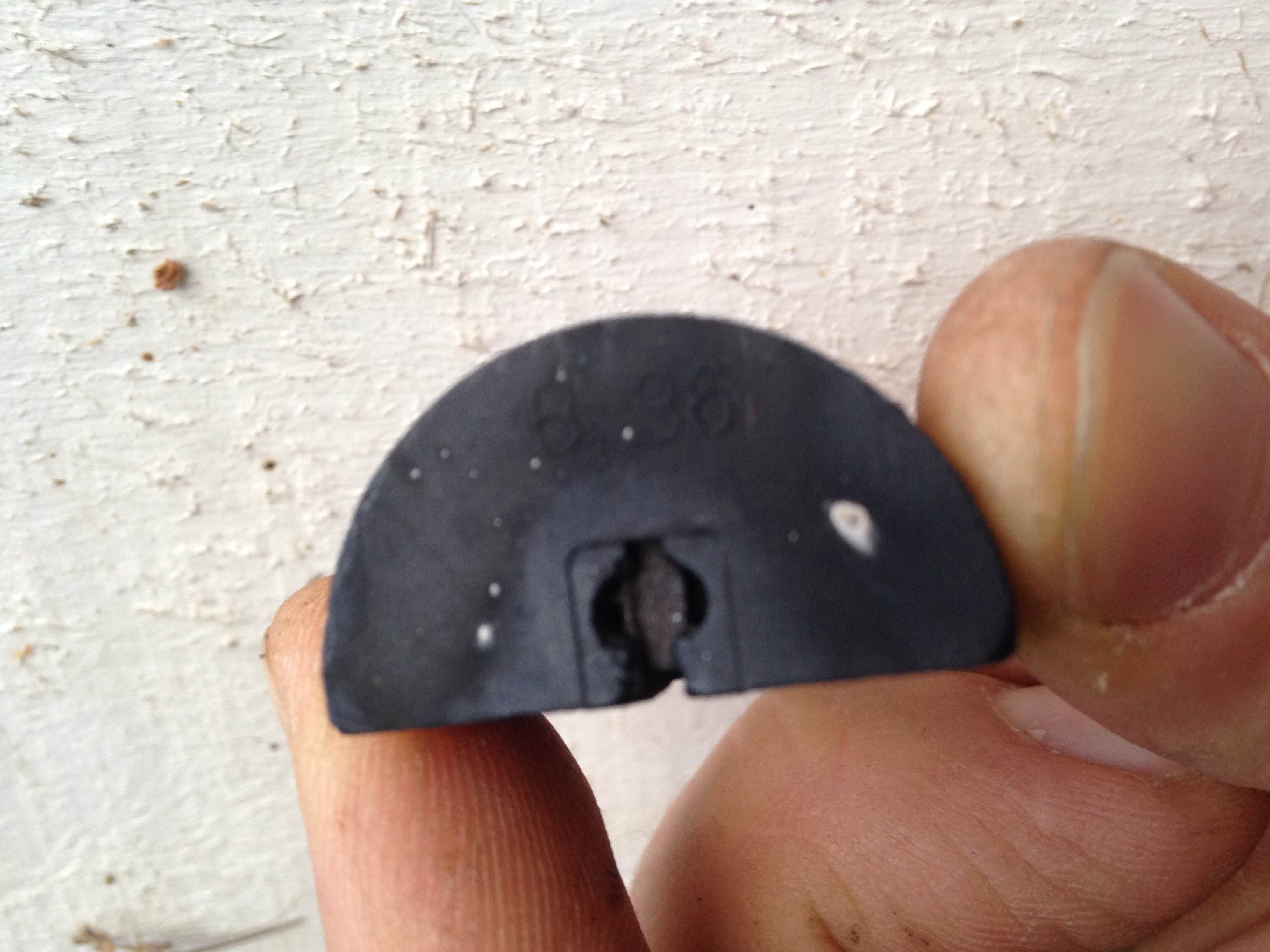

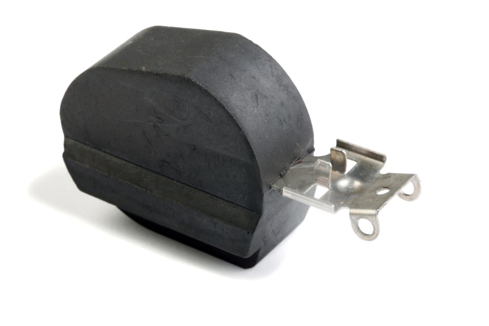

Float.JPG This is what the float looks like. It has a magnet on the top and bottom within that notched section.

The float is not hollow. It has a very dense interior but isn't a solid piece of plastic. The exterior is still shiny and smooth after all these years but core is porous. So fuel was absorbed and float just sunk!

Many carburetor floats have been made out of a similar material (especially in the automotive side of things). They're made out of a closed cell foam (somewhat similar to the 'crack seal' expanding foam in a can). A trade name for the foam floats is Nitrophyl. They're then coated with some sort of sealer.....that eventually leaks. When that happens, the float takes on fuel and becomes heavier (and sinks).
