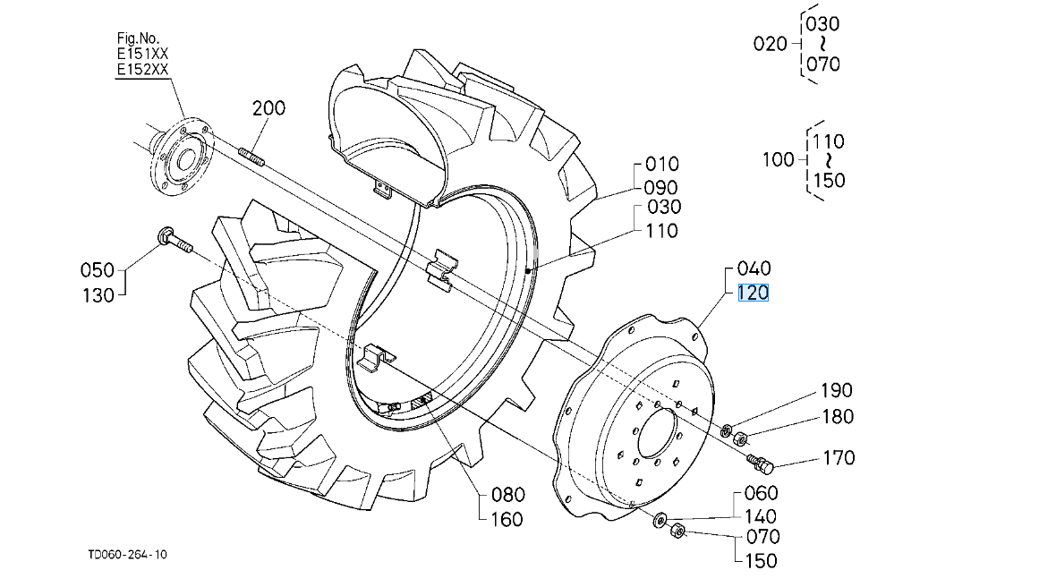

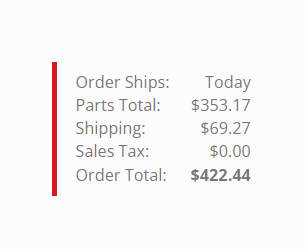

The lug nuts and bolts on one of my rear wheels got loose and by the time I noticed, the holes in the disk were wallowed out
Don't feel paying for a new disk
Ideas on how to repair it appreciated

Repair info is what I'm after
Looking to hear from someone that's done it

So you are referring to the inner discs on your tractor rim? Heck, I thought you had wallowed out the rim on your pull behind disc harrow. I have no idea how heavy your tractor is but that's a risky repair in my opinion.
   / Repair of wallowed out rear wheel disk bolt holes #9
Go to a local machine shop. They can build up the holes with TIG weld and then re-drill the bolt hole pattern on a mill.
That's what I was thinking
Hoping to do it myself with my drill press
