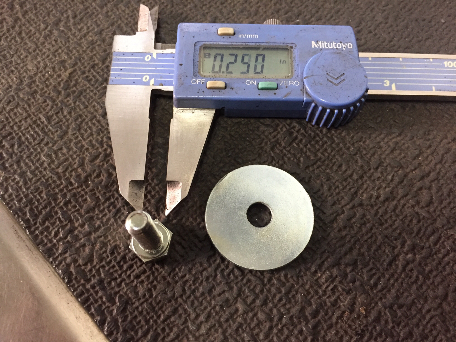

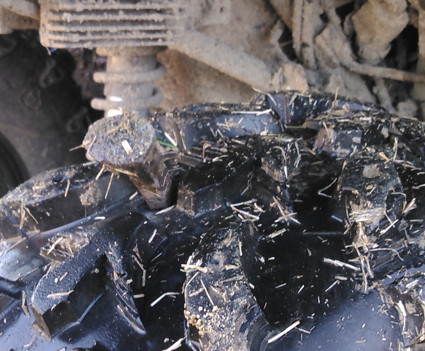

Yesterday I managed to get a railroad spike embedded in an almost new Swamp-Lite on my Rancher. I thought the spike would look good in the nail jar at the local tire shop, so I took it to them. They said they had plenty of experience with ATV tires with big holes, and no method they possessed would fix that tire for long. Faced with shelling out $125 for a new one, I am looking for alternatives.
My hare-brained idea is to dismount the tire, drill the hole so I have 1/4 inch of clear hole, and "bolt" the hole closed using a 1/4-20 carriage bolt, a washer on both the inside and outside, a nut (loctited), and RTV to fill any gaps and pressed between the washers. I would top it off with some slime in the tire. I doubt the bolt head will contact the ground much since the tread is almost new and very deep.

I, on the other hand, would have no concern in regards to a blowout. You aren't running extreme pressure so that's not an issue.
I actually think this idea will work. As to the washers, I think you need some rather large flats. Not just your average 1/4" flat. Go to your neighborhood parts store for starters. Ask for body/fender washers. If they just stare at you, go to your local body shop and talk to them. Body/fender washers are very large. You can get a 1/4" centerhole washer that's 1.5" or larger outside diameter. They'll stay put and fix your problem. Seal them well with any type of flexible silicone or "wheel sealer" which is an item used in tire shops. I keep a can of it around for 4 wheeling tire issues.

What's wrong with the inner tube idea? Maybe that and a patch on the inside of the tire.
I got a nasty tear in the sidewall of my front JD 6200 Tire. The tire shop didn't want to fix it. I insisted, they patched it and it has been good for over fifteen years.
I just don't like the bolt idea as there is no give, and the tire does flex. It's like a wave, as it rotates.
What kills me, is that if you tried to get that spike into a tire, while driving, without making up special jigs, you probably couldn't do it.

I think a 1/4" bolt will be too small after looking at the size of the railroad spike. Use a tube or buy a new tire. Installing a bolt won't flex when the tire does.
