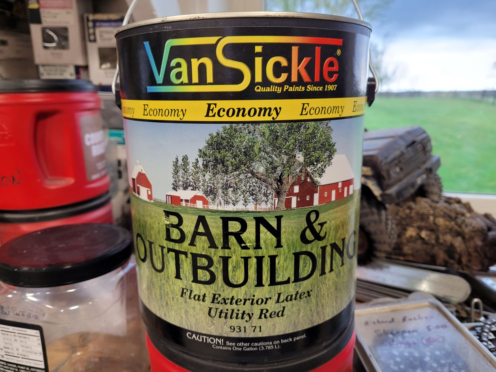

10 years ago I painted over galvanized tin. It has held up great. I was actually surprised how well it's stayed.
I'm in the process of sheeting over old lap siding with used steel panels from an old pole barn I tore down. The panels are probably 25 years old. I'll use the same paint I did on the galvanized tin.
All I did for prep was power wash the tin. That's all I'll do on the panels.
Here's the paint I used and will use again.

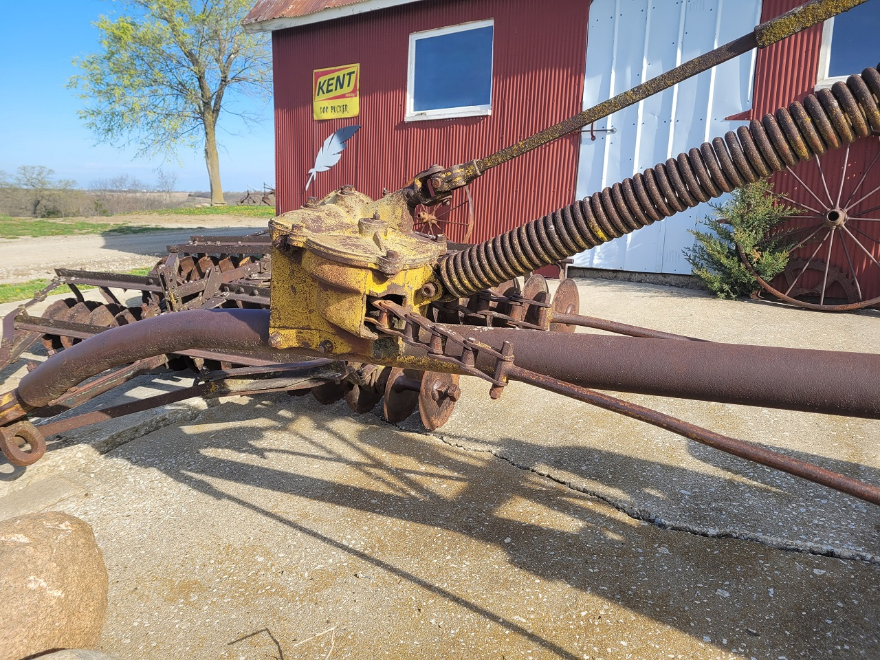

here's a pic of the barn tin I painted over. This pic was taken 7 or 8 years after I painted it.
Thanks, that’s the kind of info I’m looking for.
I’ll check to see if that paint is available near me.
