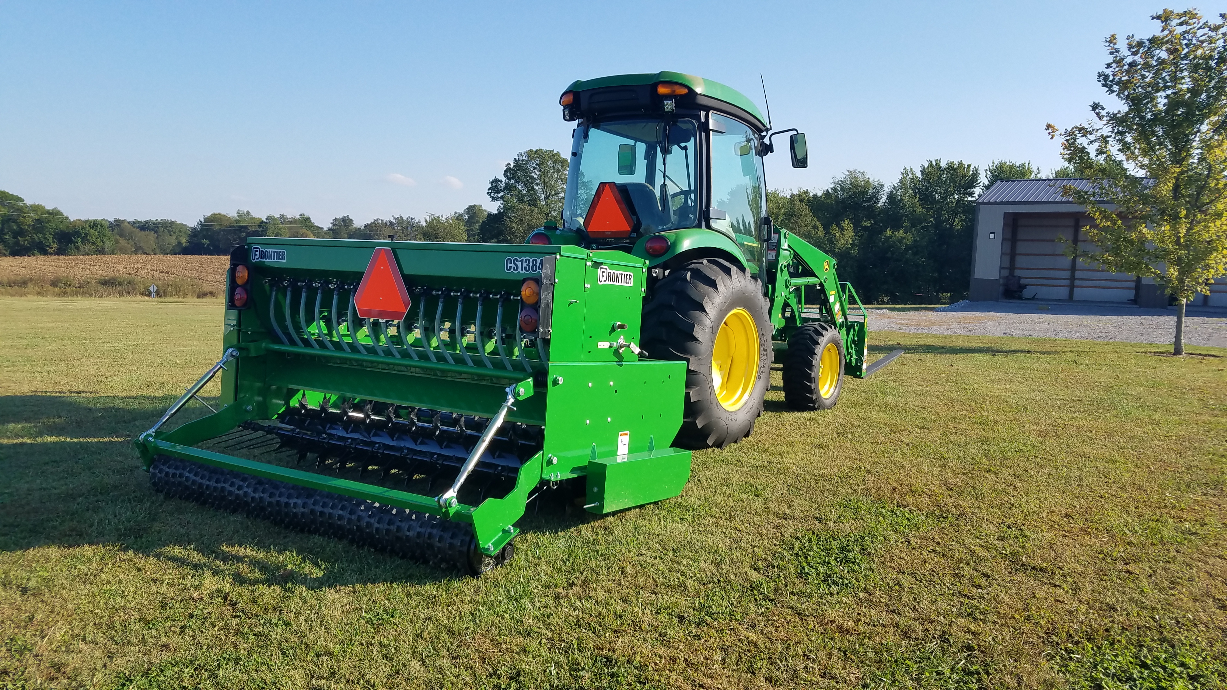

I've got a power rake and a conservation drill with a cultipacker that I think would be the most useful implements for this project.

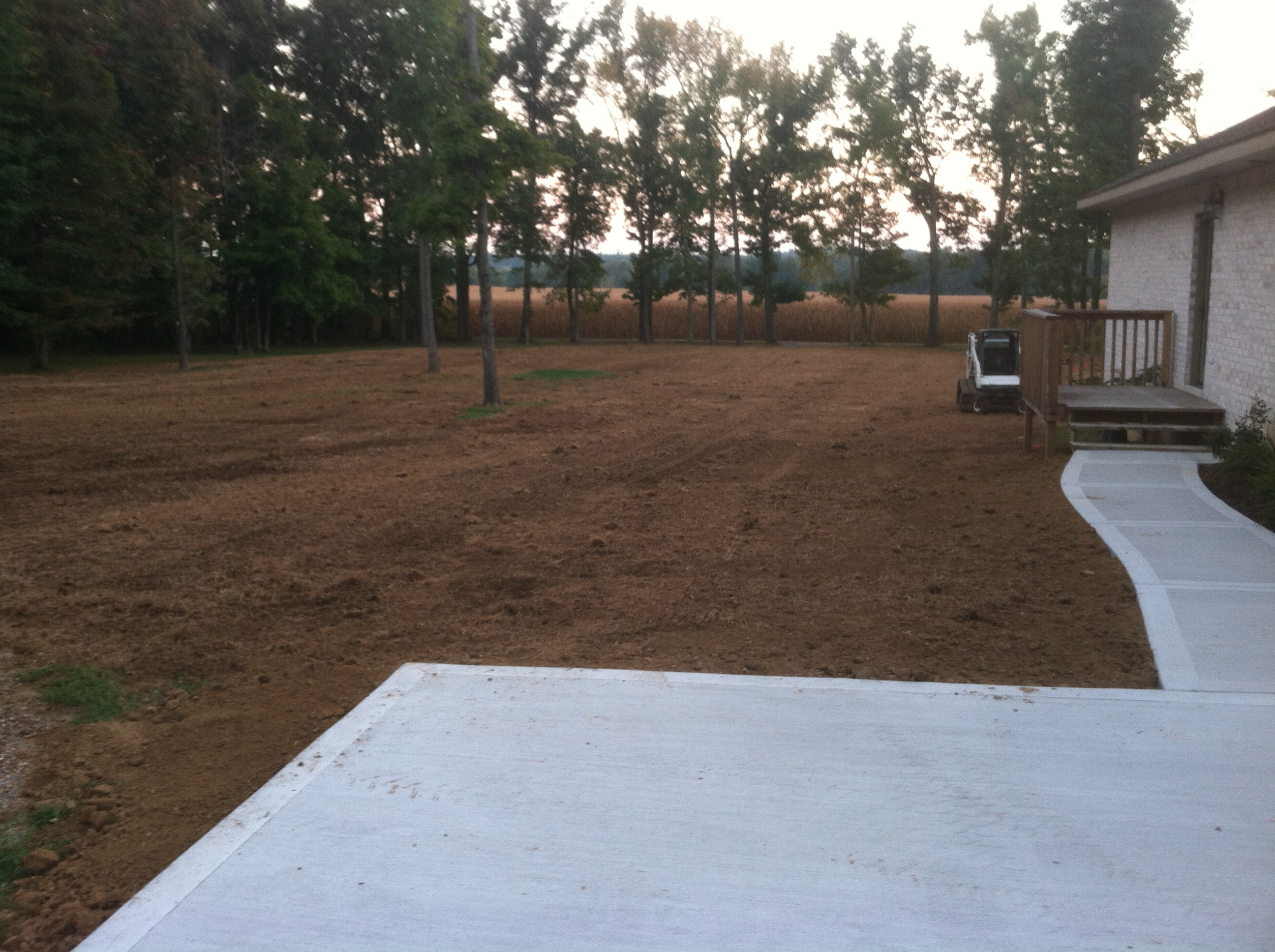

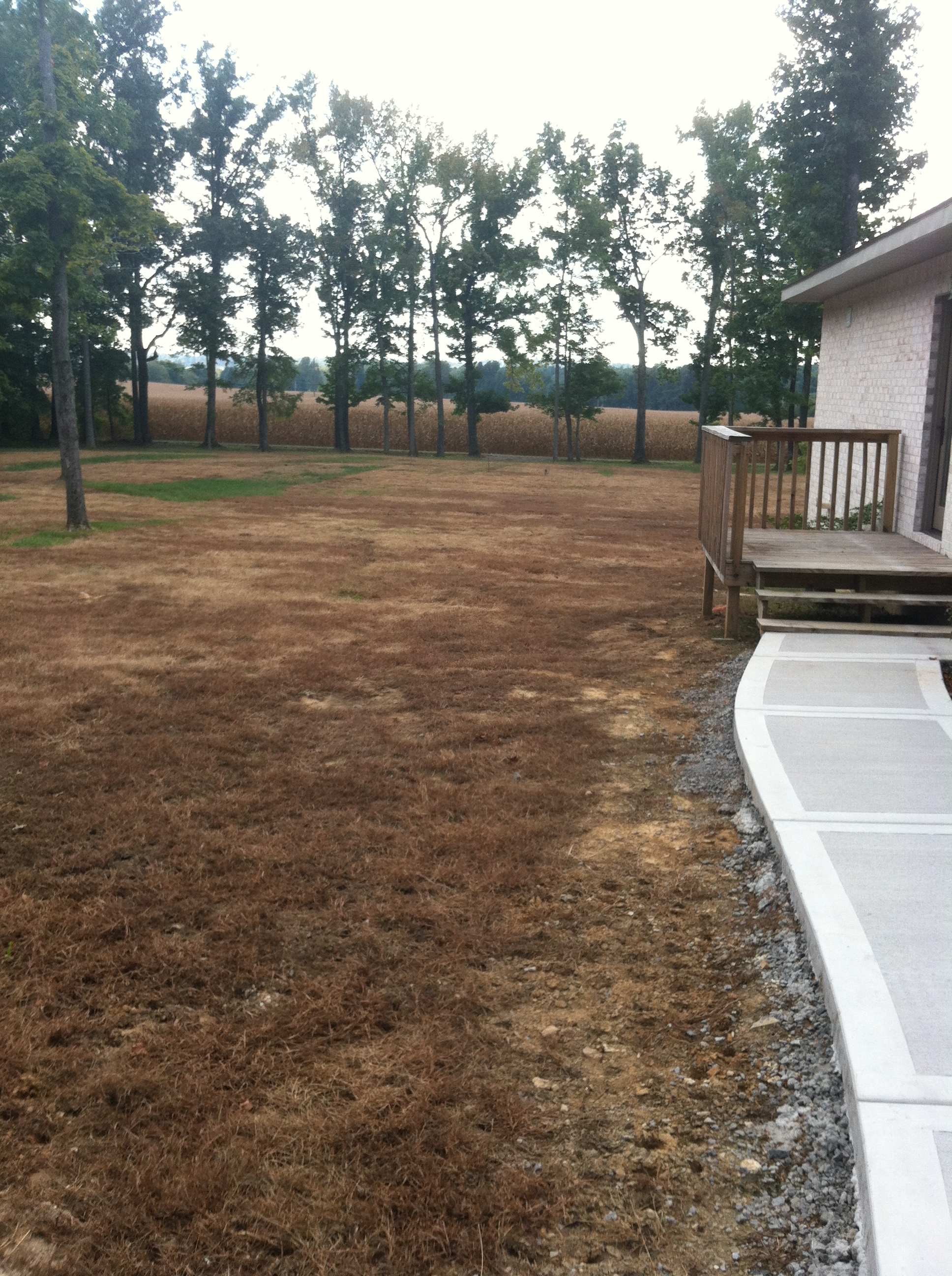

According to a fella who was helping me mow my lawn when I first moved here in 2013, mine was the roughest lawn he mowed out of 50 yards. I had a power rake from my bobcat T190. I killed all vegetation with Roundup and a 24D mix. I let it set for about 10 days for roundup to do its job and kill the roots as well as the top. I power raked several times. I then broadcast my seed and fertilizer and had (and still have) the prettiest, smoothest lawn in the neighborhood.

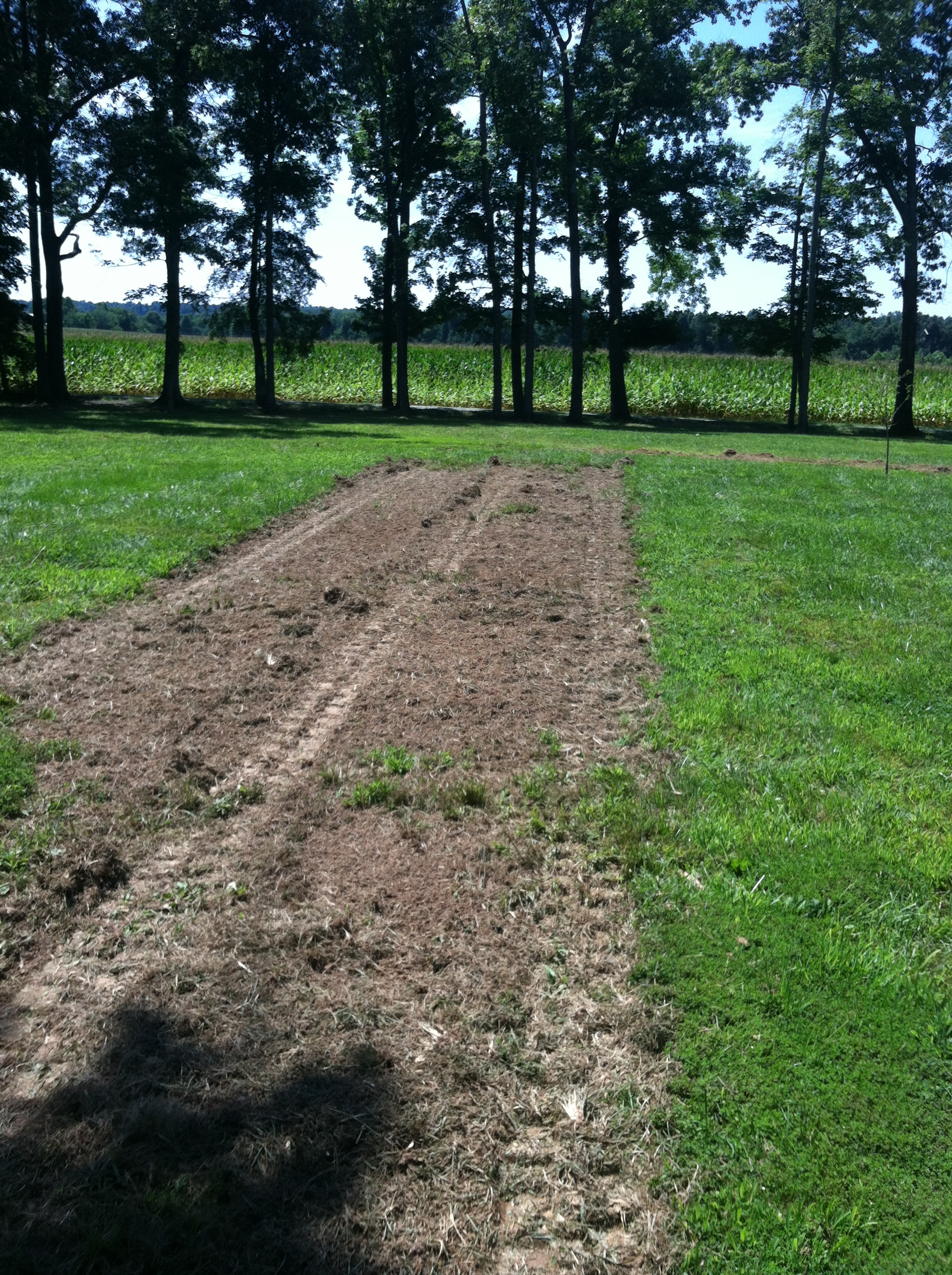

I have attached some picture of the process. You can see one strip that I did in an existing thick stand of crabgrass just to try the power rake out. It did a decent job, but next you will see where I killed out all the vegetation. It is not necessary for you to drill the seed. You can broadcast it. Packing it after you broadcast would be good but a nice hard rain can do the same.

So if you notice in a couple of the pictures of the same area...there are 3 pictures of the sidewalk.....one was just dead vegetation. And you can see how the dirt is below the side walk. The second picture has very smooth dirt up as high as the sidewalk. That 1 dumbstruck load of dirt I had hauled in to raise the level up to my new concrete. Third is an erosion blanket butting up next to the sidewalk. I only put an erosion blanket on that spot because I had just purchased that dirt and I had turned it into powder and did not want little gullies and what not up next to my sidewalk. I did not blanket or straw the rest of the back yard....nor did I irrigate it....if you seed in the fall Mother Nature will do her thing for ya and by April of the following year you will have to mow twice per week. Sometimes you get lucky and Mother Nature will cooperate and give you a nice lawn in the fall, but sometimes we have a dry fall.....and if we do, don't fret...that seed will lay there until next spring...and by April you will be the envy of your neighbors.

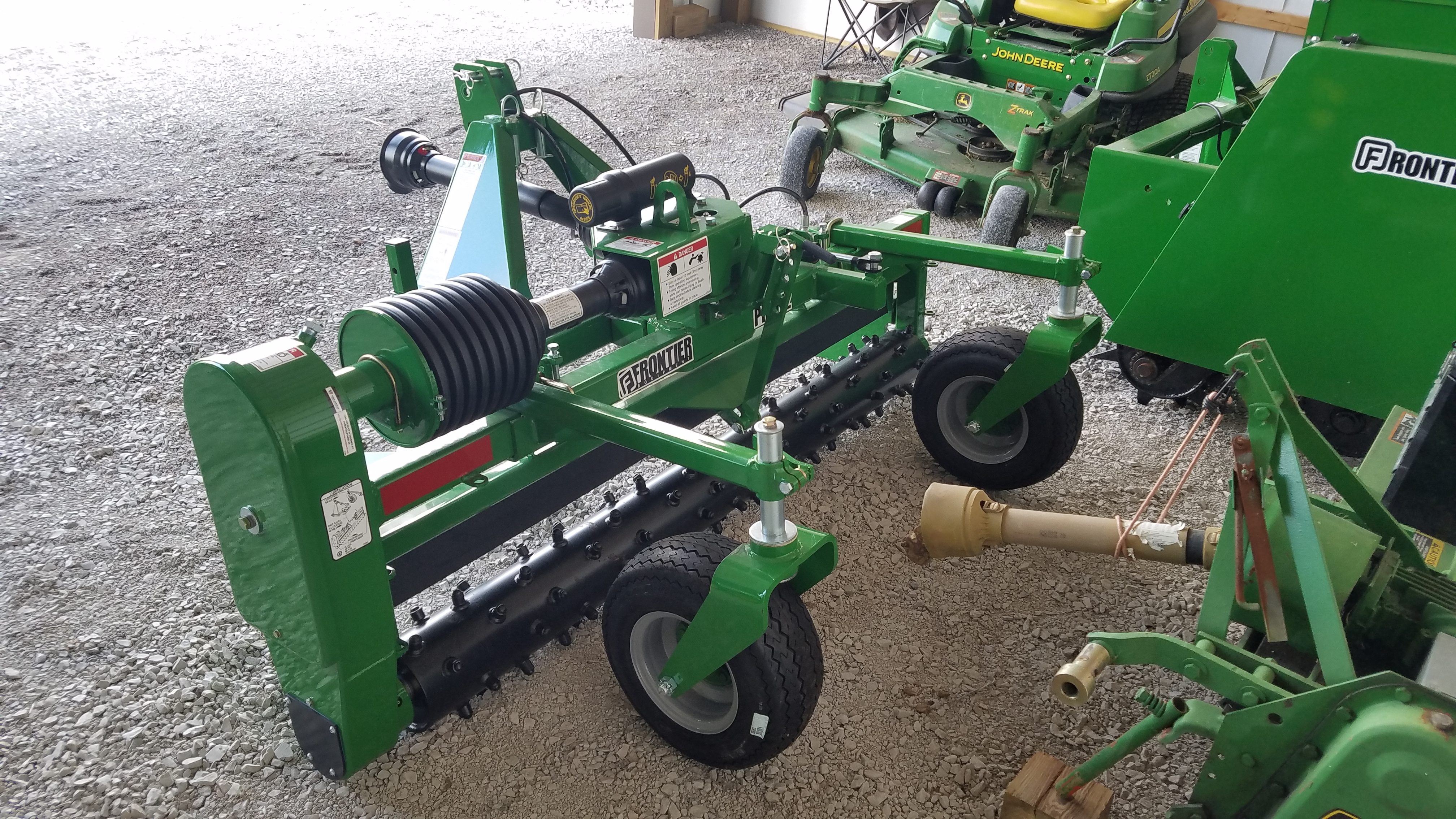

I got it towards the end of last year from Hutson in Paducah, but have yet to use it or even connect it to the tractor.
It is a Frontier PR1172, which is 72" wide. PR11 Power Rakes | Landscape Equipment | John Deere US
It does have hydraulics so you can adjust the angle of the machine left/right to change direction of throw, but not change the rotation direction of the drum, as far as I know.

Really nice....now one thing I did not notice is that it does not appear to have wings on it unless they are behind the drum in the picture. If you look at my Bobcat Brand Soil Conditioner you will see small wings that help to move the dirt from one place to another similar to a box blade. I have never operated one of these on a tractor so I am looking forward to your results.
